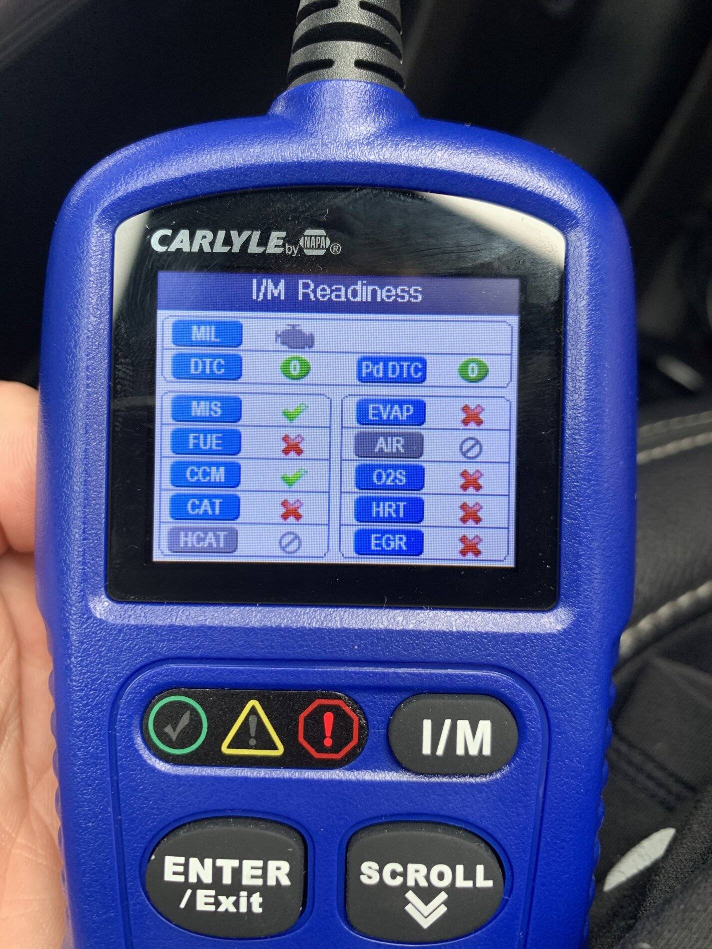

Just got a 2017 GT and have failed inspection (once) and the readiness test (a few times) over the past couple days. It was in transit on a truck for ~2 weeks and I have put ~150 miles on it since I picked it up.
Failing on Cats, O2S, HRT
Mods include C&L CAI, MBRP Catted LTH, GT350 intake manifold/throttle body, and a custom tune. Mechanic has told me to just keep driving it. Has anyone else gone through this? Could the monitors have reset after just 2 weeks? How many miles should I expect it to take to clear them? Could any of the mods be the root cause of the fails? Any help would be greatly appreciated.

Yeesh. That’s rough. If they jumped the battery at all, it would reset the readiness monitors to not ready. Is it setting a check engine light? Do you know which monitors are reporting not ready? You need some more info to identify and remedy the issue. Google OBD drive cycle and you can try following the recommended reset drive cycle. But I’d bet a dollar it’s the catted headers causing the issue.

No check engine light, monitors not ready are cats, O2S, HRT
Hoping it’s not the headers.. that’d be a pain

The custom tune probably wont set those to ready. I would lean that way especially if a CEL never appears.
If you got it tuned, you can ask the tuner to turn those back on. But there is no guarantee that you wont throw a CEL since it seems its luck of the draw when it comes to aftermarket header cats.

The tune could certainly be the culprit. Assuming monitors were set to “No error reported” (P0420/0430) etc. for the LTH could cause the OBD monitors to loop testing into an endless “Not Ready” status. Are defoulers installed on the downstream o2s?

load the stock tune. scan for codes and post them up (no need to start it) . That'll tell us right away whether the custom tune had anything shut off.

It would report a P1000 system not ready code if it was a drive cycle issue.
As mentioned, chances are it’s the tune. Previous owner must not have had to deal with emissions.
