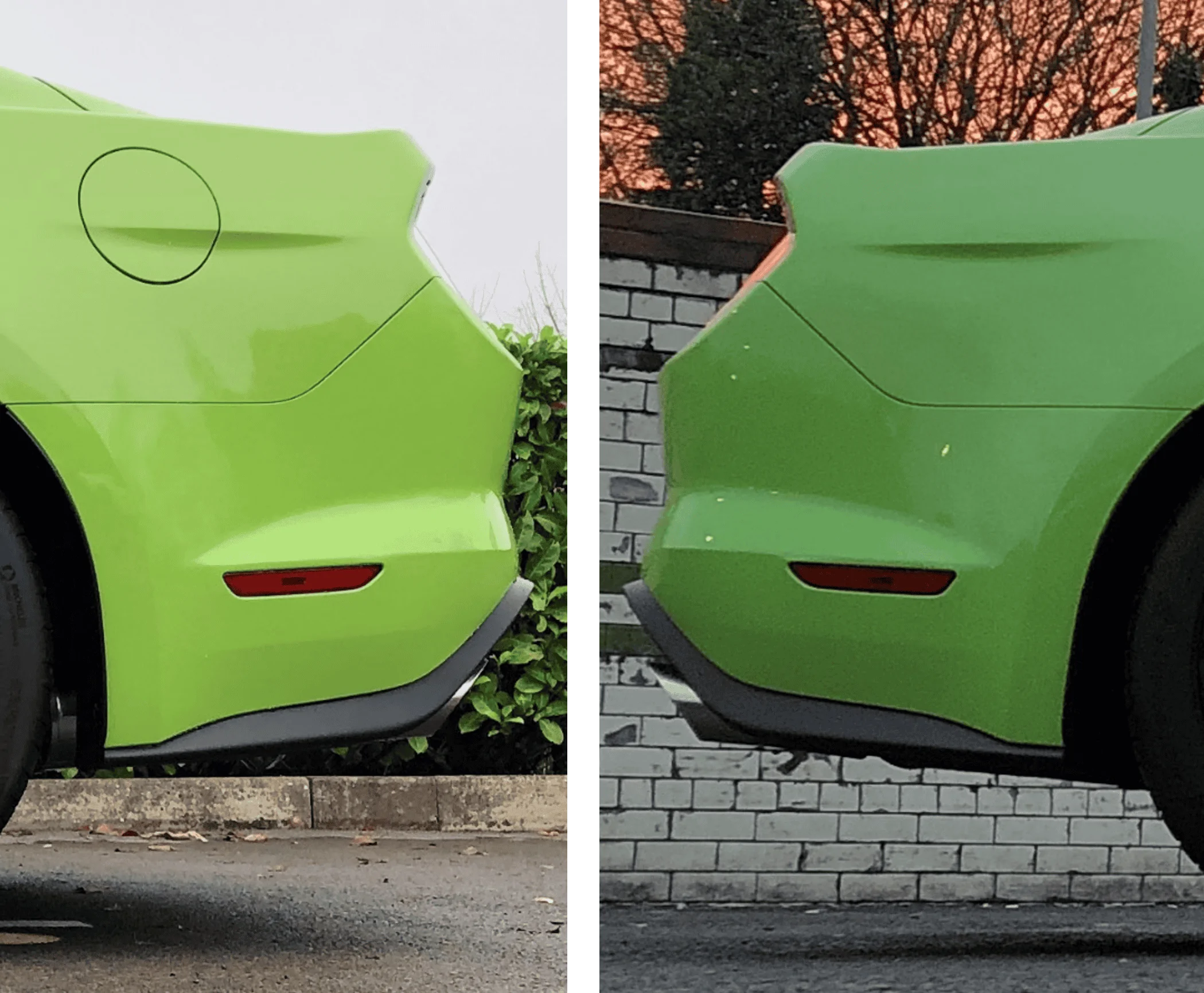

I managed to find two photos taken from the same angle as a comparison of pre and post mod :

Yeah I prefer the left picture / shorter pipe - which is lucky as I can't go back now ... :giggle:
I've never particularly liked long / protruding tail trims, but I appreciate we are all different :like:
The GT's don't exactly have the best looking tale pipes for showing off anyway, so a good fit flowing with the lines of the diffuser at least does them a few favours !
