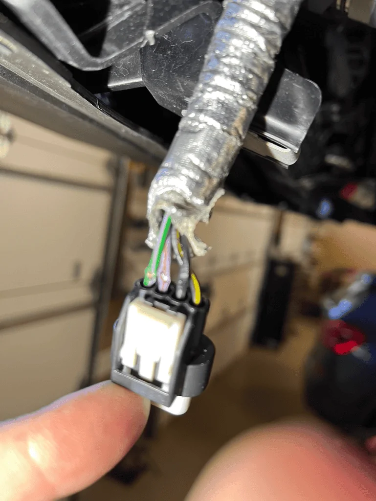

Found this, this weekend after same warning you are seeing. Passenger side.
Mine weren't exposed, but mashed a bit. They're currently working fine. If you're aren't shorting to anything they likely still work. I saw Bill from CJ Pony parts do an install with wires that looked just like that and it those still worked Check at about 5:52. Mine are for some reason, currently working properly. I don't think they're fixed yet...

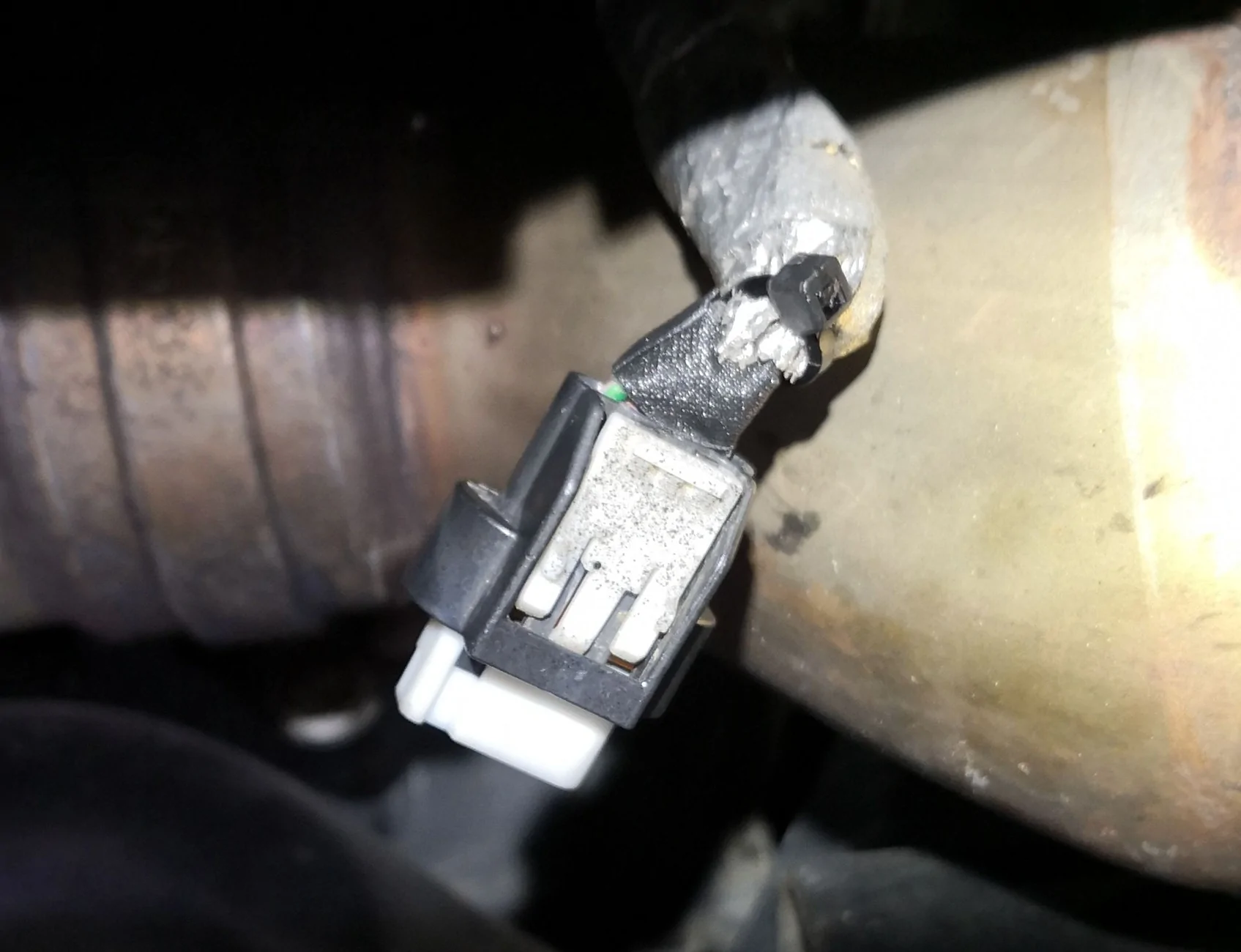

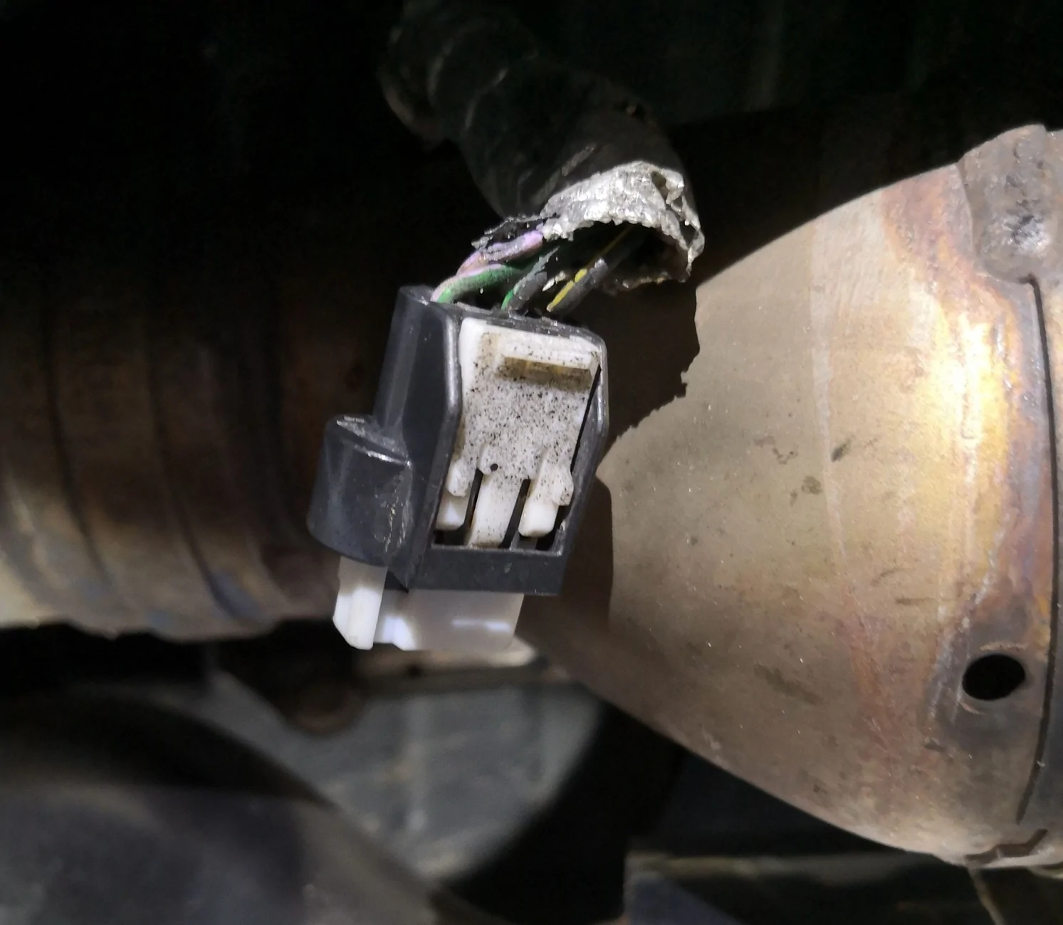

I was fixing the same problem today.
In my case I only get one wire insulation shaved (magenta one).
I did not have silicone, so I just taped green and magenta cables around and then taped all cables around to cover the exposed parts. Then zip tied them just above the tape, to prevent the tape from sliding off.

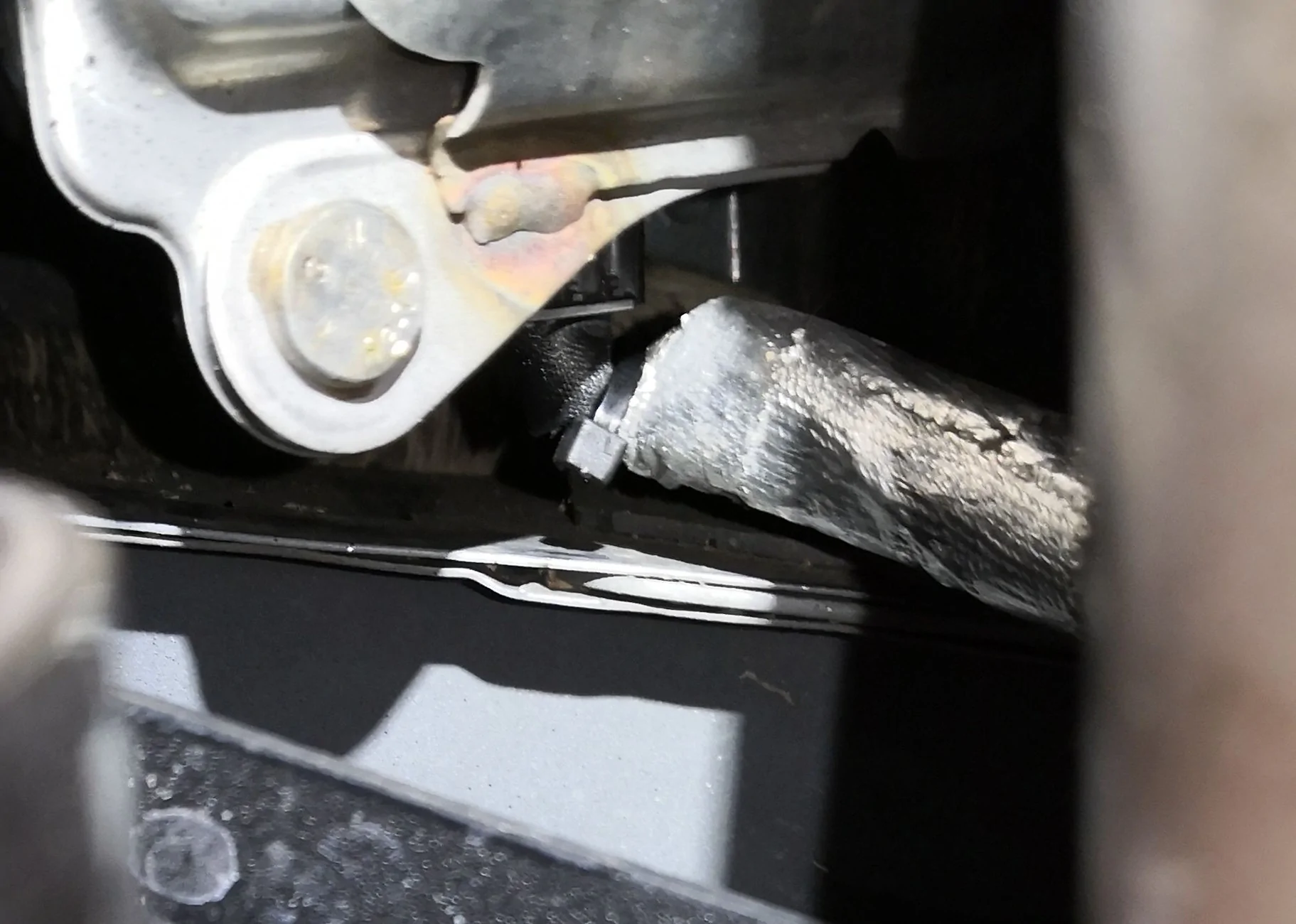

I am however not clear about what caused the wear:
  1. It was just one cable in this case which was affected and kind of sideways.
  2. When I attached a connector to the valve actuator there is a visible clearance between the harness and the frame (guessed at 8 mm, or 5/16")
It looks like the harness shielding would brush the frame sooner than the cable at the the connector head. In fact I have no idea what could have cut through the insulation in this setup.
Was it the connector itself? There does not seem anything close enough to do the harm... 🤔
Another hypothesis is that the exhaust pipes did get heated up (and extended) to the point the cables touched the frame. The "exhaust mode unavailable" error appeared after 2 hours of tracking.

The exhaust definitely expands when hot and your cold clearance diminishes.
What caused mine was a didn’t trim enough of my exhaust when putting on my x-pipe. To fix I trimmed about 3/8” more off of the stock exhaust, I depinned the harness, cleaned up the mangled wires, double heat shrinked the wires individually, the reassembled. Mine were much worse than yours.
You running an aftermarket mid pipe? You might want to trim where you cut from again or at a bare minimum move the exhaust as far forward as possible otherwise you will face this issue again.

I have a stock exhaust. What might have happened is, I had some Steeda parts mounted by someone else, including the diff. bushings. It is possible that the guy when reassembling the pipes did not push them together enough and left a smaller clearance at the end.
I hope it might be easy to check, though I am not sure how hard it could be to slide the pipes in (I assume he might have had a reason).
I have read the TSB posted above, and checked the pipe seating. The exhaust clamps are not locked, but the converters seems to be as tight as it gets, while clamps look rather short. For what concerns the muffler connection, I am not sure I have any "ridge" on the pipe, looked smooth more like GT500 pic (in the TSB). Whether they are inserted for proper length I have no idea.
I guess I will have to look into it again. Unfortunately I can only do it in a public shop, so probably next weekend.
