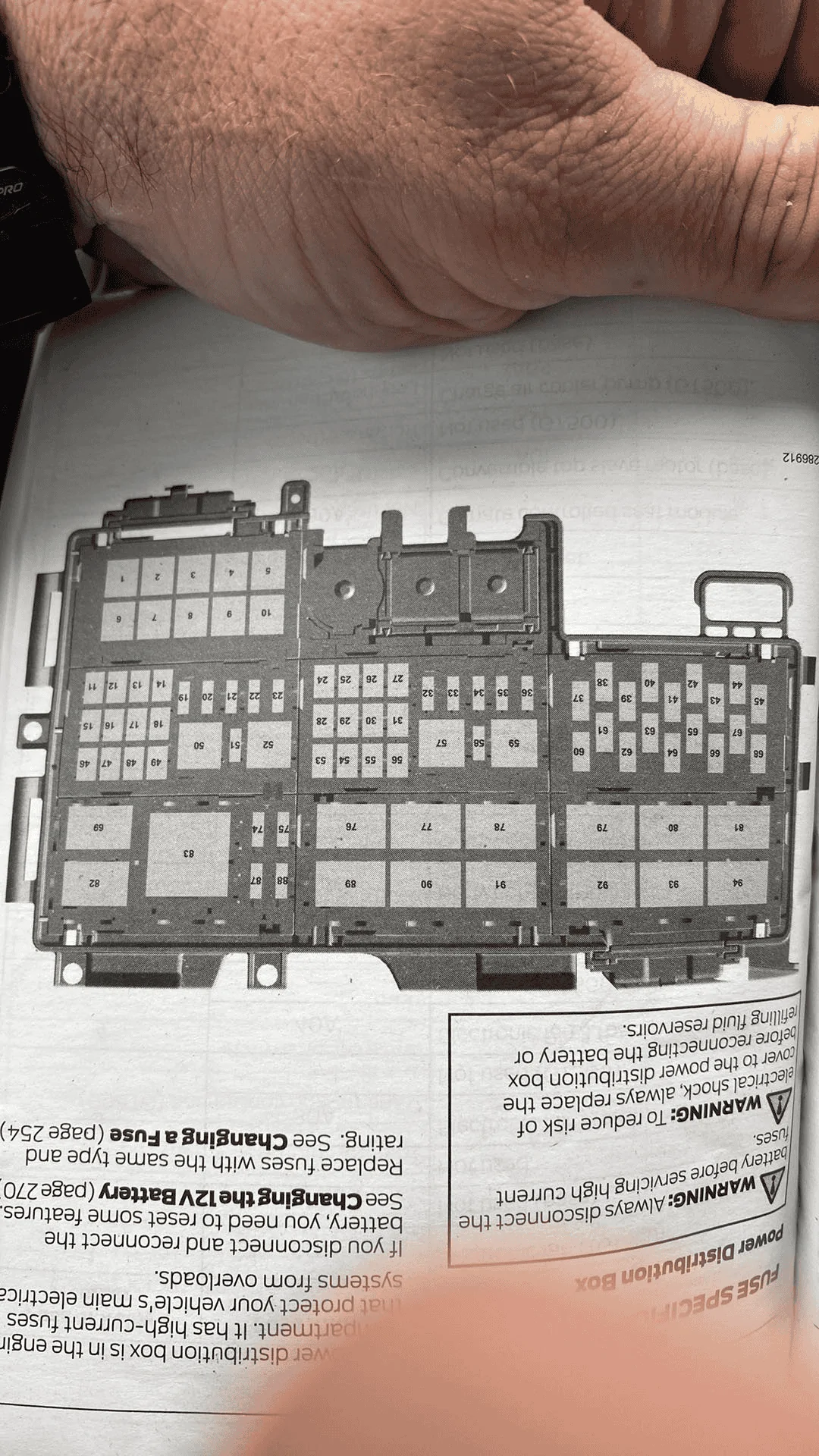

Do you have to set it to track before you turn the car off and pull the fuse for this to work?
Yes ............ nefd to know how to remove the fuse ?
