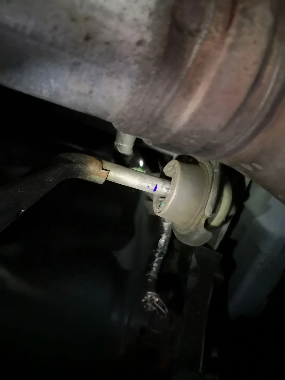

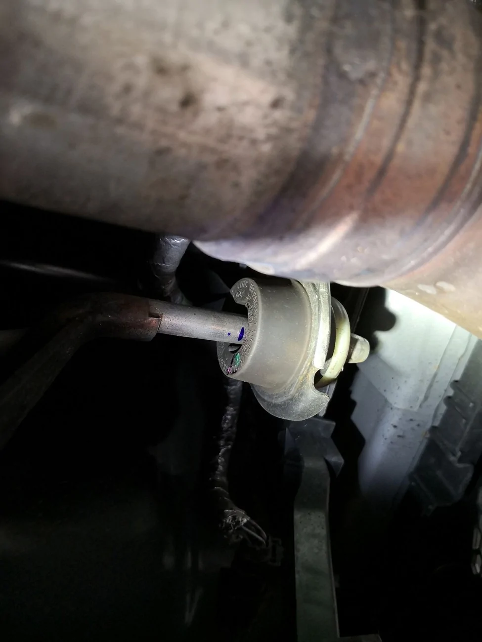

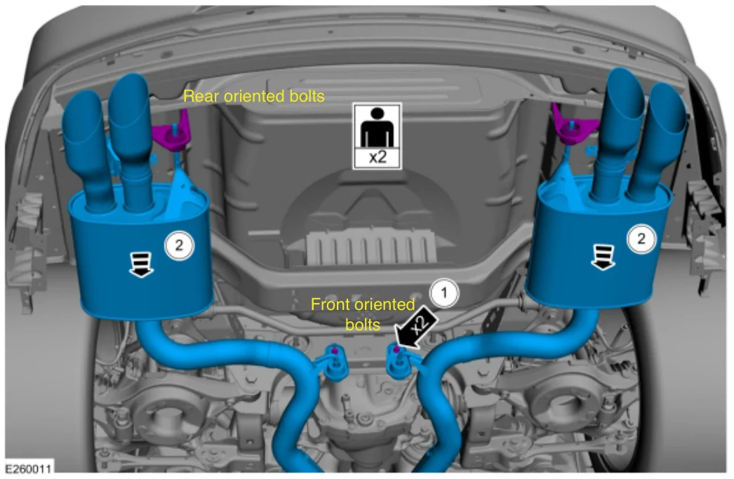

I marked all four bolts - two in the rear facing rear and two behind the diff facing front - with a marker to be able to track any progress.

The idea was to push the whole exhaust (despite my service manual suggesting there should be several clamps along the way, the only clamps were those connecting the muffler) as much forward as possible. Ideal would be to push the front oriented bolts all the way in.

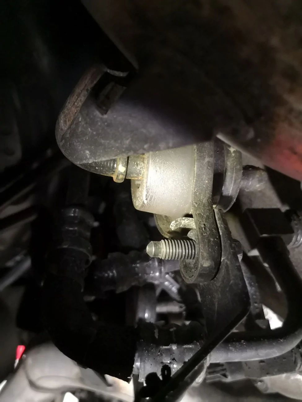

Here is a picture of the rear facing bolt before the fix:
And after the fix:

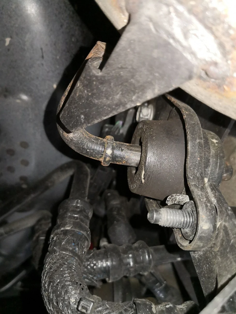

The front facing bolt - the one on the passenger side which shows different level of wear - where it was originally sitting in the hanger.
The same spot after the fix.
