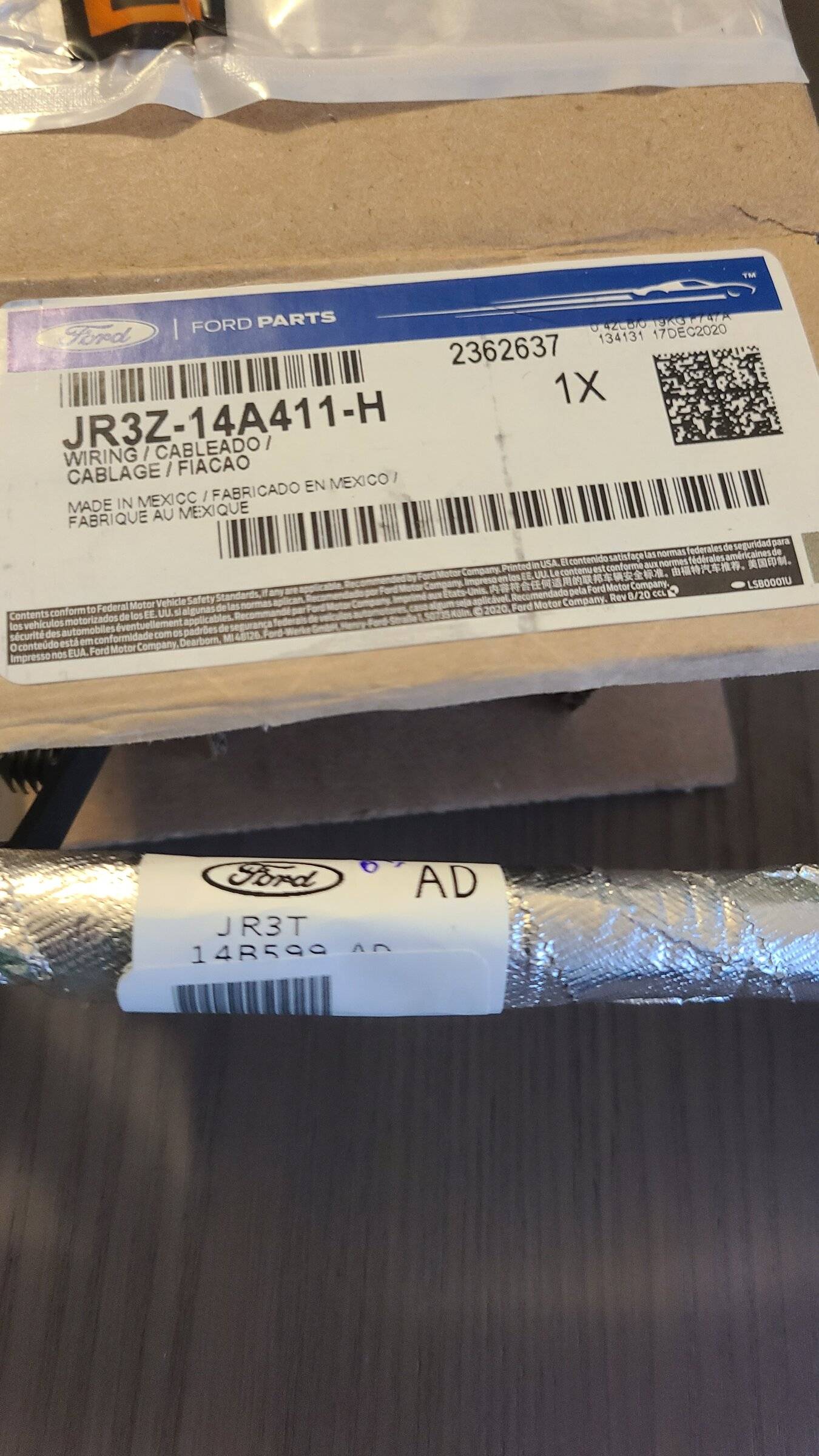

I ordered "JR3Z-14A11-H" from Bartow Ford, but the part in the box was part number "JR3T-14B599" ffs.
What I was sent from Bartow ford.

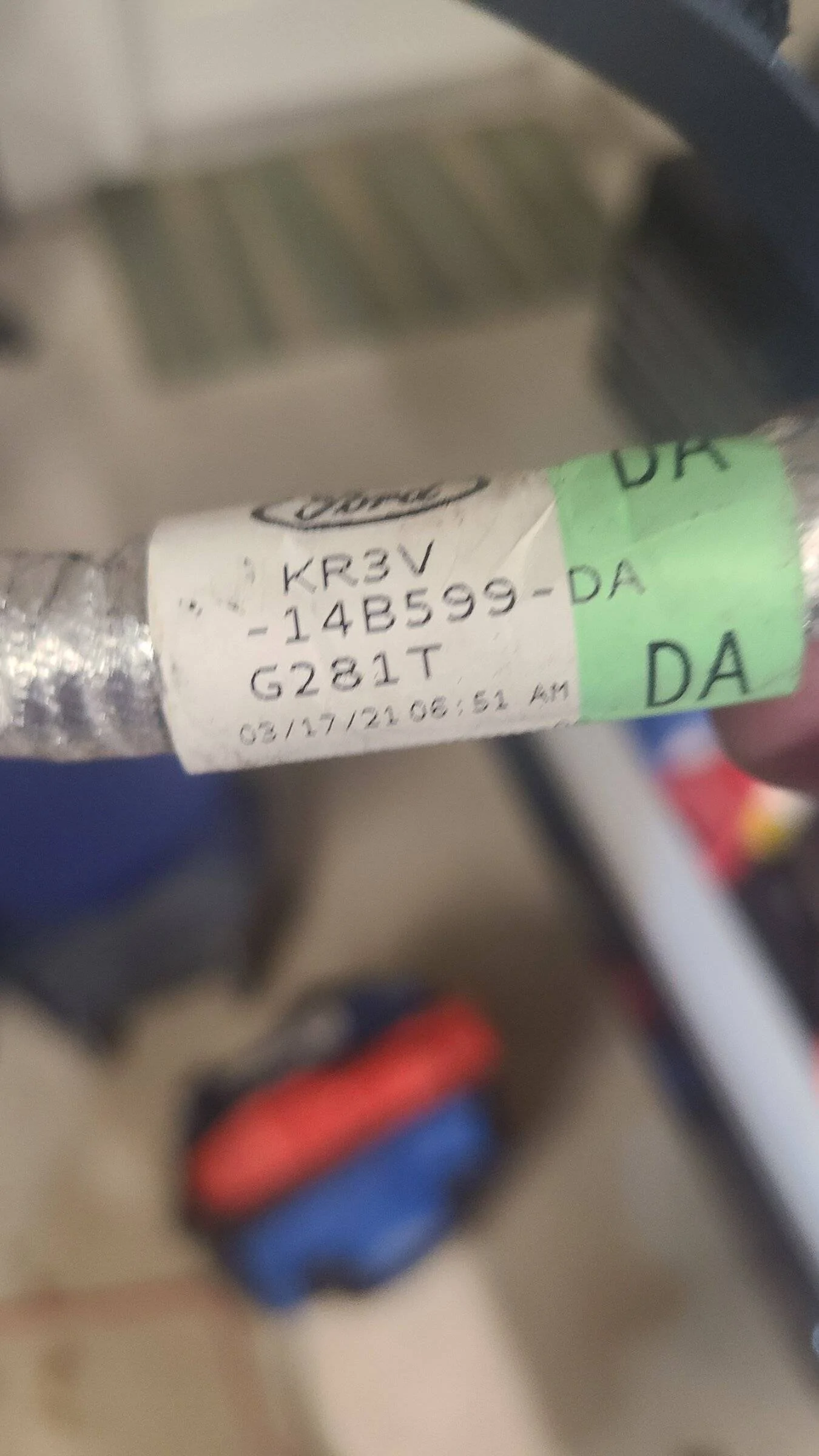

Correct part number off the car. Going to start by finding this part number and ordering one of these.

Next update: I went to my local ford dealer and asked them to lookup the part number in the picture above. It was explained to me that this is an engineering part number and not the actual part number. Engineering part number KR3V-14B599-DA, likely translates to ford part number KR3Z-14A411-G. Considering ordering one...
