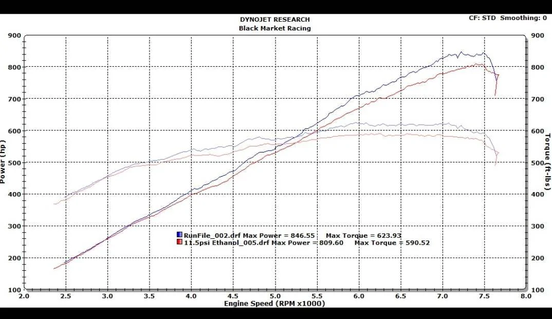

I might start something by saying this, but if you just want something fun, why not the base g2? Just based on some of the data and slip times that I've seen from this forum, the g2 seems to hang with it pretty well until you get to dedicated racecar builds where you run out of blower. The price difference might make less sense if you want the bigger g3 intercooler.
This was a comparison with the same 105mm pulley and e85 for both the G2 and G3. "Same everything" so this is the difference in only head units and not in bigger G3 head + bigger intercooler. Getting a g2 might be enough for what you want, but if you're sure you'll want more later, the g3+ flows more and makes more power.

Man, great information right here, thanks. Does the G2 have self contained oil like the G3, or do you have to tap the oil pan?
It’s self contained. Forgot to mention that some people who have owned both say that the g2 is a bit louder, which they missed after upgrading. I know it’s just blower noise so it’s a subjective part of the fun but if that’s important to you, it’s good to know.

I think you just sold me on a G2 with the G3 intercooler. Thanks!!!

I’ll tell you why I went G3 vs G2. I wanted the bigger intercooler and that upgrade alone made up the difference in price, essentially.
I’m running GT500 injectors, VMP BAP, G3, 120 pulley, and tuned by Wengard. I went with the VMP because that’s what Wengard preferred.
Like the OP, I wasn’t looking for the fastest car on the road, I just wanted something with a little more power since it’s my fun/project car. The kit was extremely easy to put on, I was able to do it myself in a 6 hours or so with no help.
