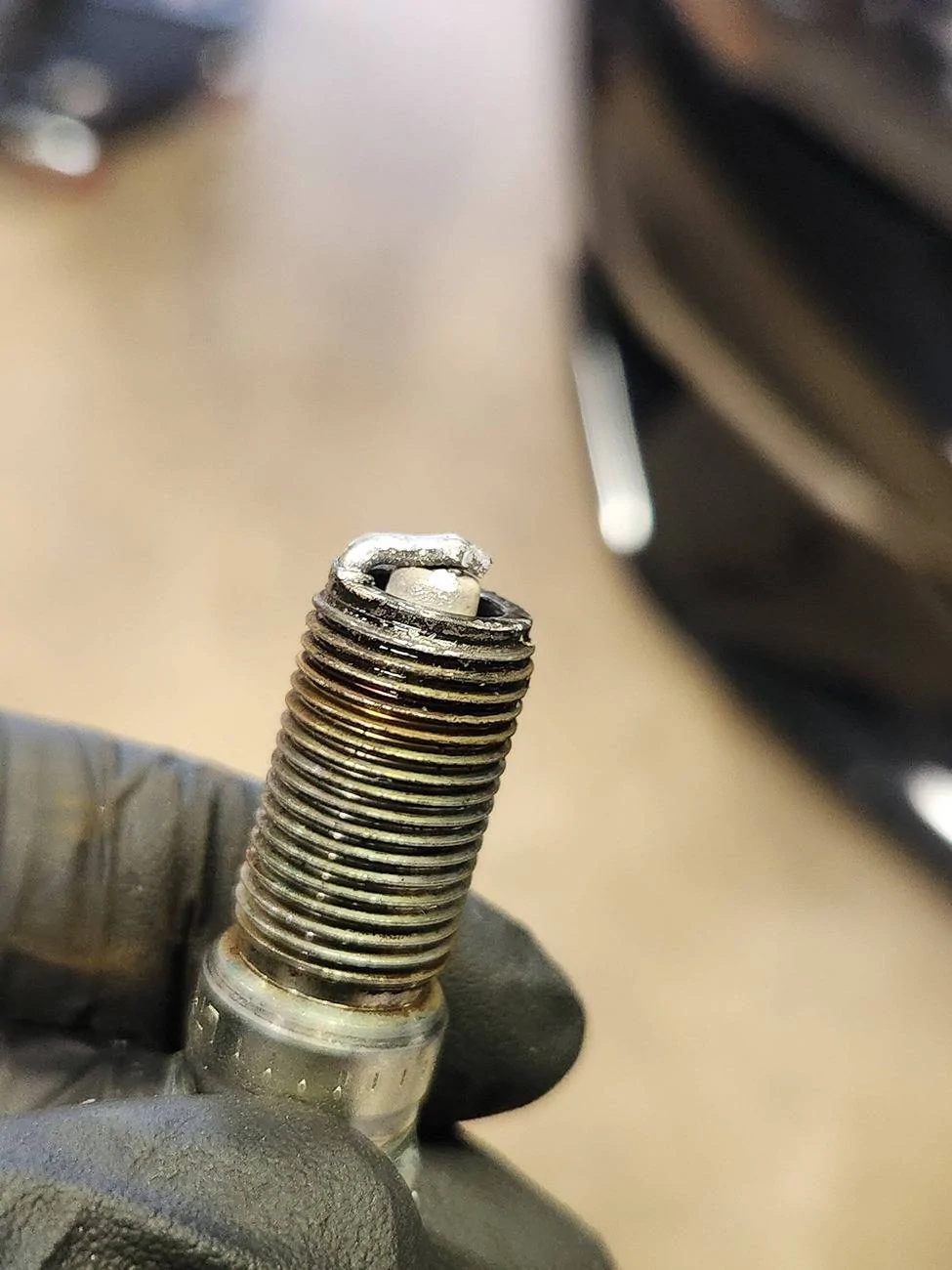

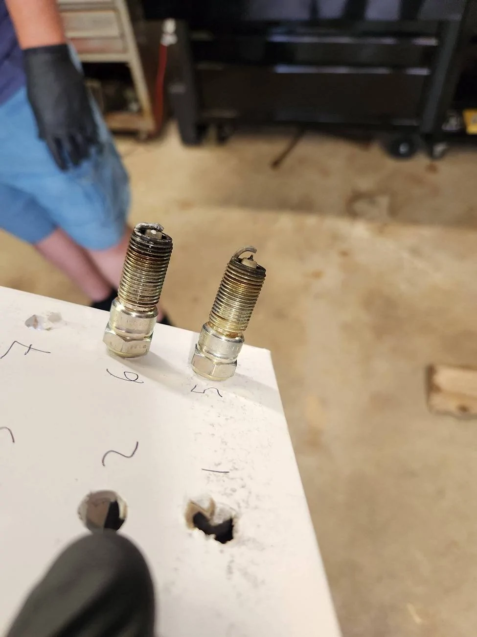

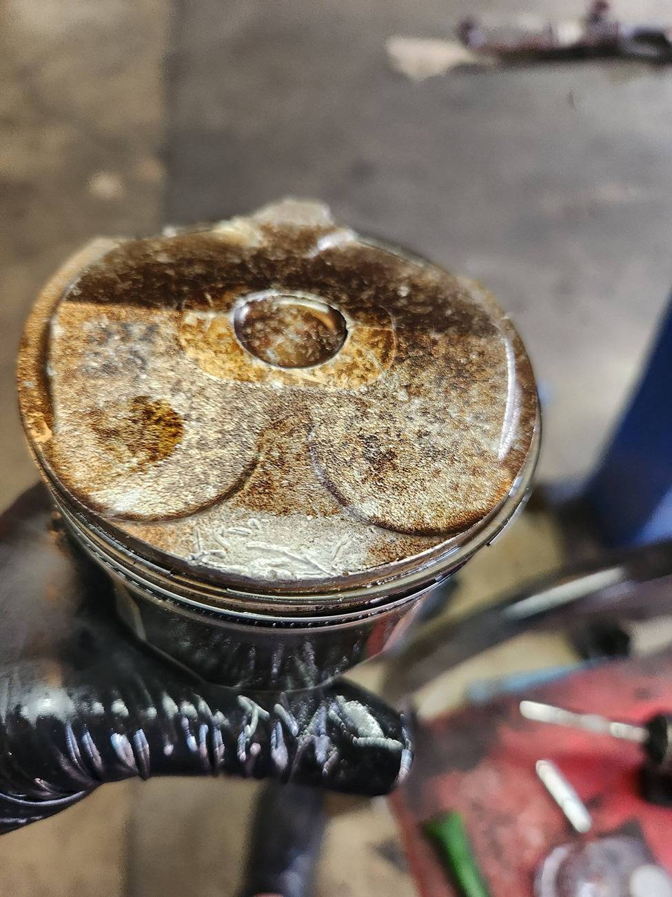

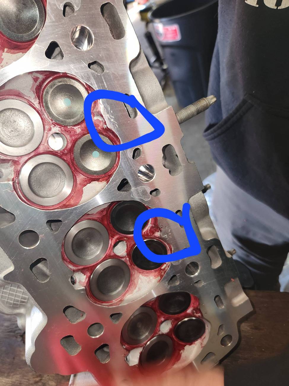

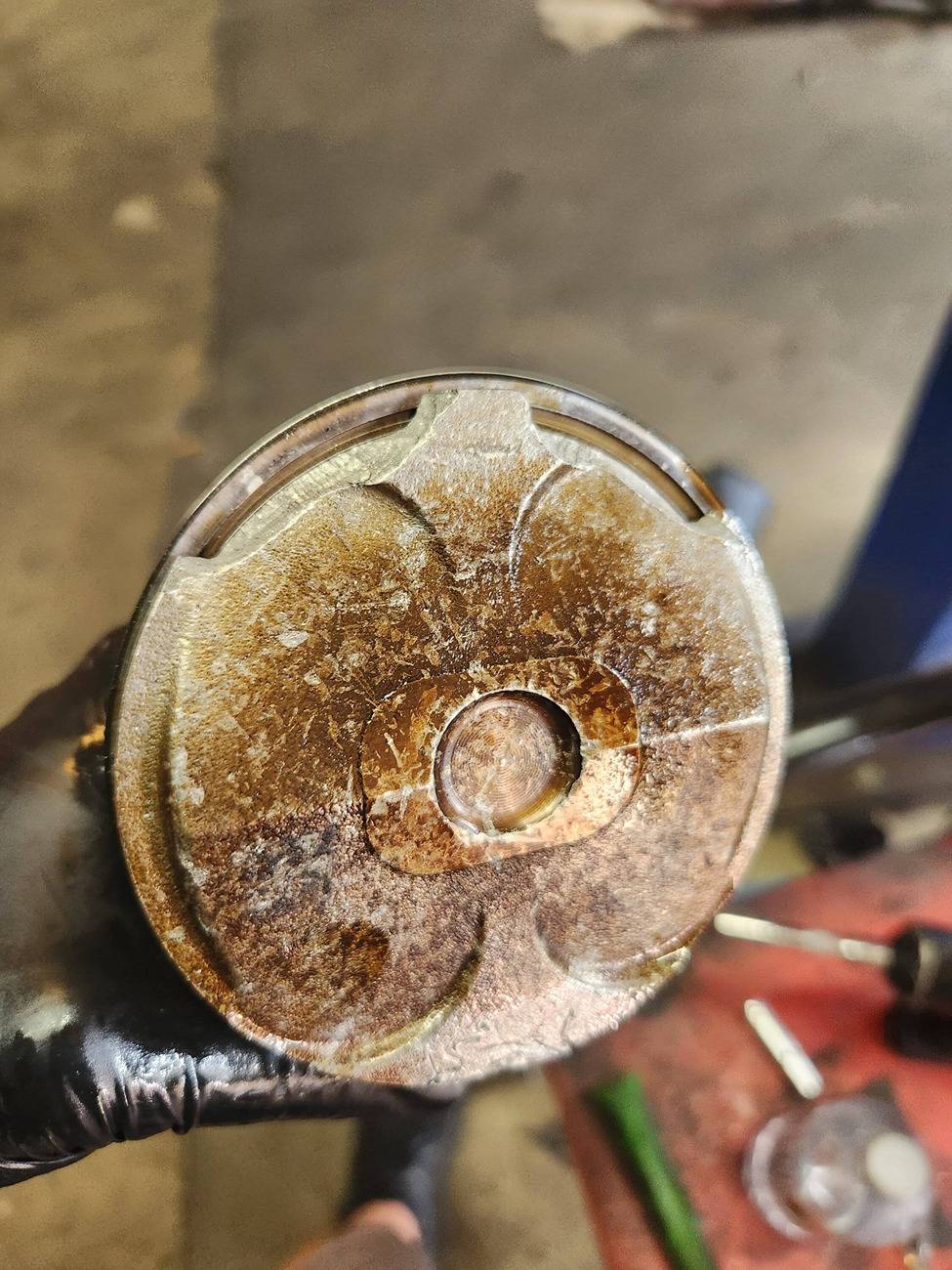

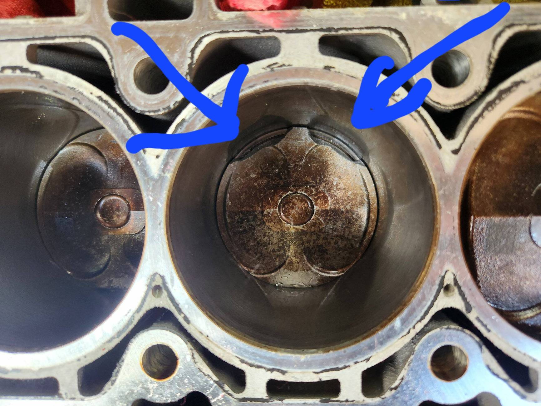

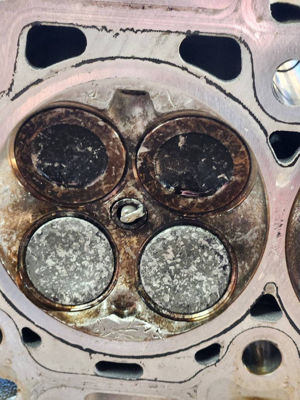

Ouch. How did the head/valve do? Or did it just get broken up enough and spit out the exhaust valve with little to no damage?
Before and after clean-up (decking, new valves and springs) at the machine shop. Those pieces rattled around pretty good
