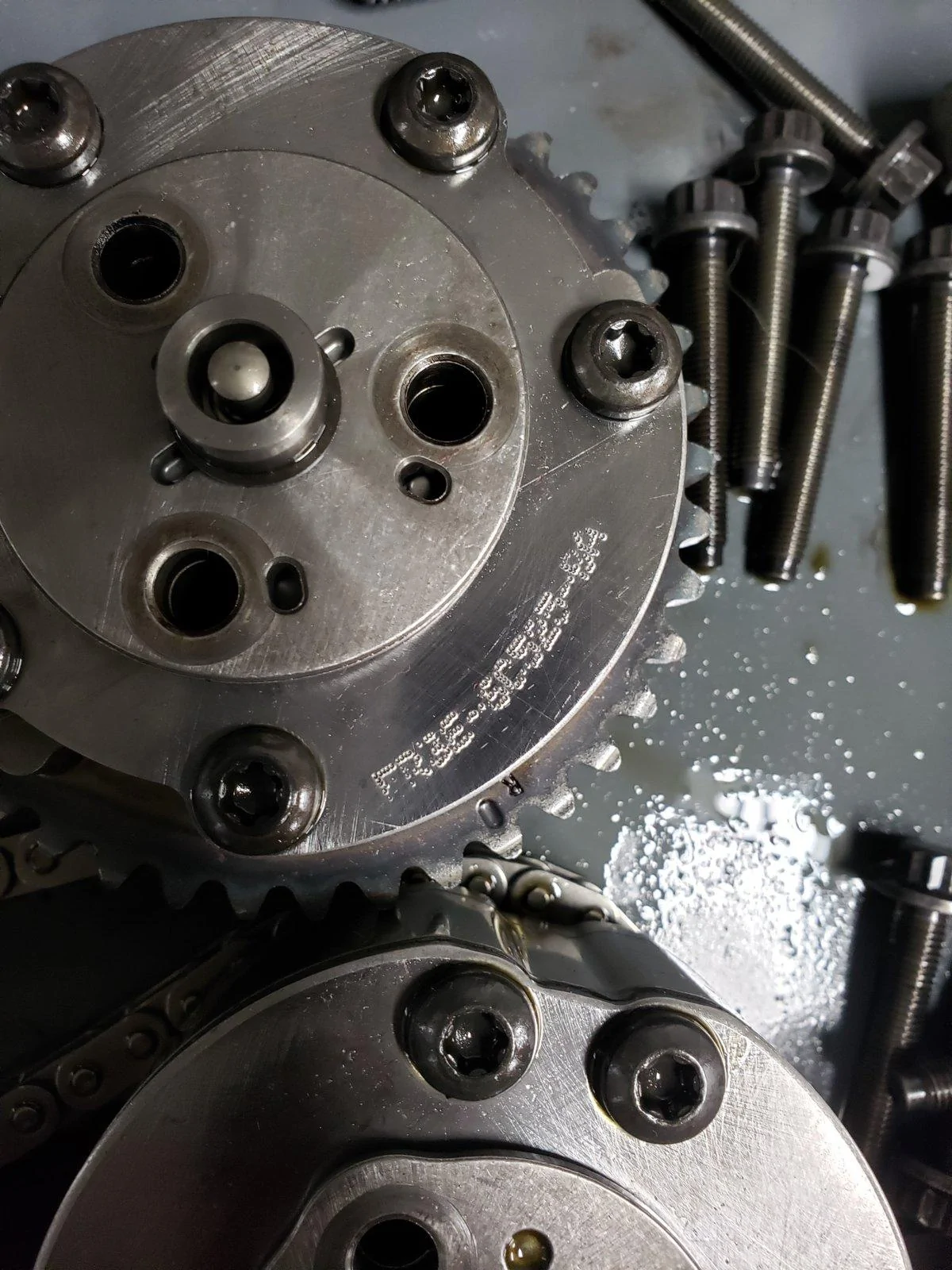

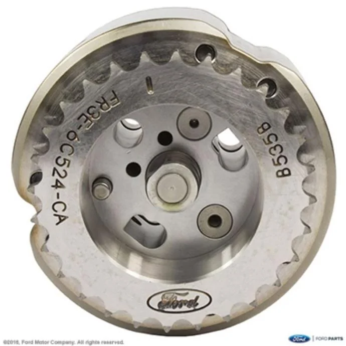

I was able to enlarge the Magazine image
The two part numbers that show up
FR3E-6C524-CB This one is printed over XXXXXXXXXXXXXXX
GR3E-6C524-BA
Looks Like Ford Racing provided parts with their part number
Pure speculation on the Authors part.
@honeybadger
Can you take a picture of the face of your VCT intake phaser head as shown above? Yours is the only GT350 non-R I know of that's purely torn down and has easy access to this. :)
There's two part numbers on that phaser, if yours only has one that shows a difference between R and non-R engines.

The Ford online parts catalog, whether Fordparts or dealer website, are rather deficient in regards to the GT350. Even with a "R" VIN, they will show Coyote part numbers. The cam phasers and lash adjusters are only a couple of examples. The part number on the cam phaser photo above (FR3E-6C524) is for the 5.0 Coyote. Actual part numbers for the coyote are FR3Z-6C525 and FR3Z-6256. The GR3E-6C524 is the GT350 phaser (actual part numbers GR3Z-6C525 and GR3Z-6256). Ford Racing will bundle parts such as lifters, rocker arms, valves, phasers et. al. but they are GT350 production parts.
bauern
Aug 25, 2018
390
280
somewhere else
Robert
F150 Powerboost
I just want to add that it is possible that the phasers and lash adjusters were changed in later years and that the '16 - '17 GT350's actually used Coyote parts. They are identical except for internal revisions.
honeybadger
Just don't care
Apr 20, 2016
63
4,122
7,497
COTA
Kevin
'17 GT350

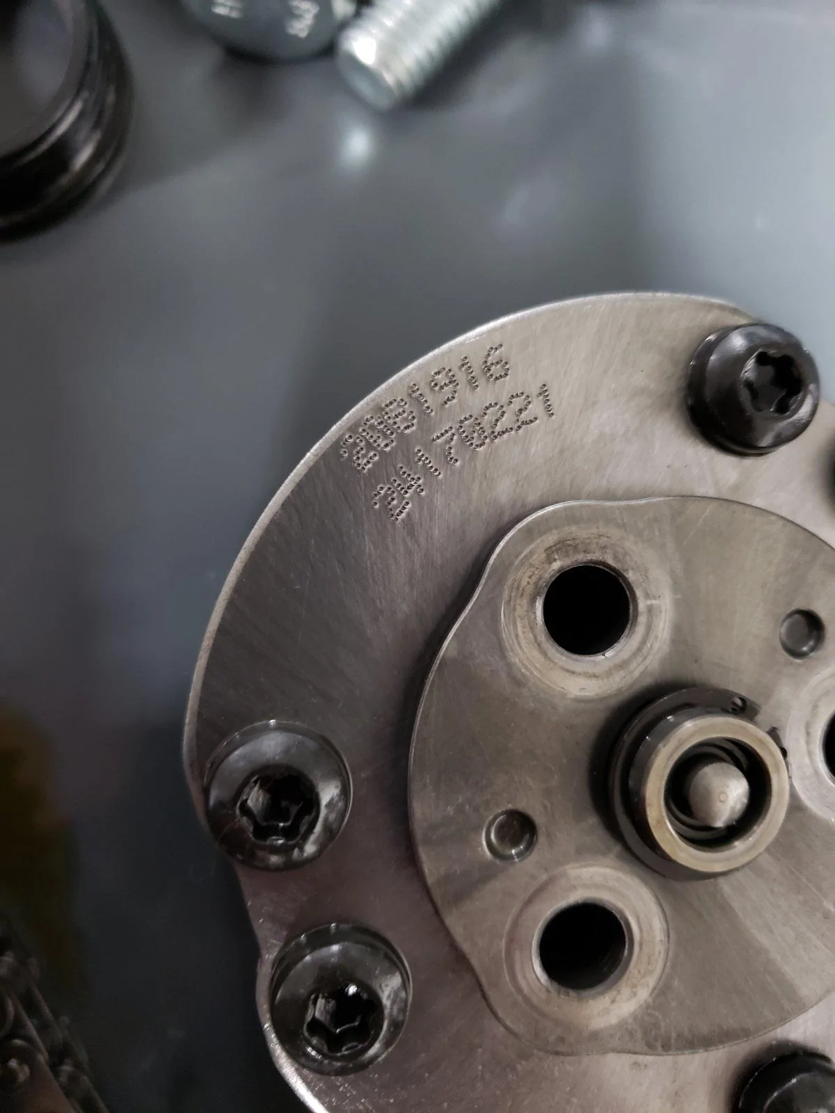

@honeybadger
Your wish is my command.
cosmo
Sep 22, 2014
1,770
765
Michigan
2005 Mustang GT
Interesting! Also, impressive response time!
So based on this, the GT350 utilizes a 5.0L Coyote phaser. Maybe a new item for your build, honeybadger?
The GT350R rebuilds the phaser with special specs, stamps out the FR3E number with the XXXX's, and assigns the GR3E number (which is also, apparently, the high performance part sold by Ford racing).

FWIW, I used the Ford Racing kit. The only part number on it is the GR3E-; no XXXXX's .
cosmo
Sep 22, 2014
1,770
765
Michigan
2005 Mustang GT
Yep, bit odd that they stamp over the FR3E number on the GT350R phaser but replace the plate on the Ford Racing kit.
Probably just a cheap cost save on not needing the replacement plate for the GT350R, and to make the Ford Racing kit part look better?
