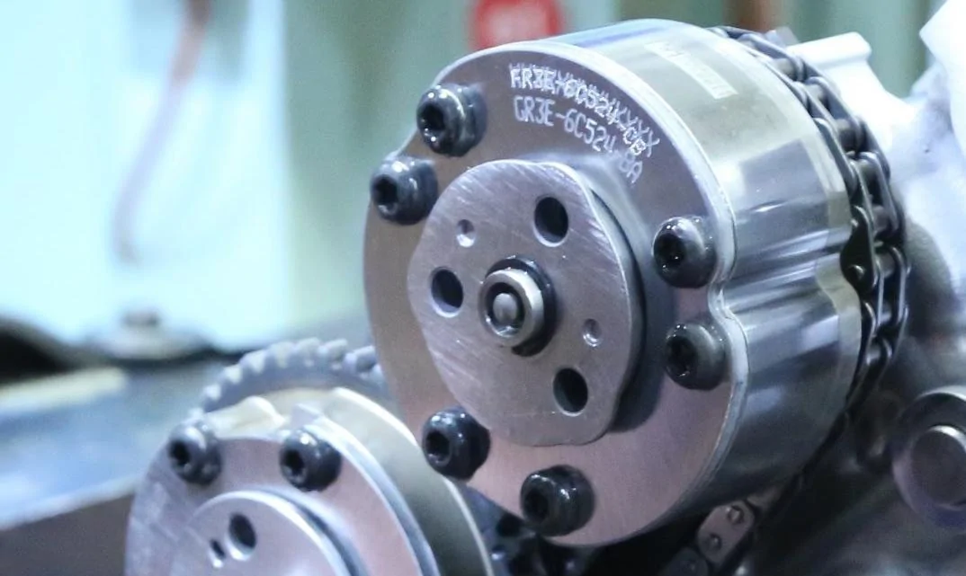

I'm wondering if the lashers thing may have actually been more of a part supplier identification than actual different part spec. That's my theory. But then yes, the article was definitely miswritten. If that's a word.
I think you hit the Nail on the Head..
I was able to enlarge the Magazine image
The two part numbers that show up
FR3E-6C524-CB This one is printed over XXXXXXXXXXXXXXX
GR3E-6C524-BA
Looks Like Ford Racing provided parts with their part number
Pure speculation on the Authors part.
