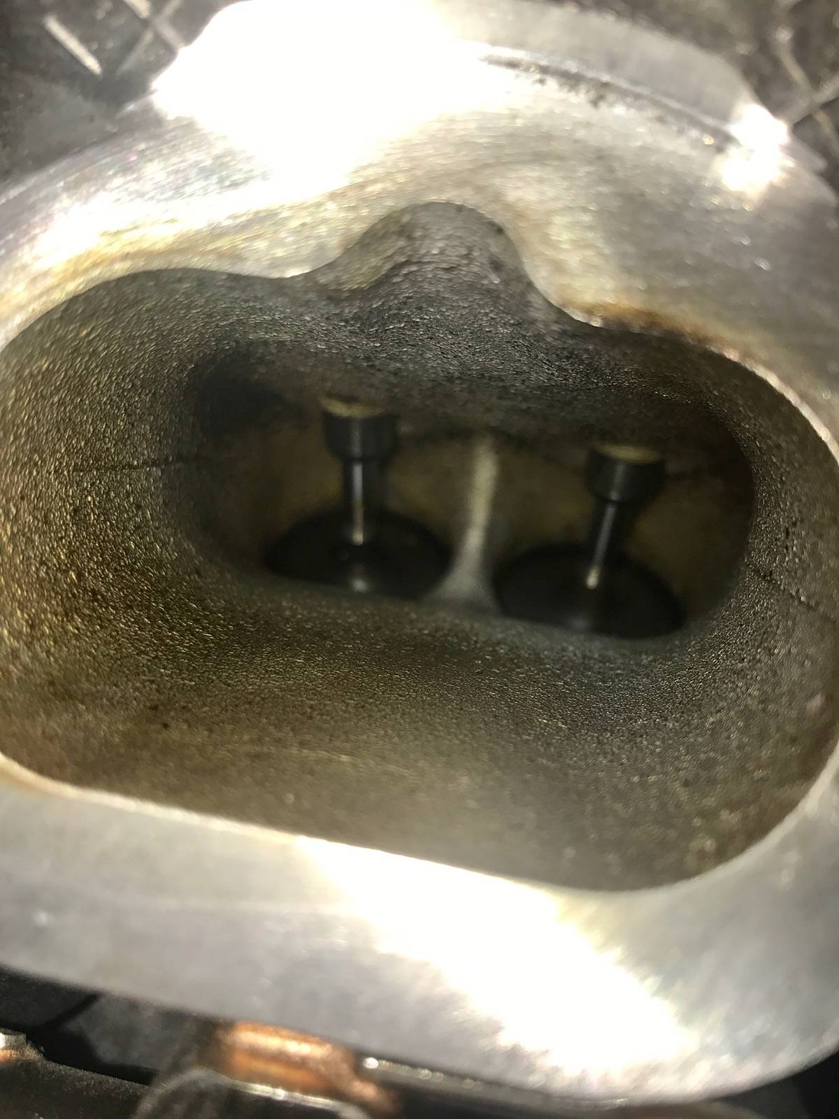

If that is true, why are there also videos about excess carbon build up on engine rebuilds after e85? Not arguing, trying to learn as much as I can here
I don’t know, but here’s a pic of my intake ports on my 2019 Bullitt with 5962 miles on it, during which I also ran 5-6 tanks of 93 fuel. I don’t think it looks too bad at all in the ports. It would be interesting to see what the intake ports look like on a car that has been on nothing but 93 fuel. Surely there’s several people on here with their intake manifolds off that can take some pics and post them here.

This is about 5000 miles on just 93. It really depends a lot on the detergents in the gasoline. This is shell 93.
That YouTube “soot test” is a load of hooey.

That’s very clean! What fuel were you running there, Shell 93?
