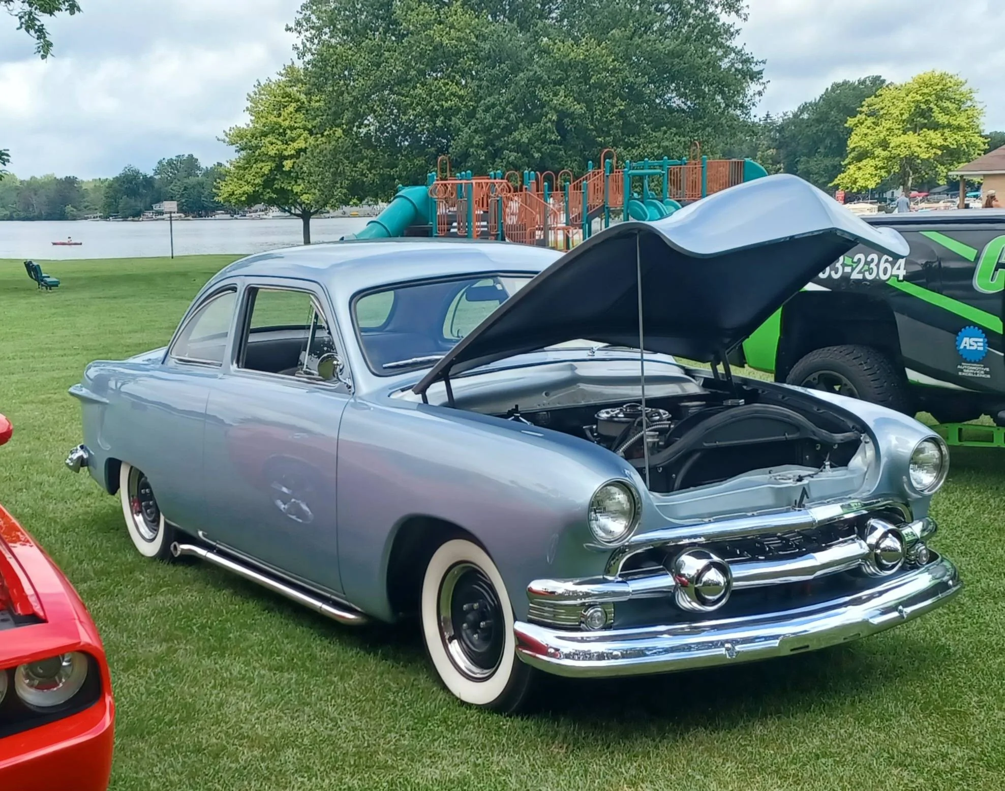

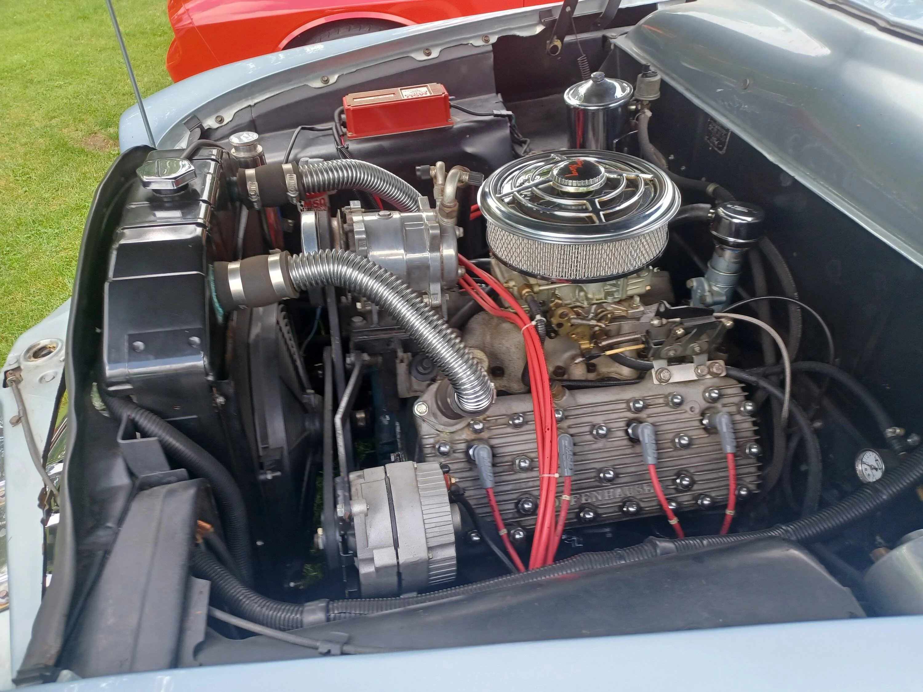

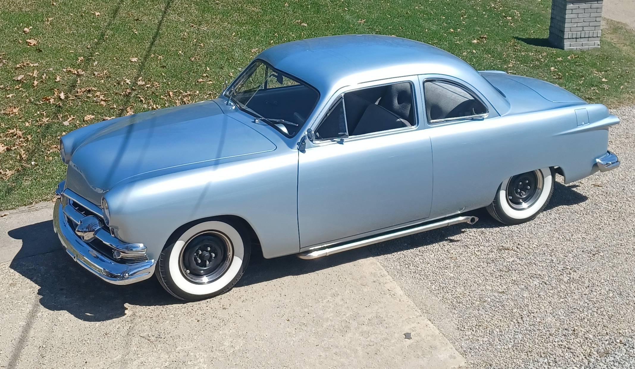

I have a 51 Ford and can buy almost anything it needs with ease, brand new. I'd guess this will be a non issue for you....
