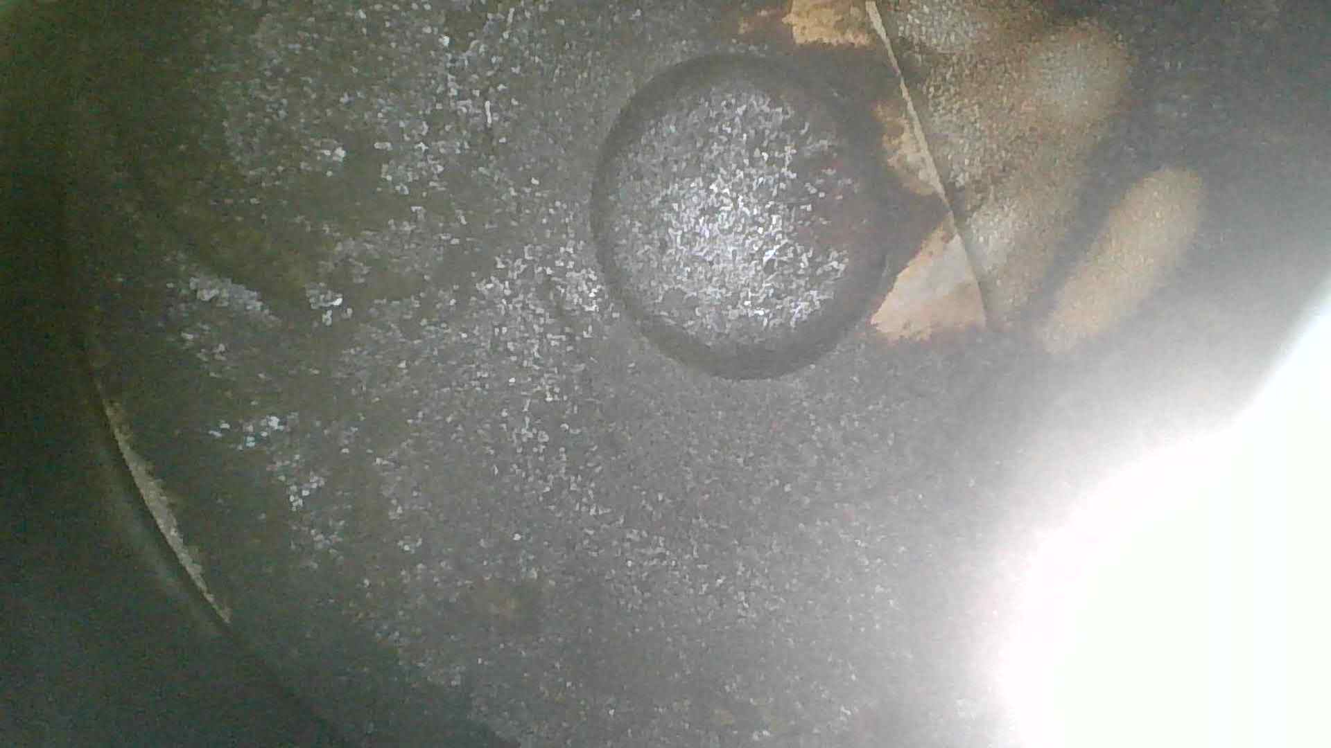

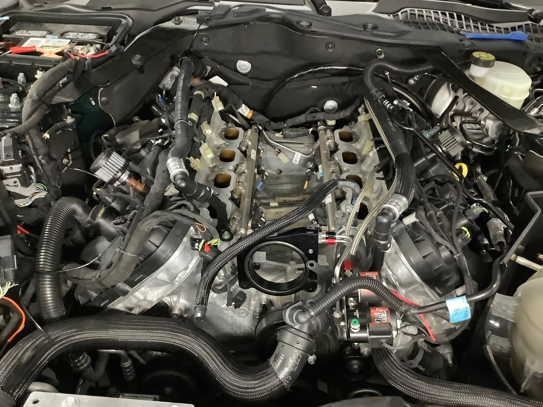

I don’t know, but here’s a pic of my intake ports on my 2019 Bullitt with 5962 miles on it, during which I also ran 5-6 tanks of 93 fuel. I don’t think it looks too bad at all in the ports. It would be interesting to see what the intake ports look like on a car that has been on nothing but 93 fuel. Surely there’s several people on here with their intake manifolds off that can take some pics and post them here.
Piston tops would be interesting too. Here's one from my car around 20K of pure 91 pump gas.
