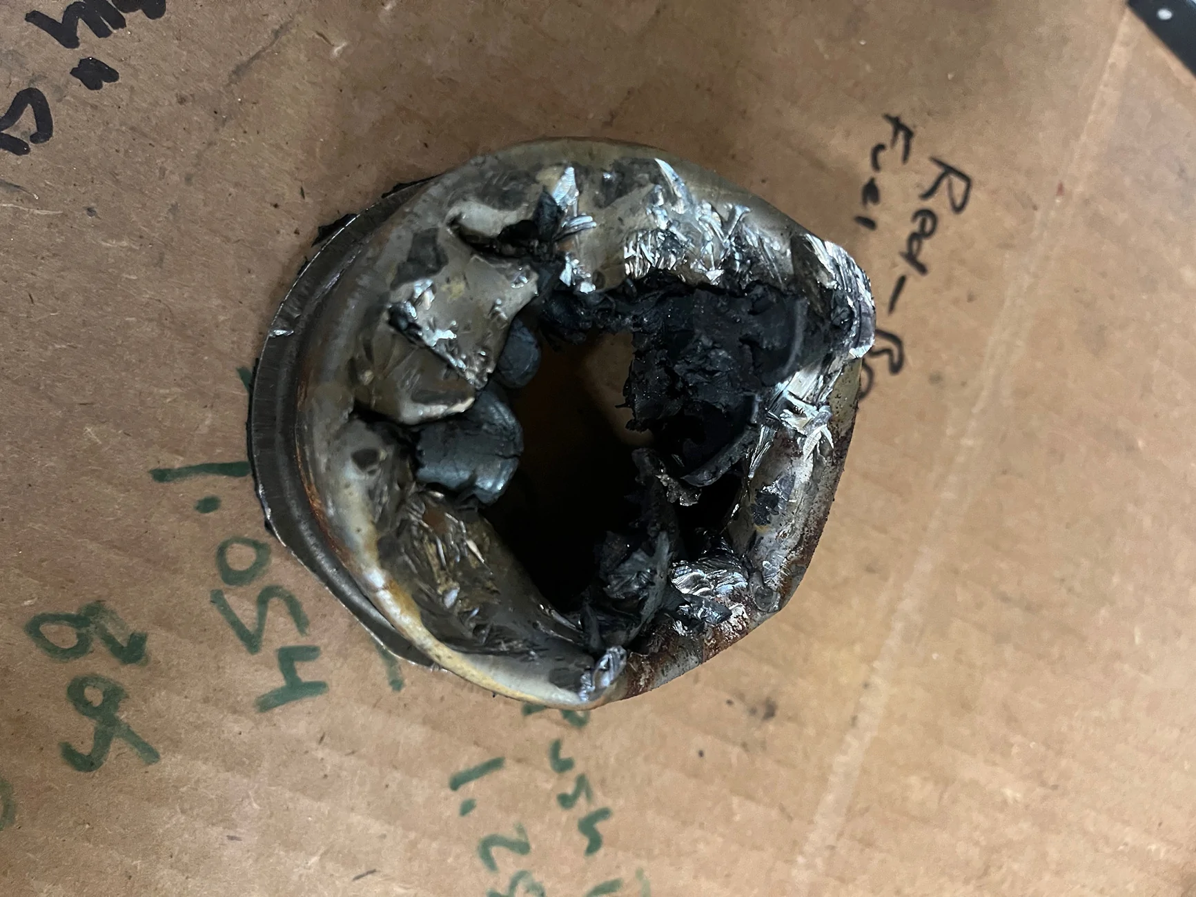

Appreciate the replies. I managed to get two of the rubber bushing inserts out with persistence, but it sure is slow. Once that's done, cutting the steel insert is not really a big deal even with a hacksaw, which worked for me. Got one insert out, the other one I didn't cut through far enough so now I'm peening the inside around and it's just now starting to slip out a bit.
I guess I'll see how much more pain, I can endure before I go buy yet another tool. Rule of thumb for me is when I start leaving drops of blood around my work area, it's time to wrap it up for the day. So it will wait till tomorrow. :)

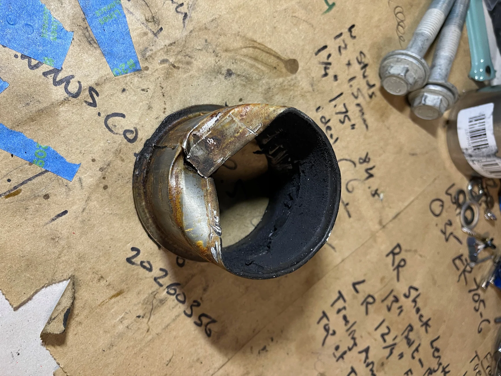

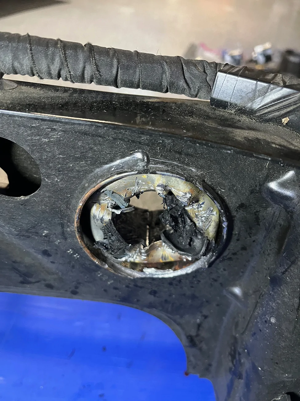

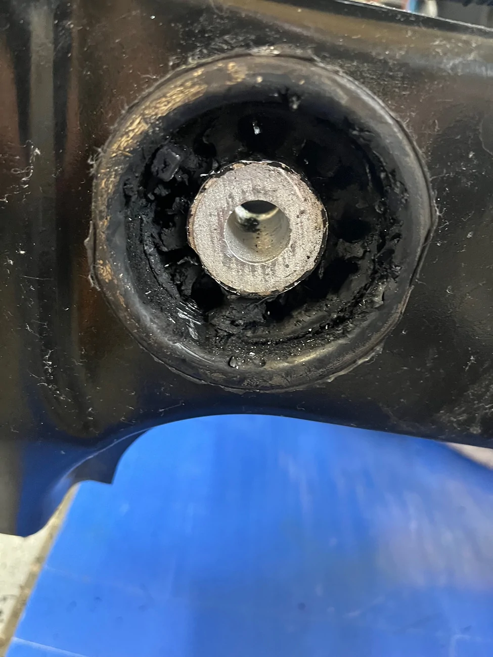

Well, victory today, but it was a battle.
Reciprocating saw was clearly the best way. Rubber cut out in literally 2 minutes per bushing.
The sleeves still gave me some trouble as I was afraid I was cutting too far and would go through the sleeve, but evidently I never did, so getting the bushing sleeves out was still a challenge.
The other part of me doesn't like destroying parts to remove them so that probably contributed as well. Picture is of the last sleeve which of course was the toughest one.
Anyway, happy to have them all out today. Maybe can put new ones in tomorrow.

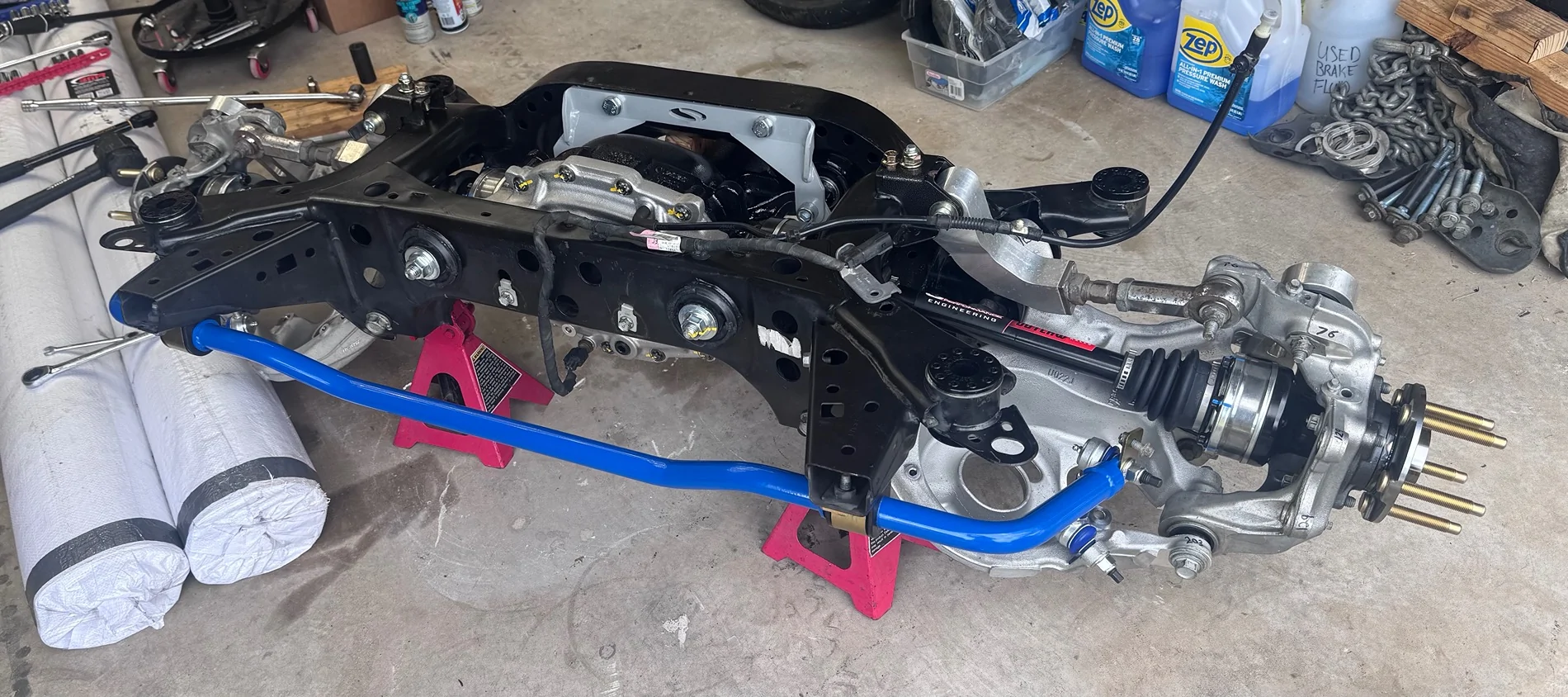

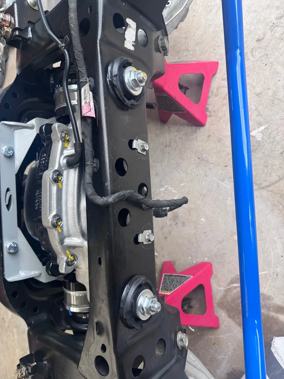

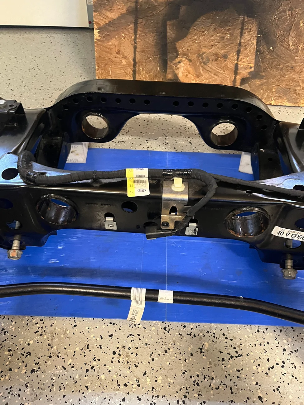

Steeda diff support brace, drag spring, drag sway bar and end links, and the replacement subframe bushings.
I replaced the rear lower arms with new Ford arms and ordered the spherical bushings from Steeda only to learn Ford no longer makes S550 rear lower arms; they only make S650 arms, and those bushings are smaller than the S550 bushings.
Steeda let me return the S550 bushings and then I ordered the S650 bushings that I needed, but by the time I received them, I already had the rear sub installed on the car, thanks to the certified HOA letter I received.... HAHAHA
I'm not in a rush but if I decide to install Kelltrac's new rear coilover setup later, I'll probably have the spherical bushings pressed in at that time.
That’s a nice Steeda part in your image!
