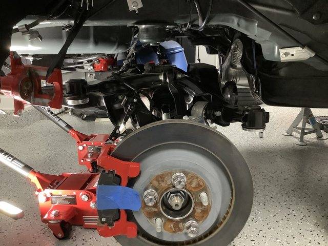

You need to lower the cradle more than 1/2”. I lowered mine several inches and it made access very easy.

I do not feel comfortable doing so without a proper transmission jack. I would be happy to borrow one but I prefer not to own one.

I just used two floor jacks and a scissor jack to control the pumpkin. I saw no need for a special transmission jack.

If you drop it that far, you might as well consider their differential bracket too.

I meant to remind you not to forget to unclip the differential vent line from thr cradle before you lower it. Just lower it slowly u til you can fit your hand in there to unclip it.
TLDR: If the mod can't be completed as instructed, then the instructions are lacking.
Thanks @NGOT8R for the suggestions. I needed them Tuesday. The experienced Steeda tech did not say the subframe had to be dropped that far.
I would be glad to also borrow a second jack - and I have needed one occasionally - but I don't want to own one either. The perimeter floor space around our 2-car tract home garage is just too tight.
I guess my point is that it is disappointing and frustrating to fail after I try so hard to research all the trouble spots before going into a mod like this. This mod appears simple on the surface, but is not so much in practice. If the mod can't be completed as instructed, then the instructions are lacking.
I even read the instructions for diff bushing pucks from Steeda, BMR, and Whiteline, and they all spelled out pretty much the same procedure. I searched and read several 6g threads and knew in advance that the fronts would be harder, but none (until NGOT8R) indicated that the subframe had to be dropped significantly.
