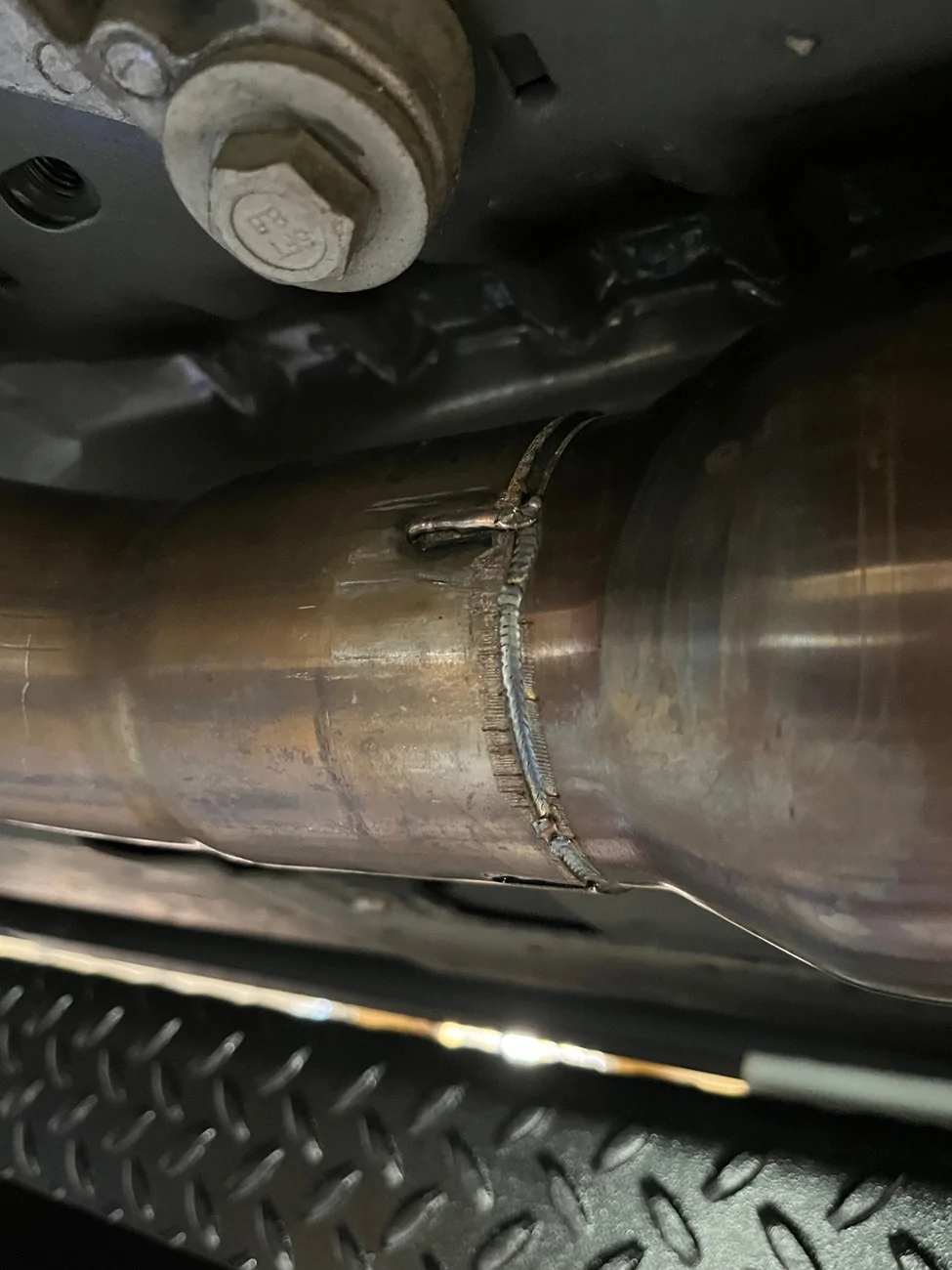

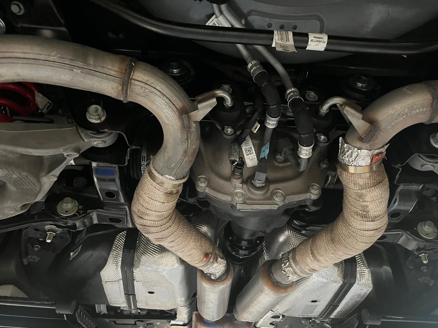

Feels like it's been a long haul. Car is driveable, if open headers were legal, so I'm staying in the garage for now. I'm going to weld my cats to my connecting pipes so there aren't so many clamp-type joints in that section.
Turns out the other item that' was most challenging, in terms of this whole job, was putting on the cat-back exhaust system by yourself. It's not easy and it's a heavy beast to boot.

Okay, the differential bushings. Completely quiet below 50 mph. Between 53 mph and 60 mph (didn't go above 60), there is the slightest diff whine. Very faint, not intrusive. I kind of think that maybe with a few hundred miles of road use it might go away as all rubber bushings seem to be most firm when they are just newly installed. I once put, on another car I had, motorsports engine mounts and I thought on the first drive, "oh oh, I think I might have made a mistake." But, after a few hundred miles it was perfectly tolerable. More firm, a bit more N/V/H but totally manageable.
I think the diff bushings will be the same way. They just need a few miles on them. If they don't change I can live with that too.
Welded cats to connector pipes are good, no leaks and got rid of one big clamp on each side.

Few hundred miles on the diff bushings now. They are totally streetable. There's a very mild diff whine, most prominent between 60-70 mph. Less noticeable below 60 or above 70 mph.
Overall, a reasonable upgrade without much downside other then the time and labor to install.
