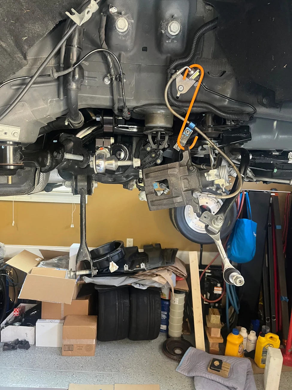

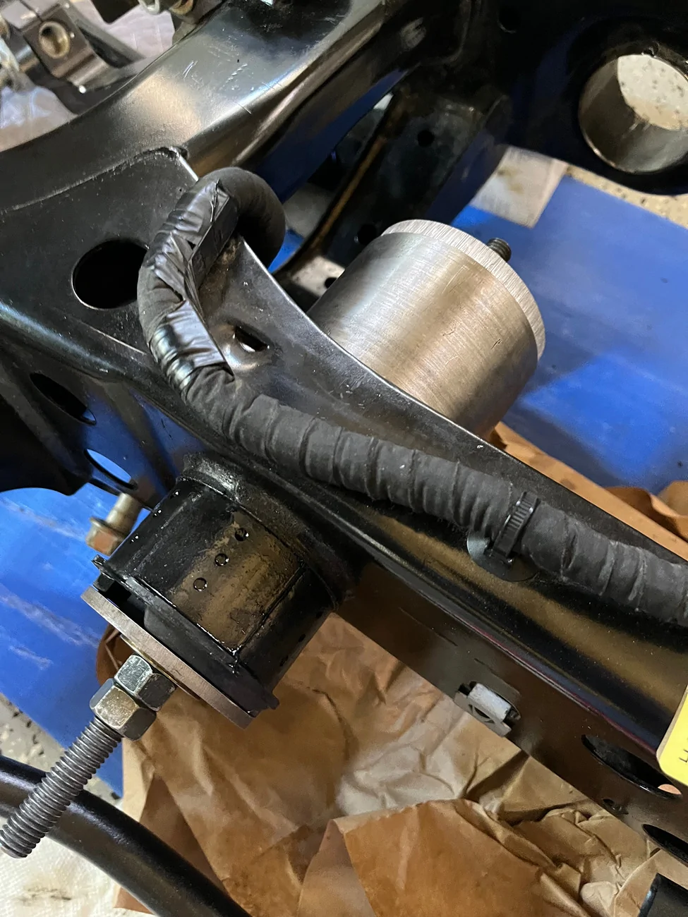

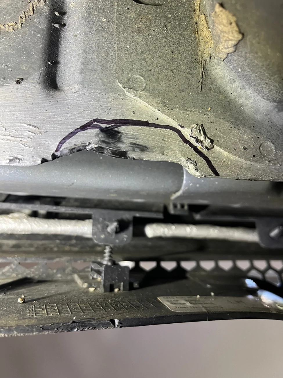

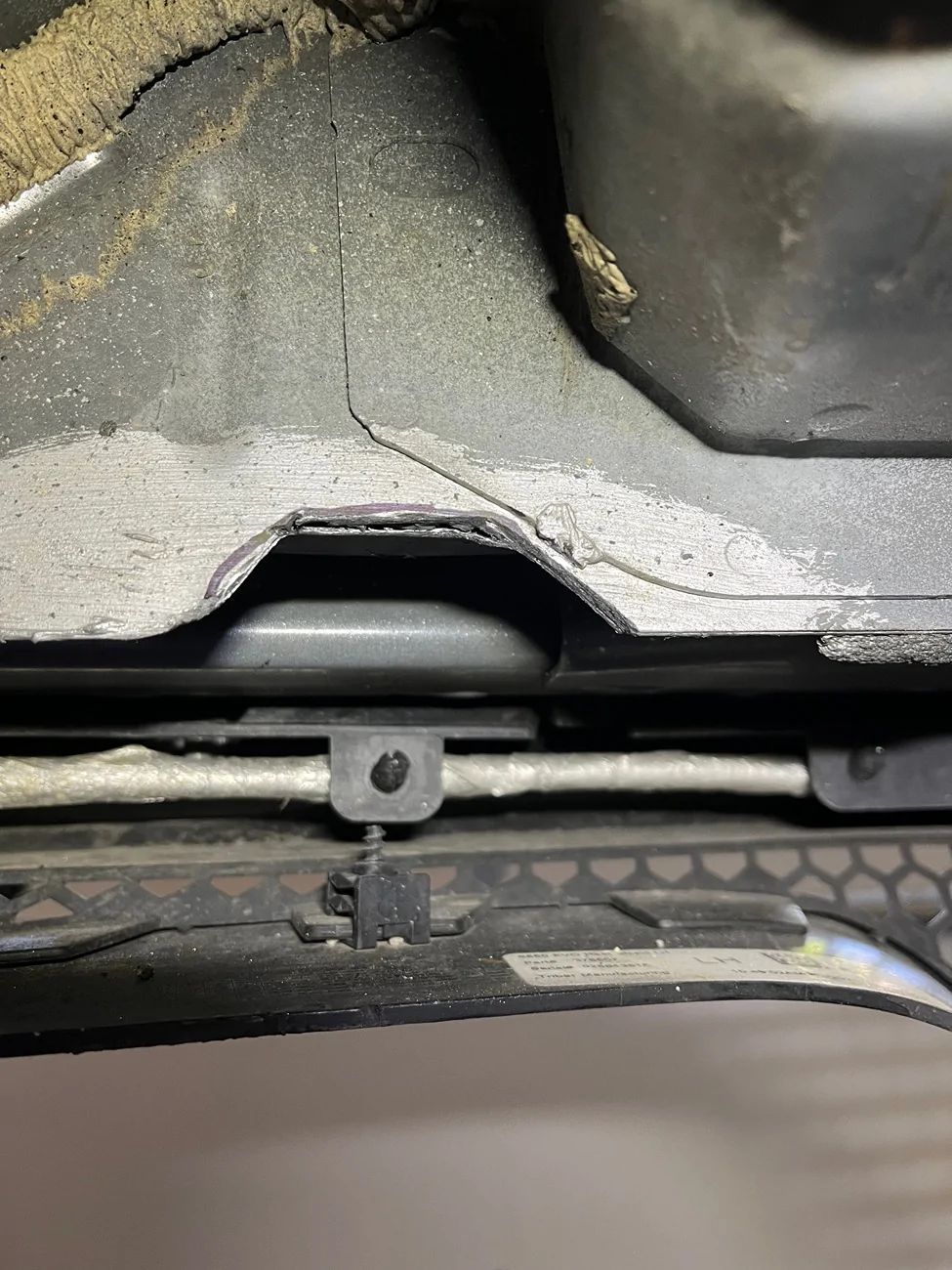

So, I was one of those Mustang guys who had the problem with the passenger side active exhaust valve connection shorting out on the body seam.

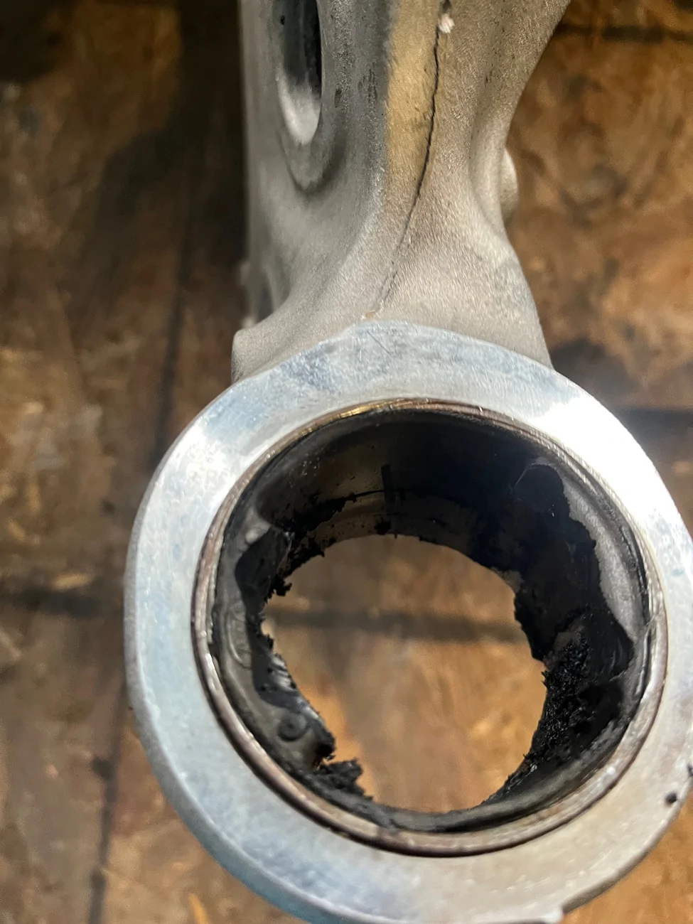

I clearanced that area, maybe 3-4 years ago (picture #1) but with removal of exhaust I noticed it's still rubbing (but not shorting out yet). You can't see it but the metal is shiny in two spots.
Picture two is additional clearance which I'm thinking should be enough.

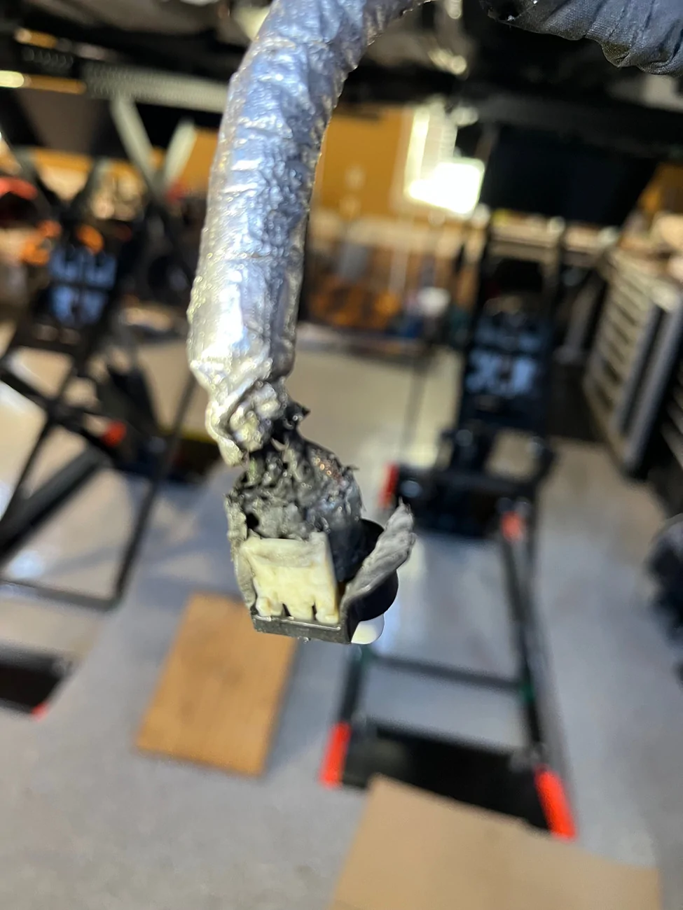

Last picture is the Connector which was mangled from round one but it's more messed up now (new one on order from one of our sponsors here).

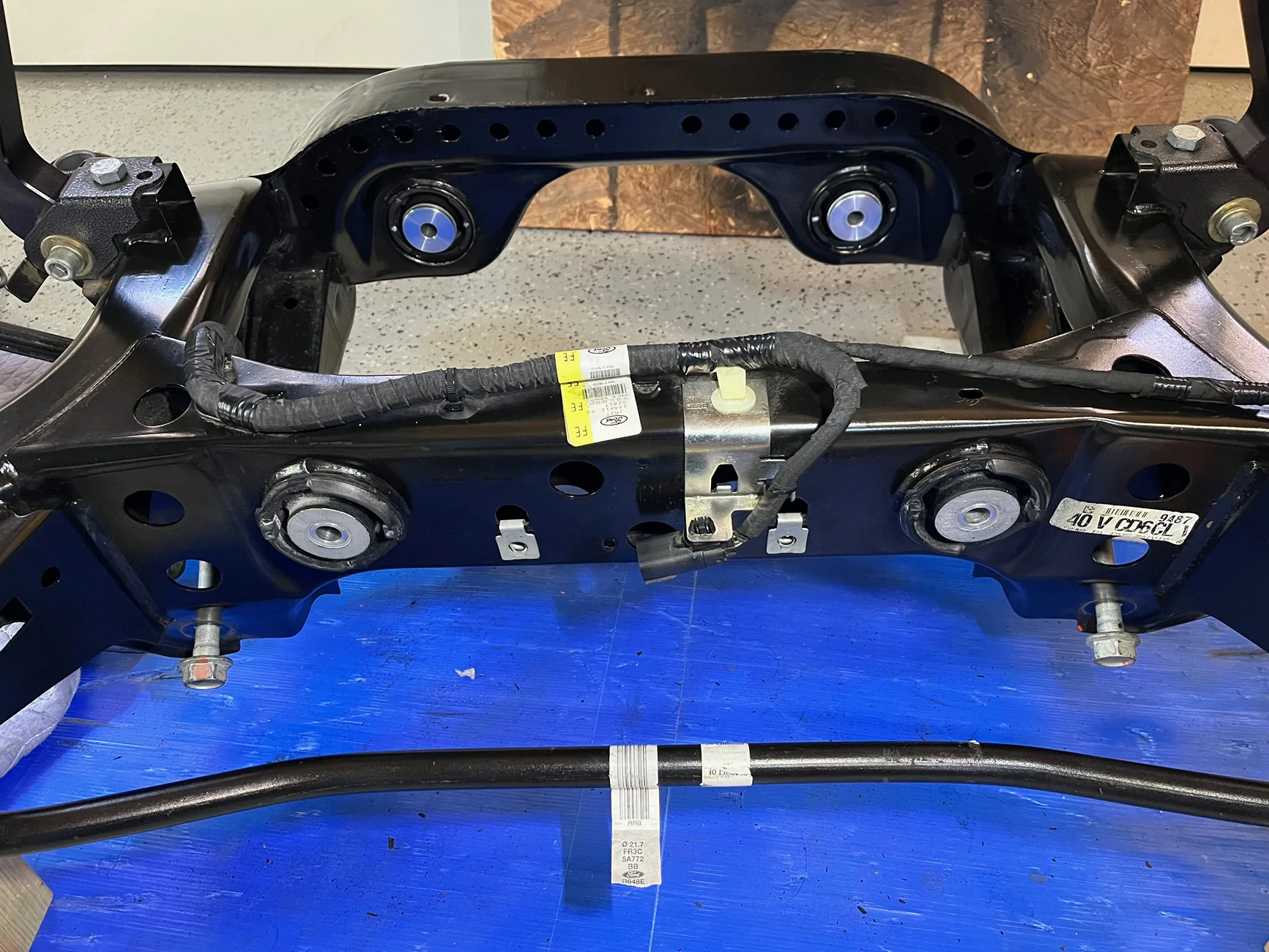

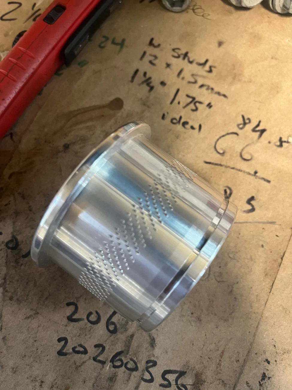

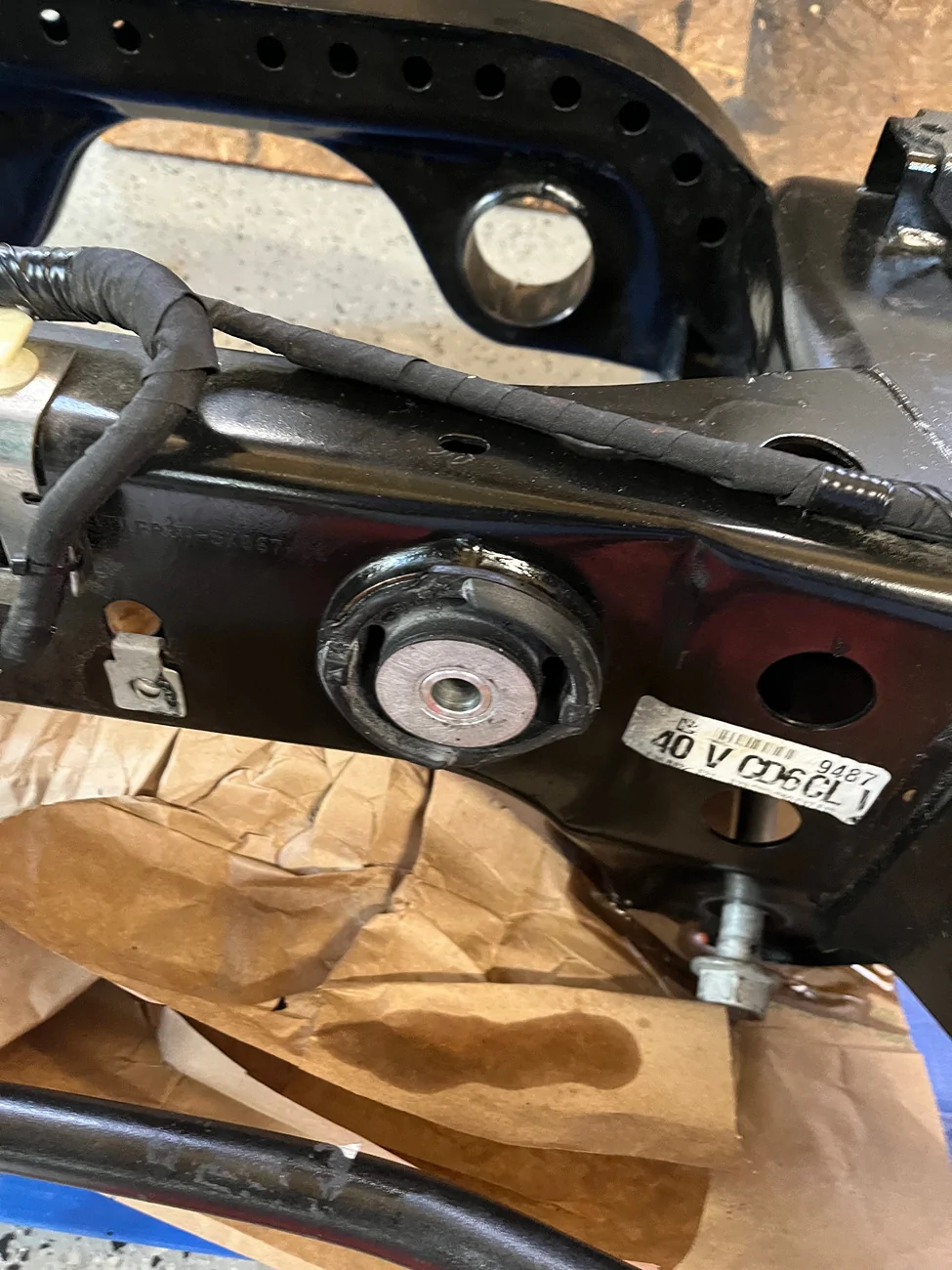

Bushings going in. Much easier than removal.

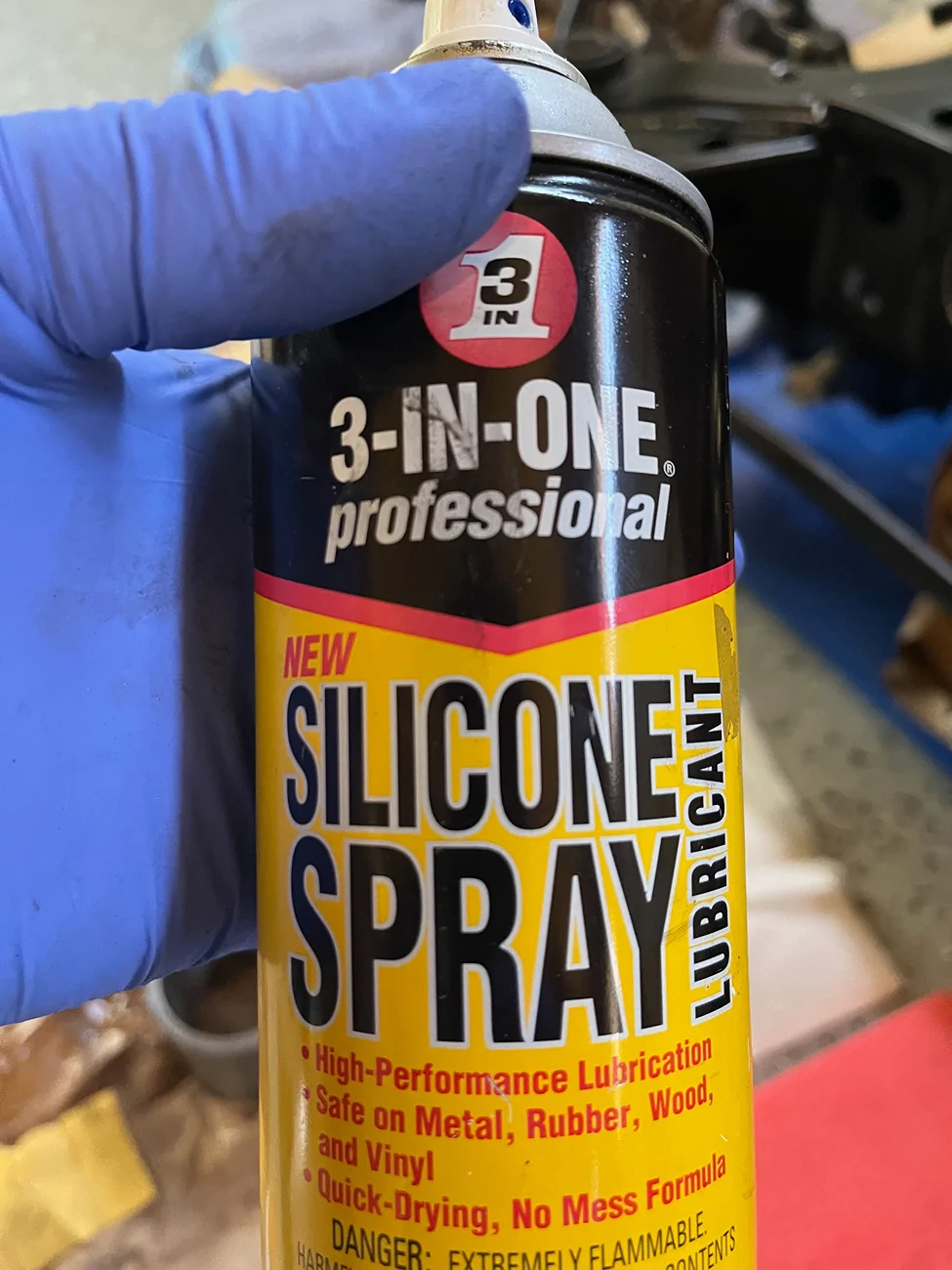

Couple of observations. Cleaned out each bore first with wire brush followed by 220 grit sandpaper by hand. Wipe clean and dry.
1) Used silicone spray in the bushing bore and liberally on the bushing.
2) White lithium grease on the threaded rod. Friction is not high so this is not absolute.
3) I didn't see the need to freeze the rubber bushings, plus it makes them stiff and less flexible. One step that I don't think is needed, unless for some reason you have super-tight interference fit.

Subframe is back in and torqued.
Was hoping I could replace the rear trailing arm bushings myself but my 12 Ton hydraulic press is not strong enough to push out the bushing. It only squeezes out a little bit of oil from the bottle jack and nothing else happens :(
I might take to machine shop on Monday unless someone has a sure-fire way to remove the bushings myself through some other method.

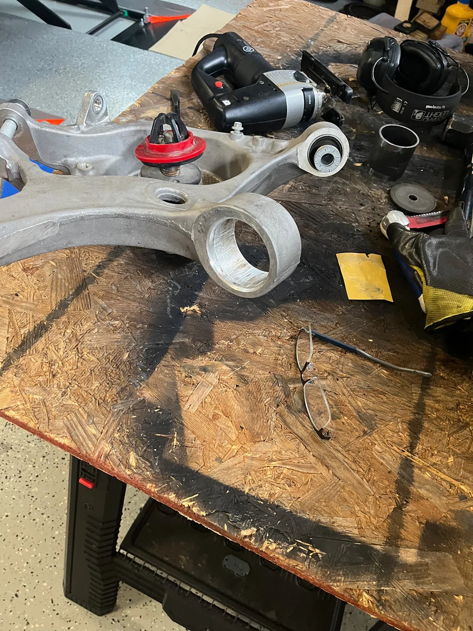

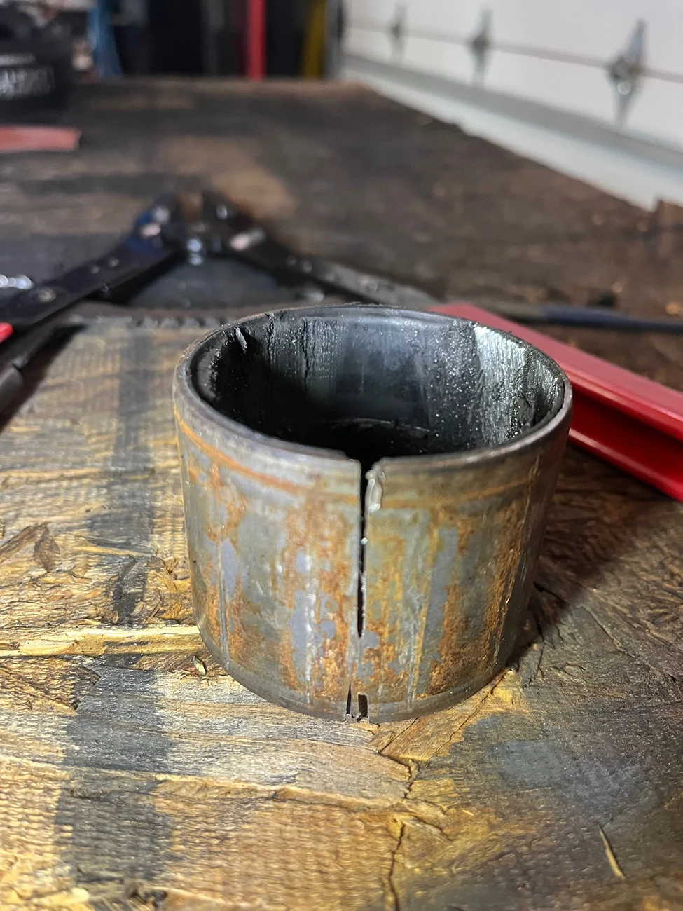

Tried using my press, even with upgraded 20T bottle jack, just got one "pop" and one of the bushings moved 1/8" and that's about it. So, back to the usual, cut out the rubber (boy the voids in those rear bushings are huge), this time used a jig saw with a long blade and used same, but with metal blade, for the metal sleeve. I'm still too cautious with cutting the sleeve, maybe if I do another car or two, I will feel comfortable just hacking all the way through the sleeve.

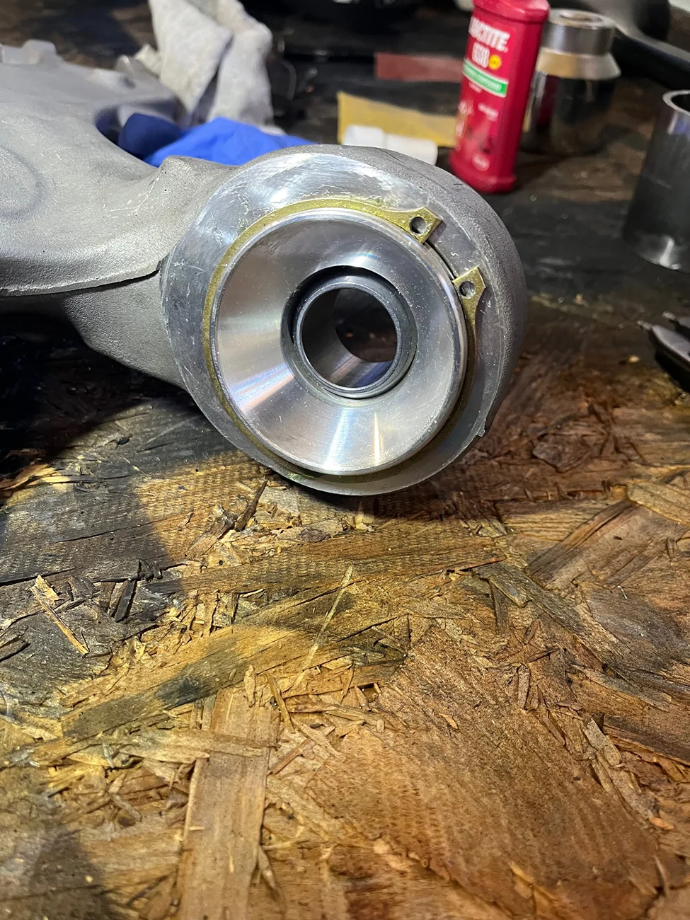

The rear pivot arm bearings, I did put in the freezer for about 8 hours, then cleaned the arms, applied high-strength sleeve retainer and pressed them in. No problem.

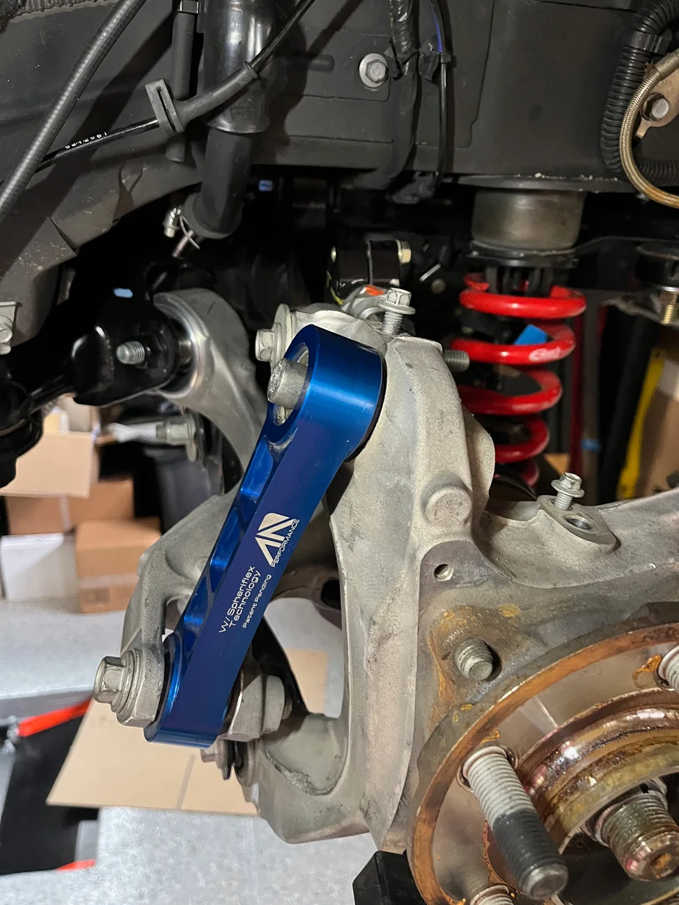

3) Waiting on Cortex racing rear toe arms, hopefully to arrive later this week. Have been running stock one since day one, but it loses its settings after 8-10 track events.
