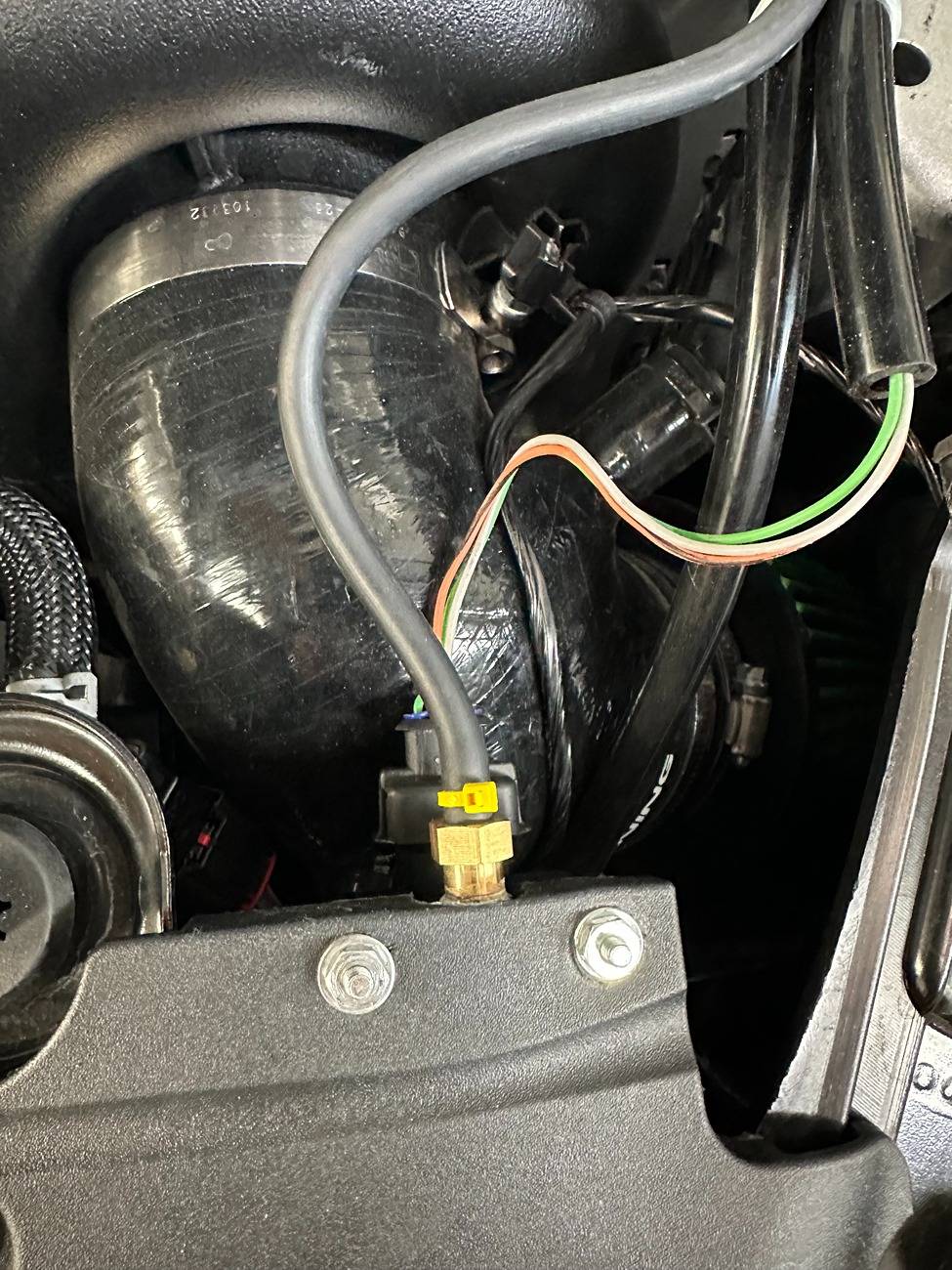

I installed my MAP sensor right next to my vacuum block, so that the vacuum tube was as short as possible. The kit comes with a wiring harness that is like 30 feet long, so it made sense to me to install the MAP sensor as close to the engine as possible, then run the harness back to the controller in the trunk.
I would always recommend using a vacuum block to distribute your boost/vacuum sources. Using T's in my opinion is not ideal.
Aside from setup, there really is no end user involvement. The controller is providing the power and ground to the MAP sensor and receives a 5-volt reference from it. The only adjustment you make is setting up the idle voltage going to the pumps. (Not really changing the voltage, but rather the pulsing or frequency. The controller is pulsing voltage to the pumps off and on thousands of times per second, so on a voltmeter, you see the average voltage). So, you turn the tiny dial on the controller while the engine is running so that your first pump is only seeing about 9 volts, and the second pump is seeing around 11 volts.

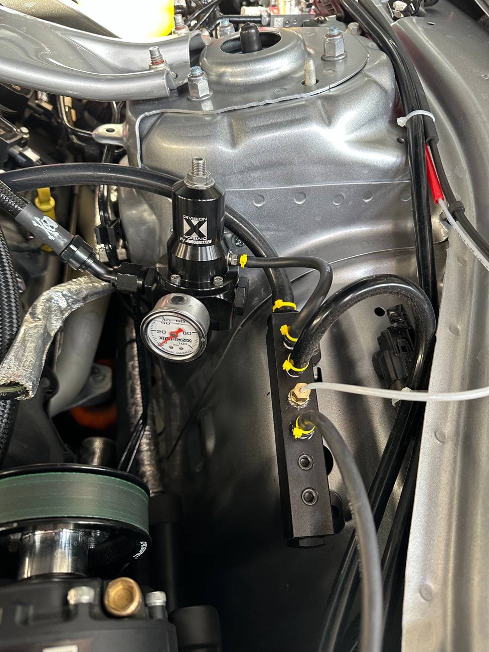

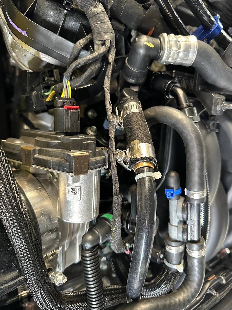

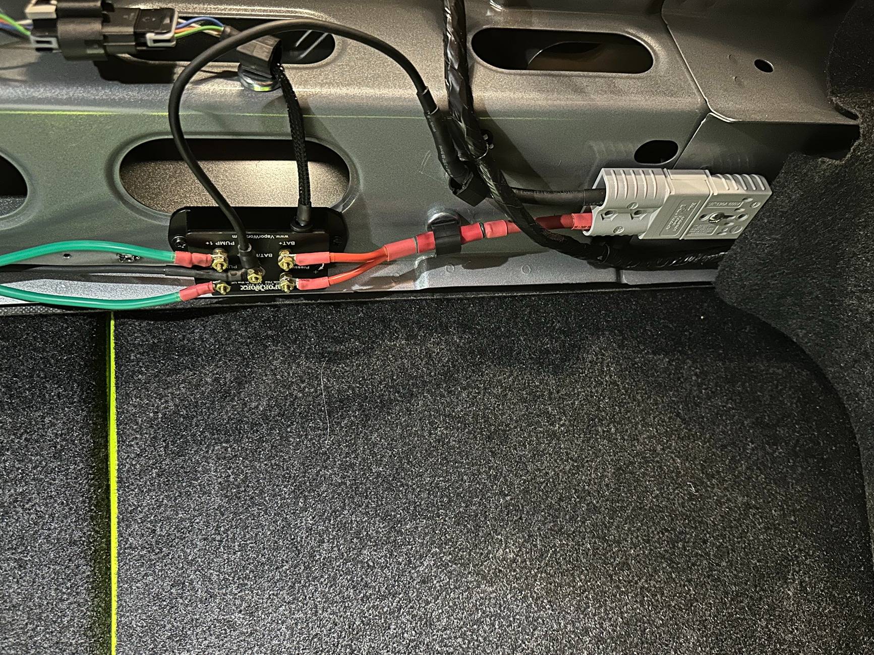

Here is how I have mine installed.

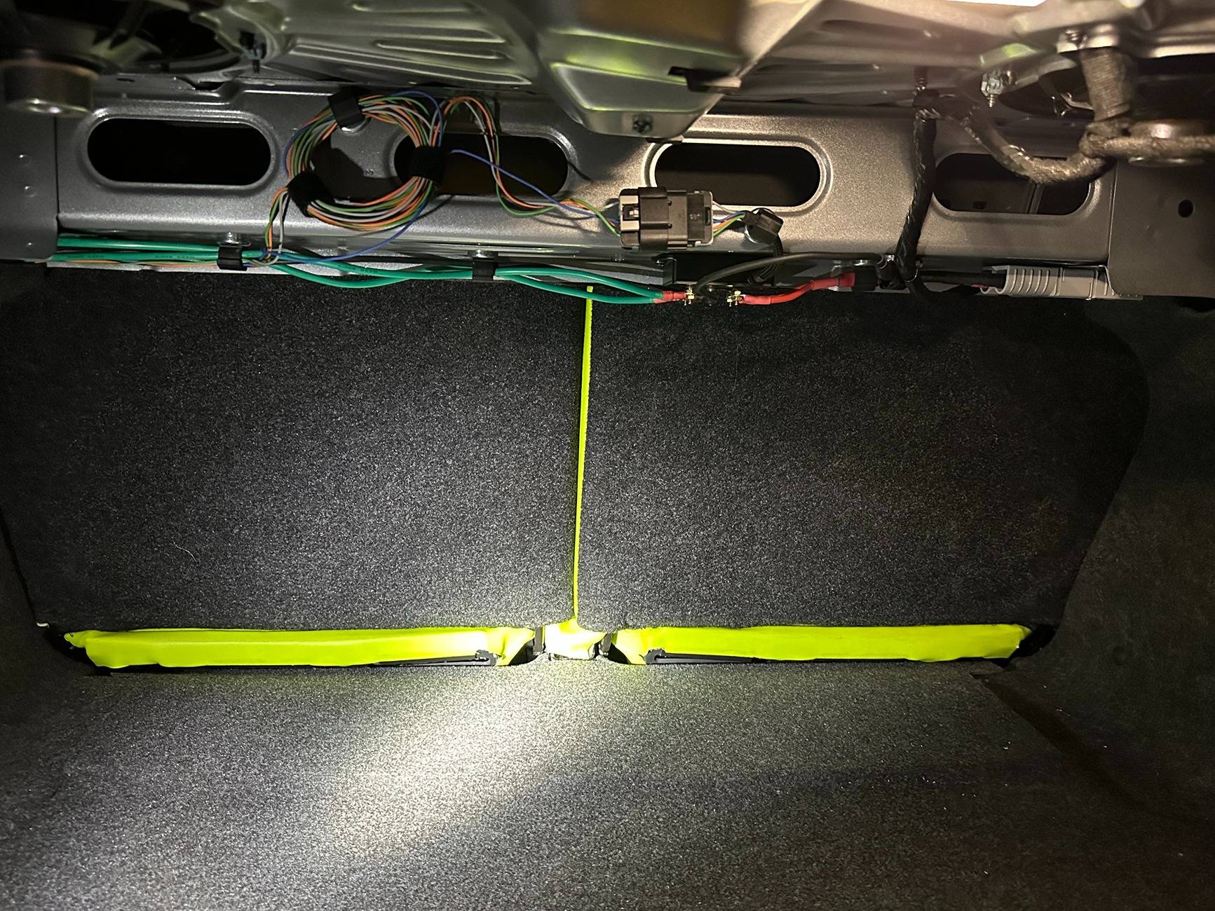

Now Im working on a cover for the controller and wiring. As you can see, these Vaporworx controllers have exposed terminals. I never have anything in the trunk, but you never know
Liquid electrical tape those terminals.
