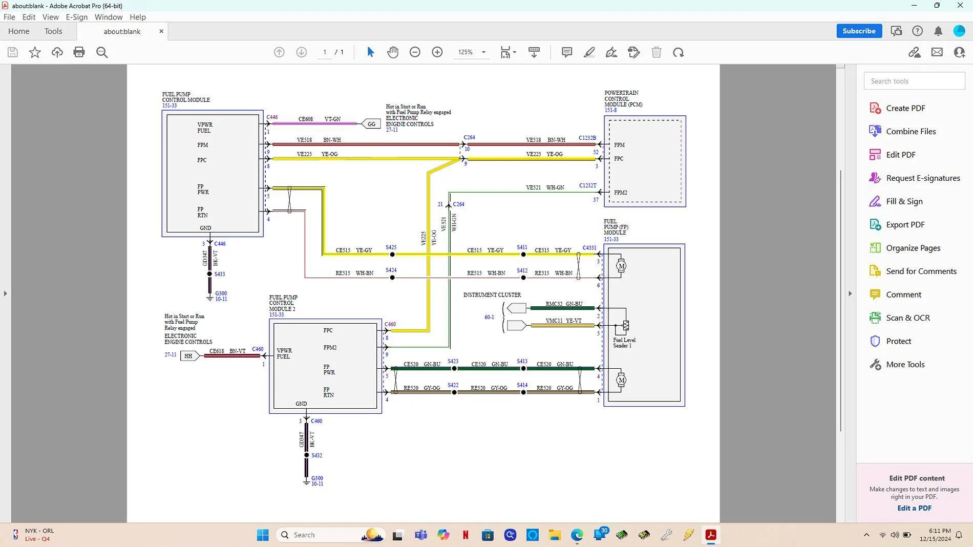

Very interesting thread here so I thought I would join in for the first time and attempt to contribute. Looks like to me based off the dual pump GT500 diagram that FPC (control) is the power side and FPM (monitor) is the ground side. Likely that Ford is using the ground to control PWM. The GT diagram is the same, just with a single FPCM. Would love to see a PWM controller option from VaporWorks.
I emailed those diagrams to Carl at VaporWorx on Thursday. He said he‘d Look into them and let me know what he comes up with. I’ll report back here with his response once he replies back to me.

Fpc is the control signal from the pcm. It can be 0-50% for speed control and discreet duty cycles above that to commands other things. Fpm is monitoring and its the diagnostics and status feedback to the pcm.

Sounds like power side control would make things easier for VaporWorx to give us a controller. Are you thinking that is the control side Mike?

Fpc is the control side, but if you’re running another controller off of the oem commands then you can choose to use either the fpc or the output to the pump as an input to a brushless or pwm controller.
