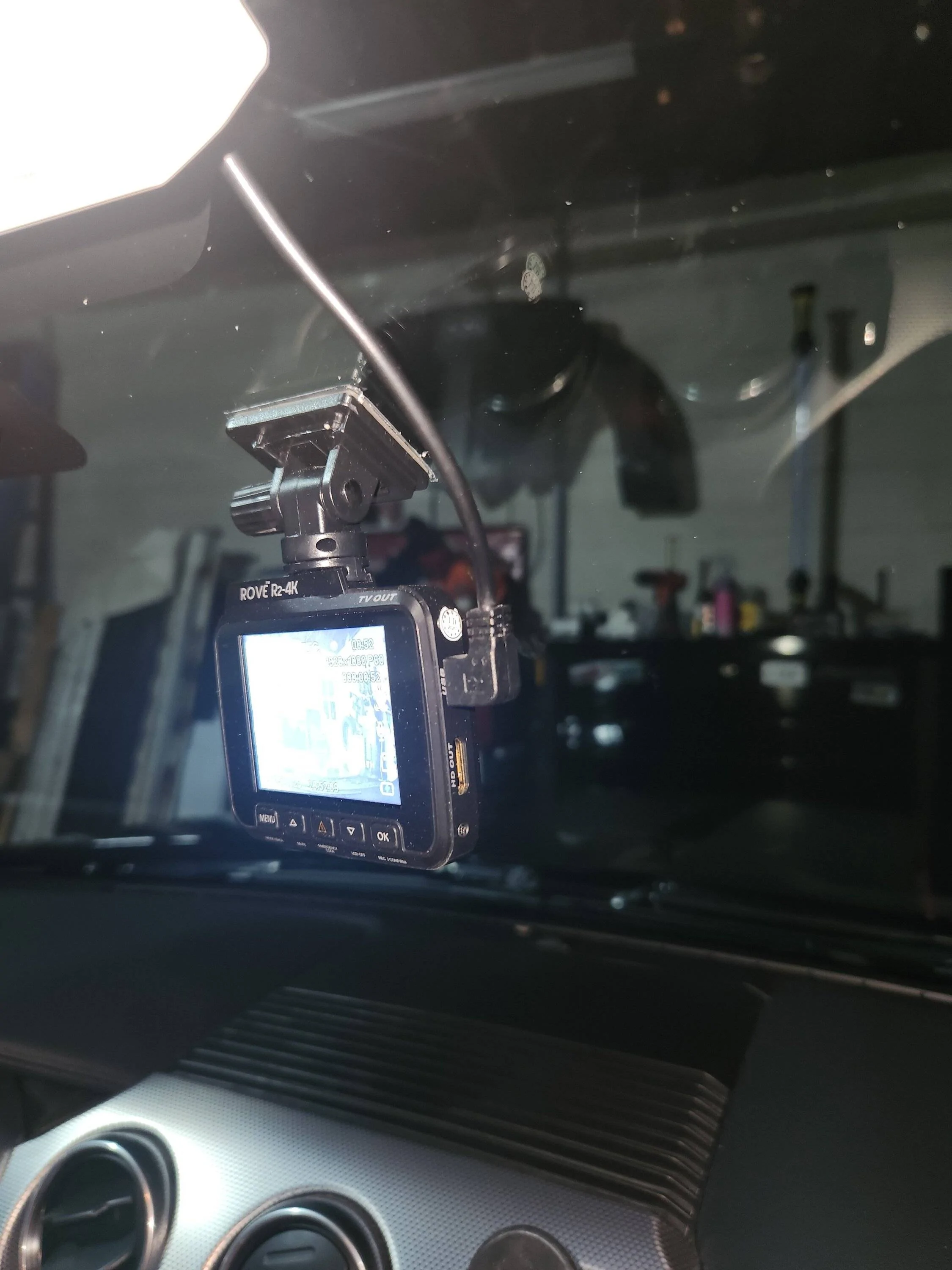

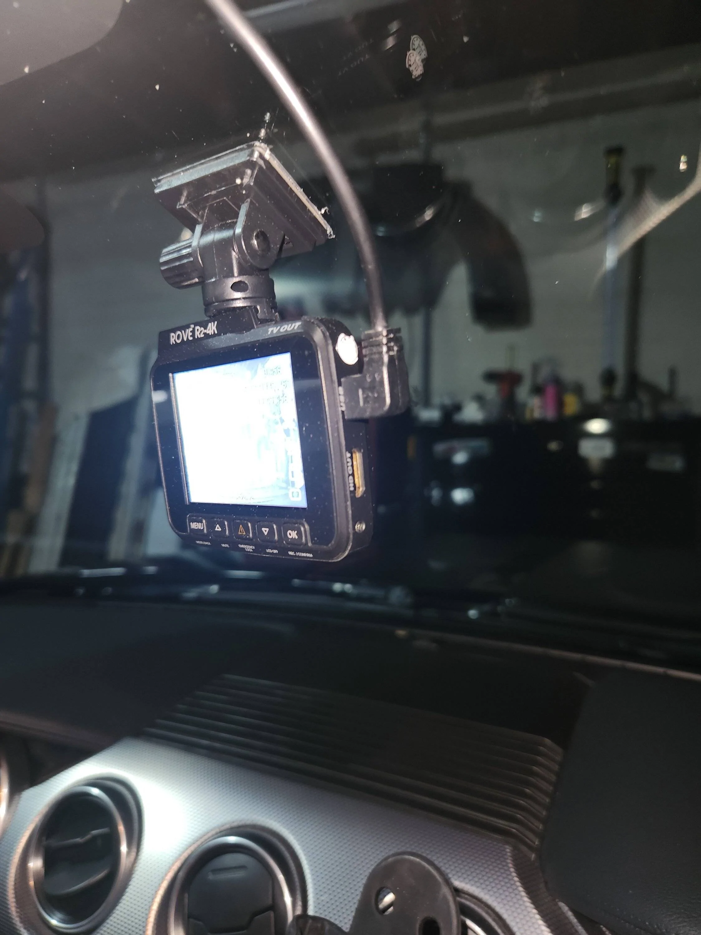

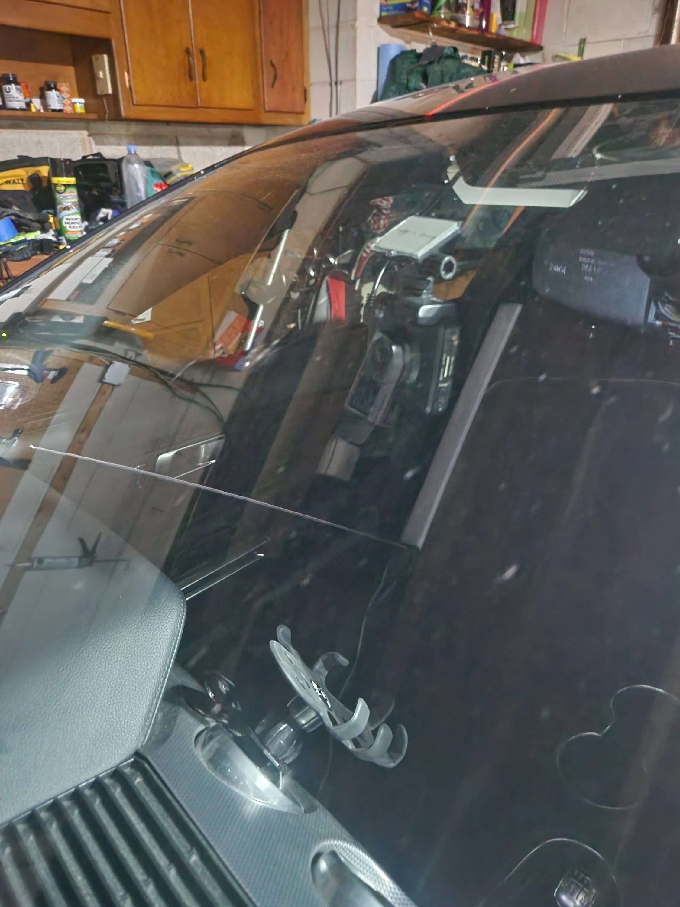

I have this Rov 4K camera I have had for 3+ years. I had it in my GT500 that I totaled with a hard wire kit. I intended to pull the kit before I sold the car, but I didn't so I ran the USB power wire in the 2018 GT, up into the headliner, down the drivers side A-pillar, in the dash and brought it out of the dash right above the Sync USB input. It powers up and down with the accessory power of the car. Nice easy set-up for the money.

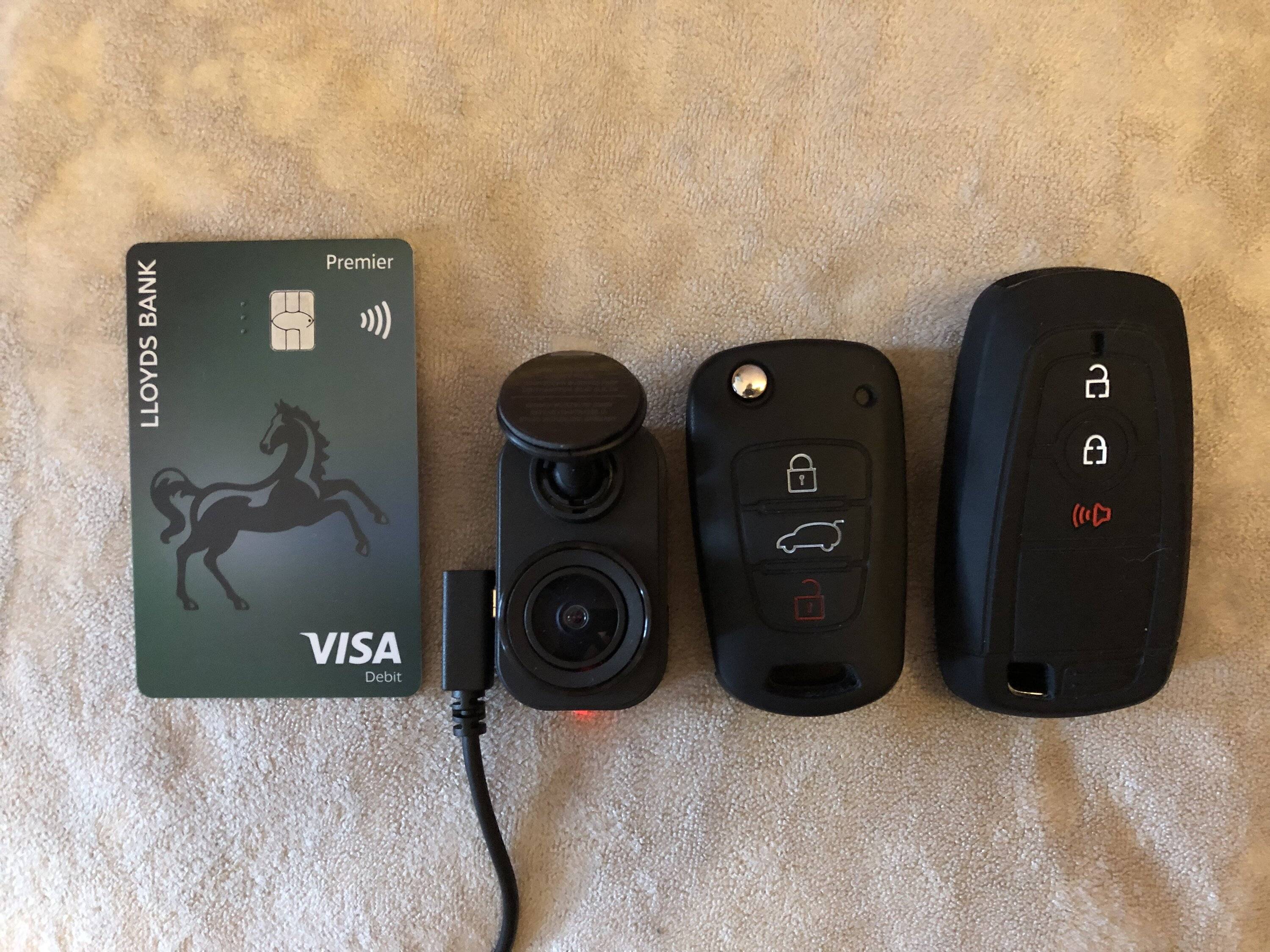

Same here (in the daily), but I thought the mini 2 is 1080 (or it is in the UK). That's kind of forgivable though given its dimensions and ability to hide/ blend in with other stuff. Mustang key on the right :
I powered mine from the Garmin OBD adaptor which can be set to keep it powered for 10 mins, 24 hours or permanently and it has protection in it to shut down if the car battery gets too low.

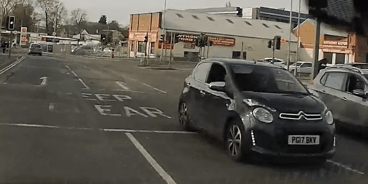

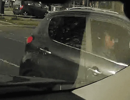

I posted this on the UK 'spotted' thread :
Clarity isn't the best, but good enough to pull reg plates / recognise cars / cover your arse in case of an incident etc :like:
Note - clarity actually looks better on the phone screen / when viewing footage - I wonder if something went on when I uploaded that photo ?
Zoomed in shot of a speeder, wrong side of the road, through a turning lane, almost jumping the lights - reg is easy to capture :
