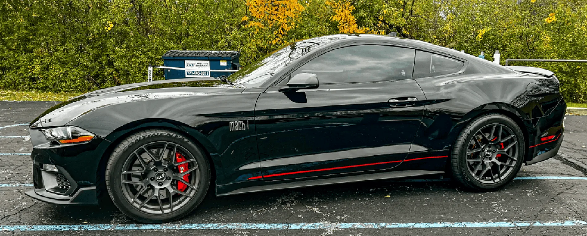

I think the diameter difference between the 285/35 26.9 “and 275/40 27.7”
Split that difference in half and that’s the additional finder gap
Wouldn’t the additional width moving the tire out a little offset that fender gap:
Here’s my current setup with 275/40 19” DWS’s squared.
