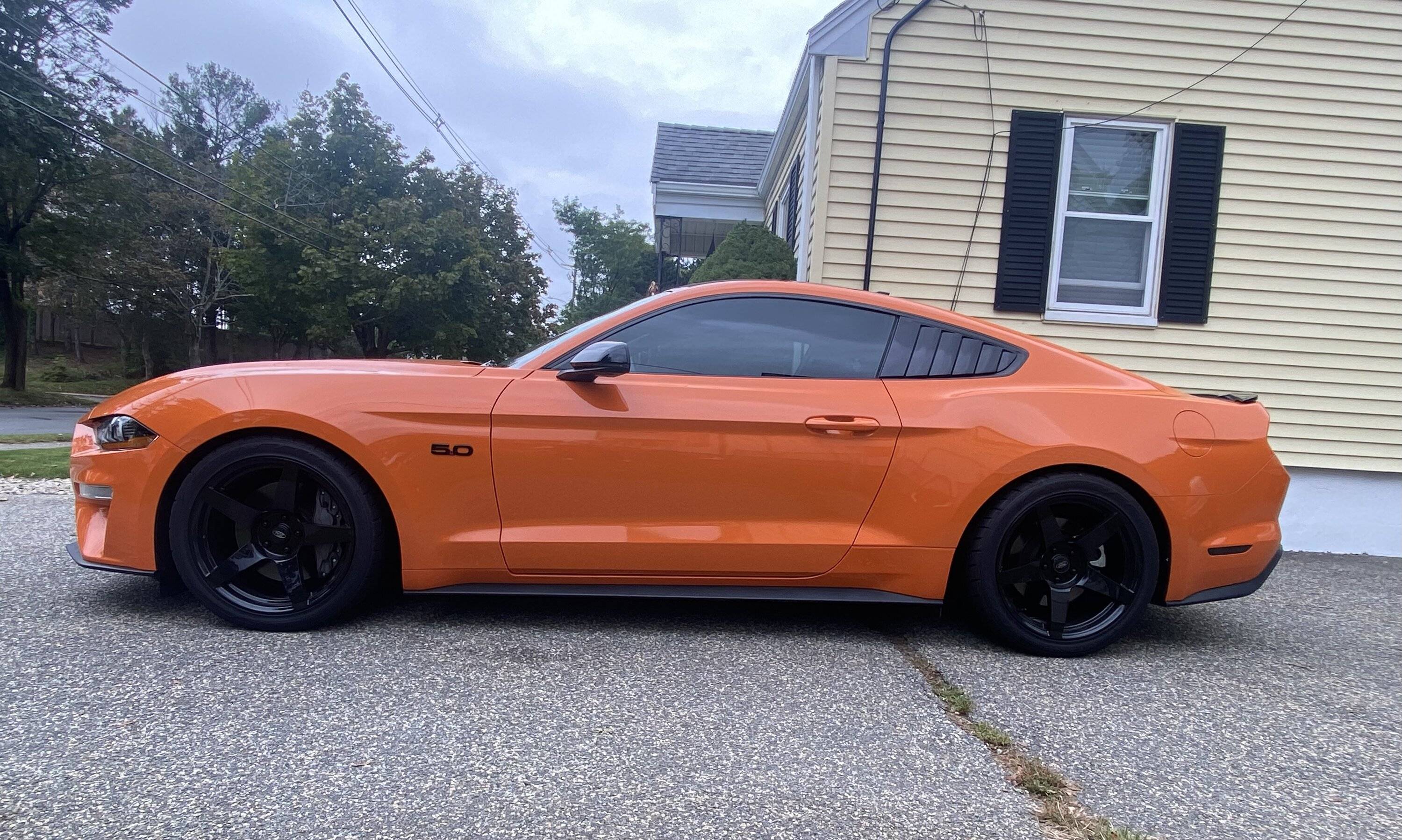

I'm running 285/35/19 square on my DD ...heres a few pics if this helps....before & after lowerd on Steeda minimum drop springs.
Before being lowered
After being lowered
Thanks! Car looks great now!!
So there is a huge gap with the 285's .. What was it originally , 235's or PP setup?

Yeah it is…that’s why I went with Minimum drop…picked up a 1/2 -3/4 inch…perfect IMO …I also did the Steeda Pro-Active shocks /struts.
Cool, I'm not going to lower the Mach so I need to be careful with this wheel gap

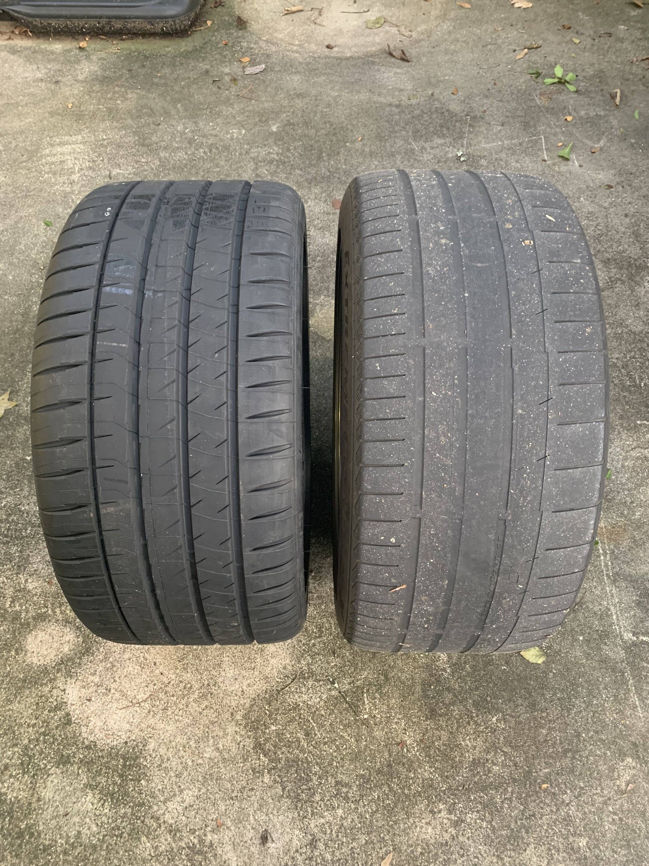

Just a visual comparison…new 285/35 on left, worn out 275/40on right.
