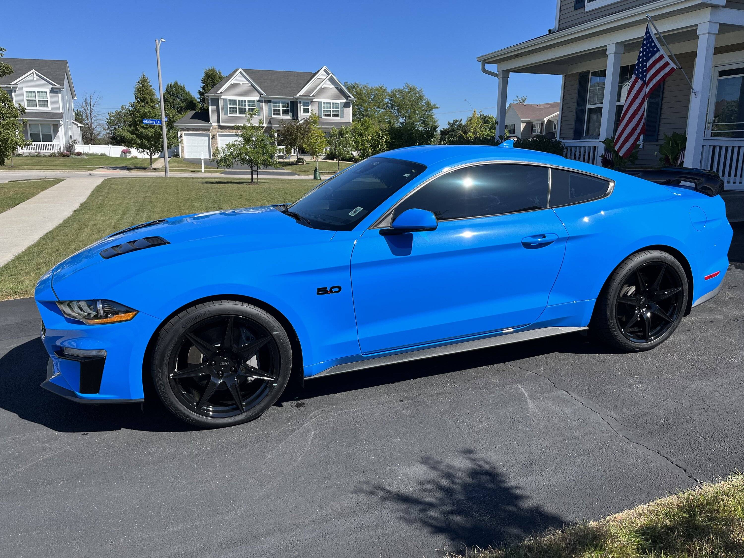

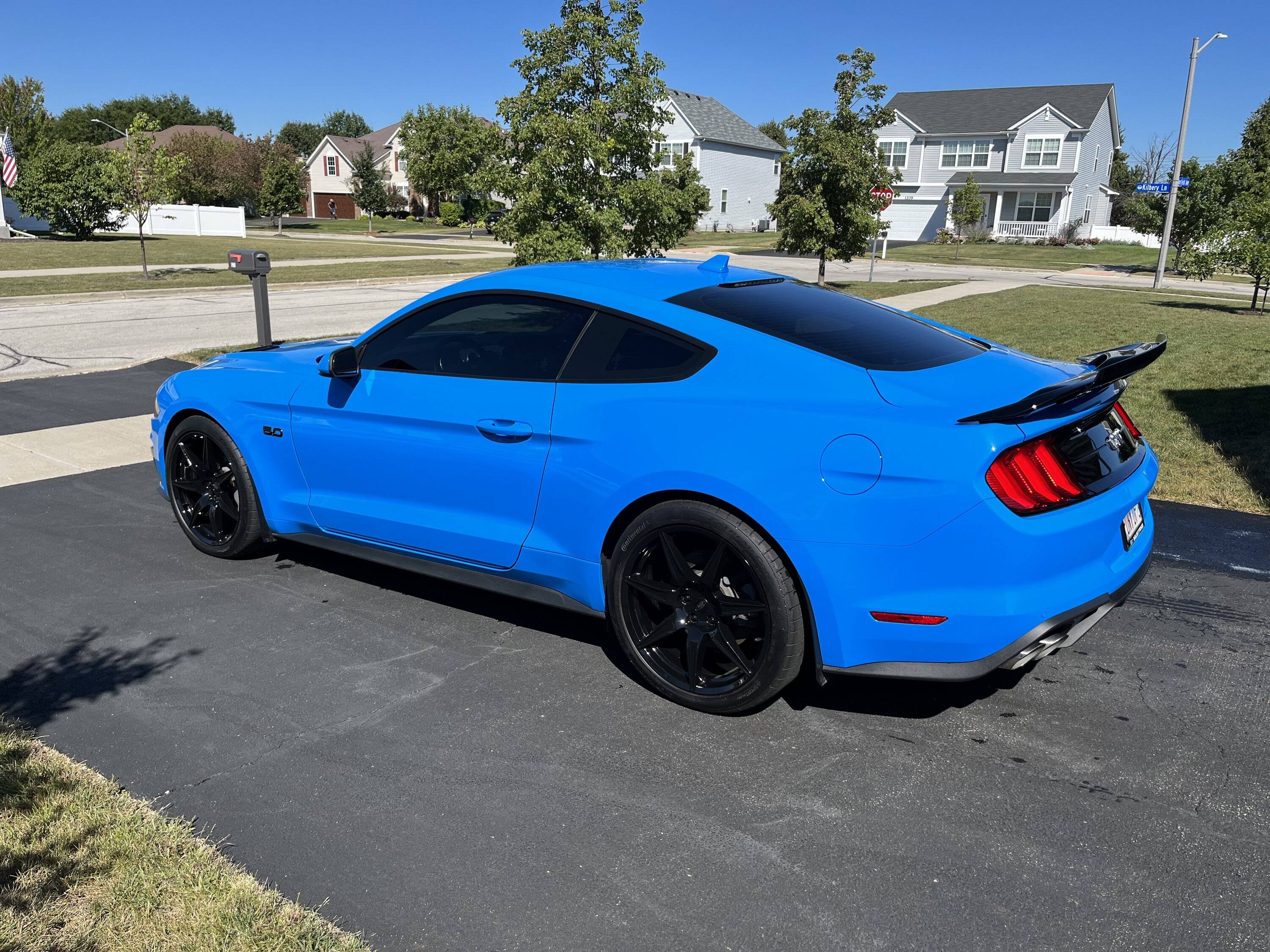

That is my pic in my avatar.
It's too cold to bring the car out today, but the fitment is absolutely perfect after the suspension has settled.
275/40R19 will fill the wheel well out just a bit better if you have no intention of doing any suspension mods (famous last words lol).
You do have some gapage going there.. did you notice difference when you put them on?
Im in a Mach 1 so may be a little different.
I remember more gap in my 15gt

Are you lowered?
The car you quoted is lowered, he has BMR SP083R in his sig. That's roughly a 7/8" drop front and 3/4" drop rear.

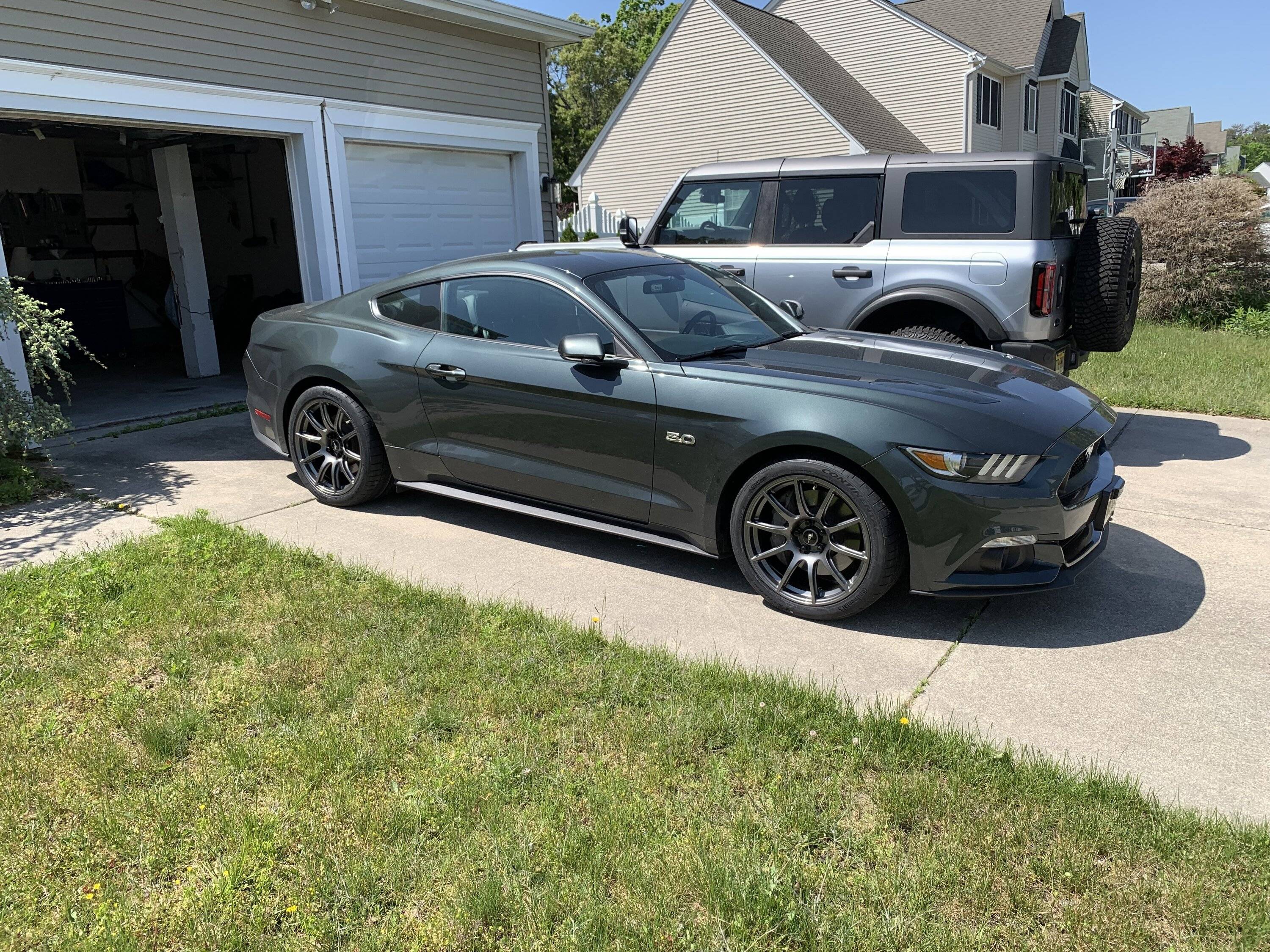

Do you have any pics of the 285’s fender gaps before suspension upgrades?
Now I’m starting to get worried as this was my plan this summer
I'm running 285/35/19 square on my DD ...heres a few pics if this helps....before & after lowerd on Steeda minimum drop springs.
Before being lowered
After being lowered
After being lowered
that gap is crazy on stock springs

285/35R19 with 0.5-1" drop really is the bees knees.
I think for stock 275/40R19 is really gonna fill it out better.
