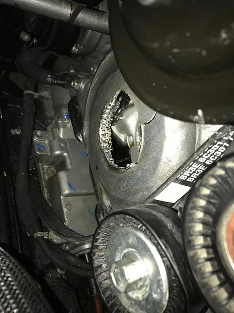

I do not buy that. I think it would throw the belts if the balancer was not on all the way. What do you think caused the one inthe thread below to break?
http://www.mustang6g.com/forums/showthread.php?p=1975687#post1975687
Keep in mind that the balancer will be going on straight but not completely. It won't wobble to through belts but will be slightly misaligned which can show up as a belt squeal but not always though. If the balancer is only a few thousandths from the timing gear it will allow the crank snout to wobble in operation and potentially break it.
I'd like to see pics of that crank. It's interesting to hear that it broke lengthwise. Not sure just where it broke until we get pics.

Mine has a crack that follows the key, but impossible to know which came first

My guess is it was impacted on and the install bolt bottomed out. A few too many ugga duggas will do that. Wouldn't be the first time I've seen a balancer installed that way.

Anything can happen to any engine stock or modified. Things just happen and it sucks. I however honestly believe it's installer error 99% of the time.

I'm not going to say for sure Op failure was install error, if I was a betting man I'd guess that though.

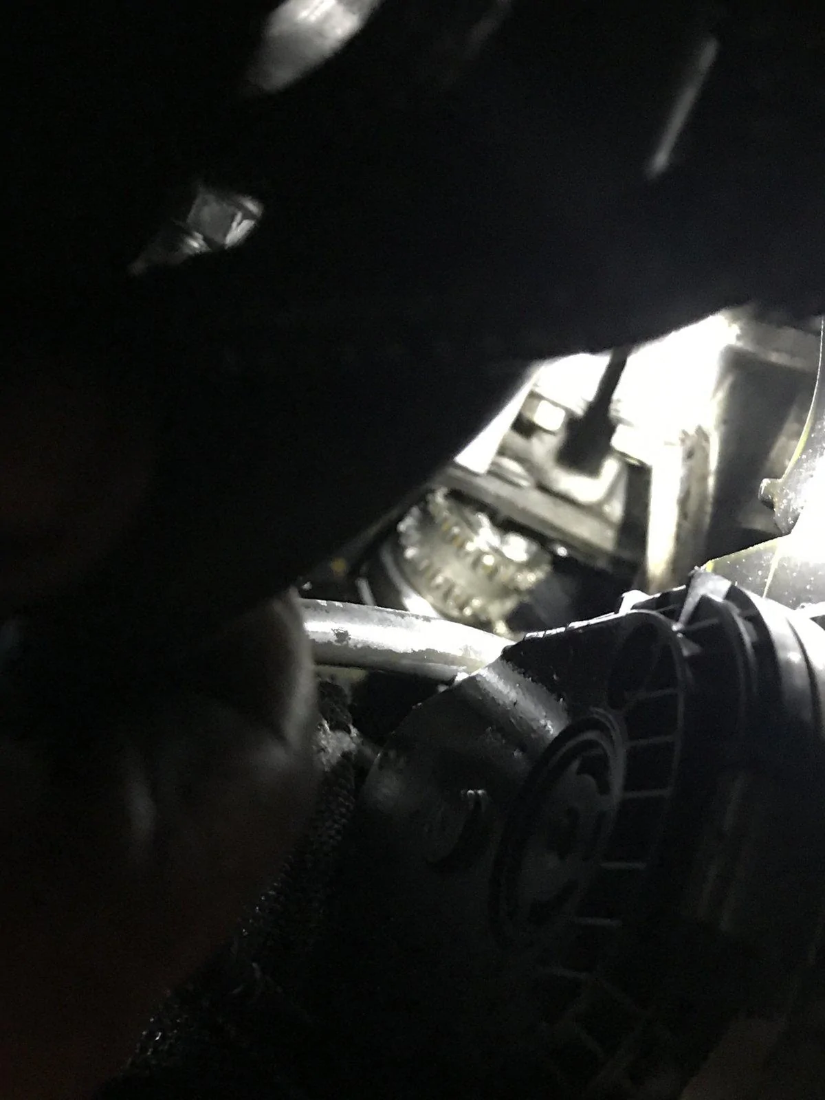

I can’t believe my luck with these cars ....but crank snapped yesterday in my Hellion TT.
Expensive motor too (MMR sleeved 5.2 /GT 350 heads). Also had an ATI balancer .
May be I jinxed my self by having a spare motor (at least I will have minimal downtime- no racing till April anyway )
Buddy is going to pick up car this weekend along with “spares “ .
Keeping it simple this time
I was able to salvage some parts from a previous failed motor (not this one obviously) so “spare” build was relatively cheaper .BES sleeved 5.0/stock GT heads and cams /18 intake
He will be doing the R&R . I am keeping my fingers crossed I can scavenge some parts to build a another spare but not holding my breath .
That’s why I have to get out of this hobby ....one more year and hope I keep my shirt .
Or rebuild and run !

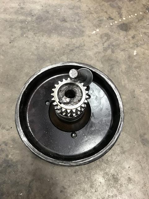

Are the OPG, CS and ATI balancer warranty-able?
It had an ARP crank bolt. Installer used red loctite and torqued it down per spec.
Yep. It's been on the car about 1500 miles as well with many WOT pulls.
I figure if it was installed incorrectly it would have went a long while ago?
Won't be able to get the motor out for another week or so to really know what all needs replacing. I just don't want to throw in a new motor and it happens again. I'm unsure how to try to prevent this from happening, especially when I already had the parts which I thought would prevent.
Debating on a sleeved block and just going turbo... but that of course is a huge expense all at once.
Here's a couple more pics...
Sell that setup and go turbo. Much easier on parts. Make more power on less boost and its free power. Don't need to worry about breaking your crank. Get a used motor, or fix this one, then put a turbo kit on it. Let us know if we can help.

On the twin its got to be balancer related. Either it wasn't seated correctly or a fracture happened during the install I would think.
