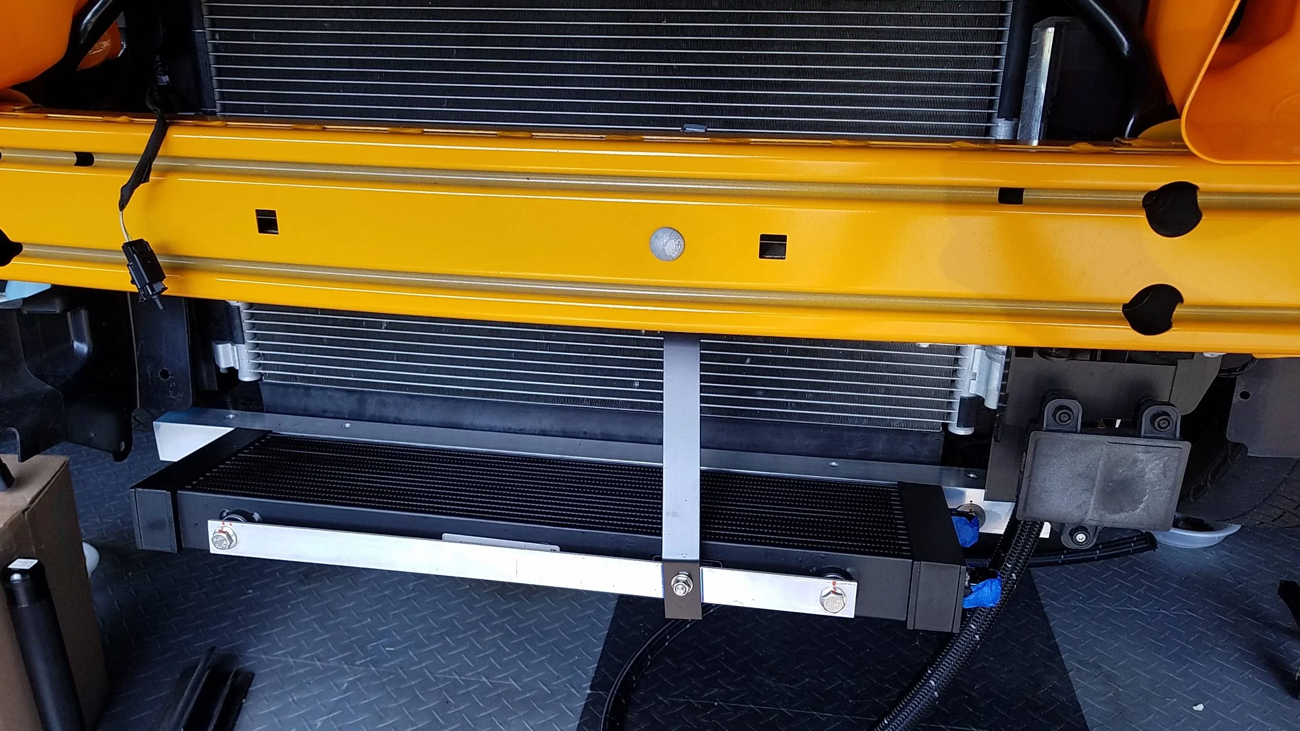

Have a look at my solution here.

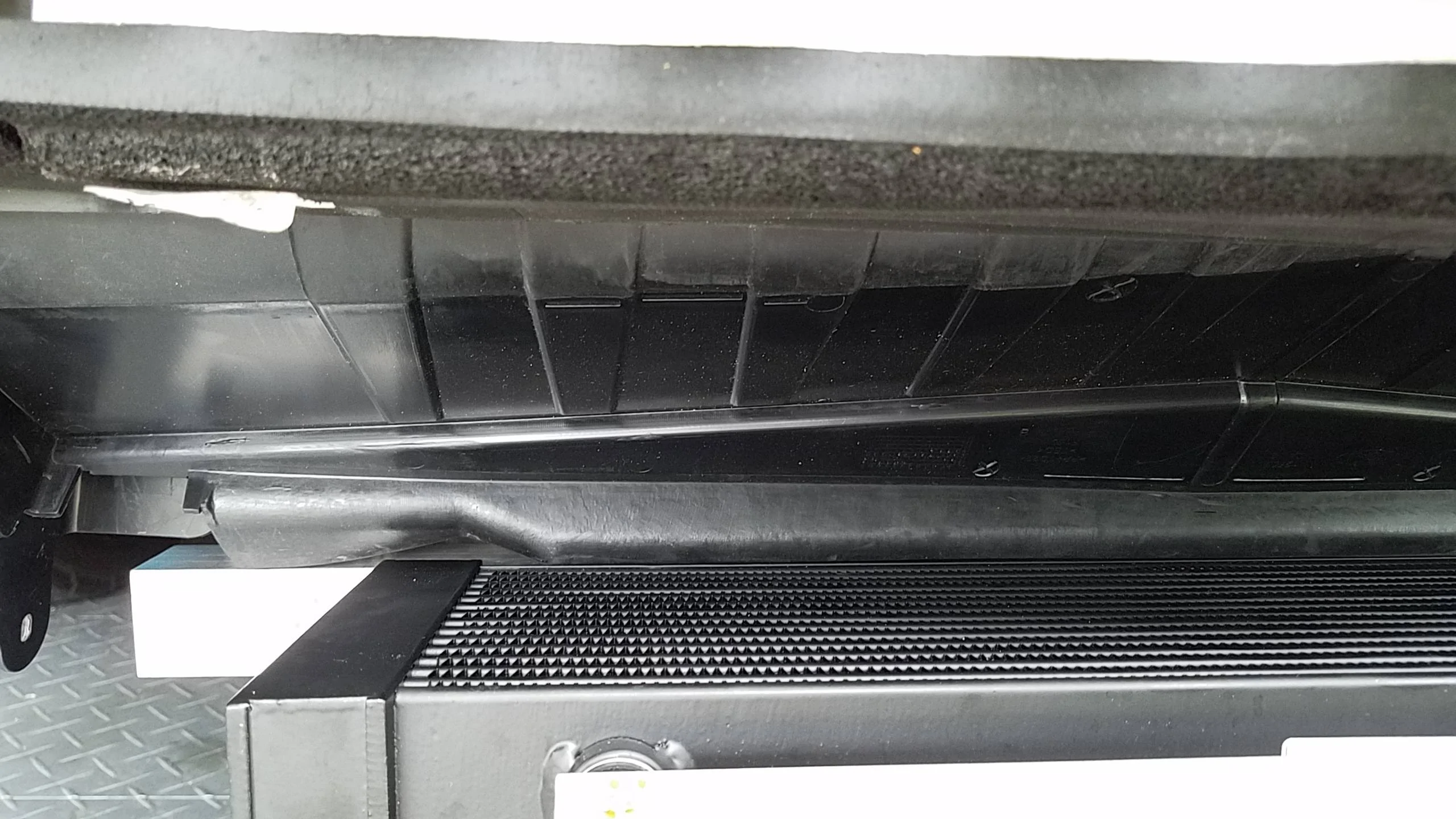

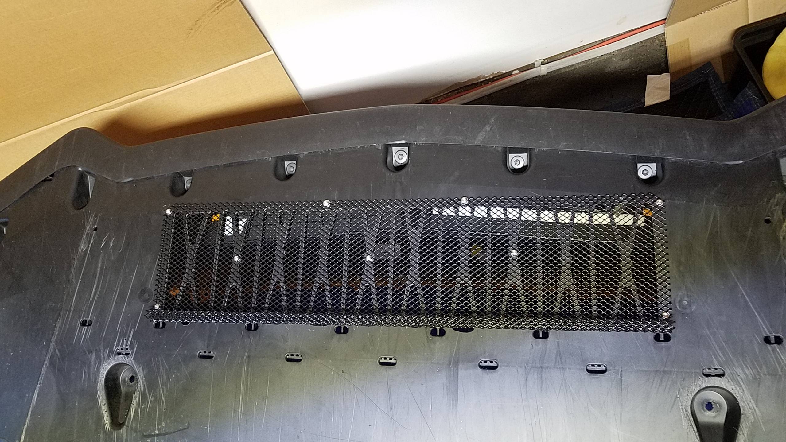

  • I ventilated my belly pan, and I positioned the horizontal cooler less that 1/2" above it. It is tipped up 5 degrees from the frame rails - this matches the 5* angle of the belly pan.
  • I repurposed the big plastic flap that lays on the belly pan to be an air diverter. I tipped it up so that the leading edge is at the crash bar, and the trailing edge is on top of the back end of the cooler. This diverts all air entering the lower grille through the new oil cooler.
  • I kept the OEM oil/water cooler, and put a Setrab sandwich plate on top of it. There is still room for the big Ford FL820s oil filter to be swapped with oil changes.
  • I opened up every single cell in both grilles. I used a router on the backside of the removed grilles.
  • I even removed the grille pony, and then used 6-32 screws and inserts to make it removable during track day conversions.
  • I chose the Setrab Pro Line cooler over the SLM version (Harrop) because it has a little higher cooling for ~same physical size, and chose the 2-pass so as to put both ports on the driver's side.
  • Only 3 brackets are needed, and made from aluminum stock from the local Ace HW.
CHT now runs steady at 228F, even to 30 minute sessions at 85 ambient. (w/ PP larger radiator.)
I cannot stress enough that I believe the OEM oil/water cooler should be retained. It helps, and I am not worried about failure. I'll bet this combo has around 90kBTU cooling.
The horizontal mount does not block the radiator/condenser, and it has forced air as described.
Front end risk is more with parking curbs, etc, than an off at the track. Note there is at least 7" ground clearance at the front splitter.
If I were do it over, the only changes I would make are to use the new billet Setrab sandwich plate with pre-drilled side port (for optional oil temp gauge), -10AN lines (instead of -12AN), and Setrab 22mm/10AN 90deg elbows (instead of 22/10 adapters).
If anyone wants, I can provide a shopping cart listing all the parts needed to make this kit. (Small donation welcome, lol.) And/or I can fab the brackets needed for you.
More photos at the link above.

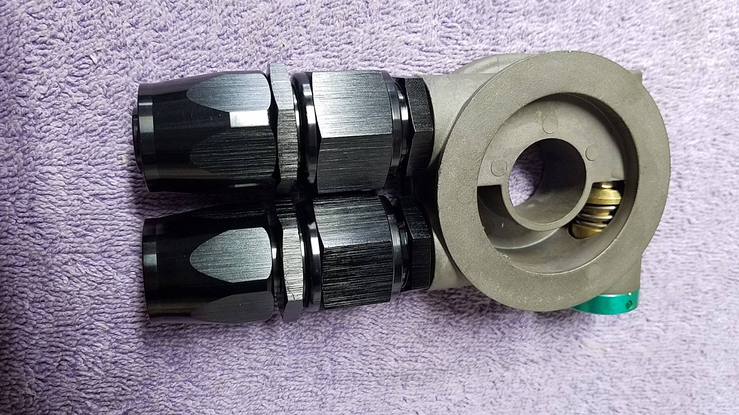

Wouldn't you want to keep the -12An lines? Bigger lines means less pressure drop. Less pressure drop means happier engine.
Yes, true. It's only 5ft total run. The channels in the cooler are pretty small. Setrab applications guy thought even 10AN was plenty.
Could be because of the space constraints
Exactly. The bends to go under sway bar etc are tricky. Space is very tight right around the sandwich plate.
Plus the new billet plate has the two ports too close for 12AN. And that's another reason to choose Setrab 22mm/10AN 90 elbows bc it's more compact.

Found a photo of my cast Setrab plate and -12AN adapter on the 22mm adapters. The ports are even closer together on their new billet plate.
That is tight!!!!

That means no air for the radiator from lower grille though, right? Do you have pictures of the "diverter" installed by any chance? Also, any concerns with dumping all that air under the front of the car?
Correct.
Not concerned, because as someone else already pointed out, the high-speed ambient air rushes under the belly pan, and will take the hot air with it. I should think that the oil cooler air comes out someone slow due to all the fins.
Aero could be rebalanced with a bigger or 2nd splitter. But as also pointed out by someone, I agree that aero under 100mph is not really active, and the tracks we visit rarely have a 100mph turn.
Here is a not-so-good photo of the OEM plastic shield, raised up to the crash bar.
