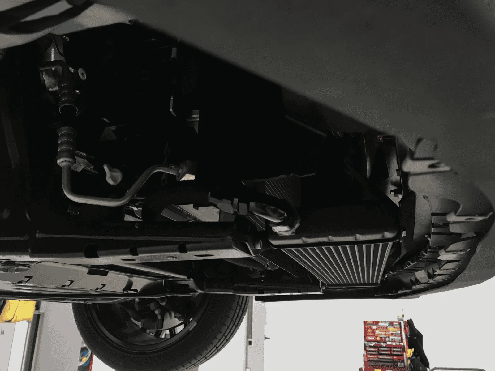

I don't quite get how that flat mounted cooler would get any airflow, especially sitting tight up against the undertray? If it was all open underneath I get, but 1) how does the airflow going through the lower grill make a 90* turn downwards to get through the cooler? And 2) where does it go after going through the cooler when it hits a literal wall in the underbelly pan?
I found pictures of it in another thread here just a min ago: https://www.mustang6g.com/forums/th...t-hand-experiences.90359/page-30#post-2405221
I was kind of wondering the same thing, especially if you have a secondary (PP2-style) or larger splitter.
The Mishi design is self-explanatory but would pass some heat to the rad.

This picture right here tells it all. It literally sits on the underbelly, so there's nowhere for the airflow to go but backwards into the cooler. Almost like you should cut out a small rectangle in the underbelly to match the cooler and give the air a clear path to escape, but then not sure how that would affect overall airflow since there would be air under the car that might get drawn in and up or mess with the airflow going down through the cooler.
There is way more air going through the grill than can go through the radiator ( it’s why ducting the radiator increase cooling) therefore some of this air go downward and through the cooler
There is about a 2” gap between the bottom of the cooler and the undertray and the undertray is not sealed at all so no problem for the air to escape
I also believe that the air flowing underneath the car has a higher velocity than the air flowing through the grille and cooler and therefore there is a low pressure that suck the air escaping from the undertray
I have an oil temperature gauge with the sensor mounted in the out (from the engine) line to the cooler and the maximum temperature i ever saw, track day in 100* + weather, pushing the car on 305 squared nt01, was 260*
