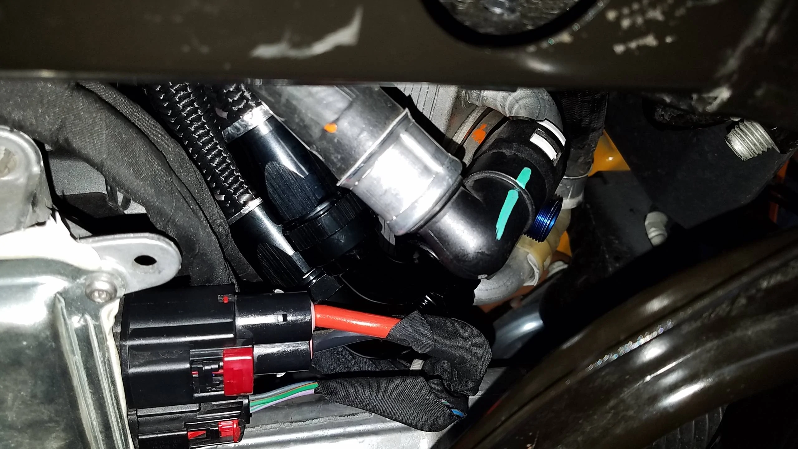

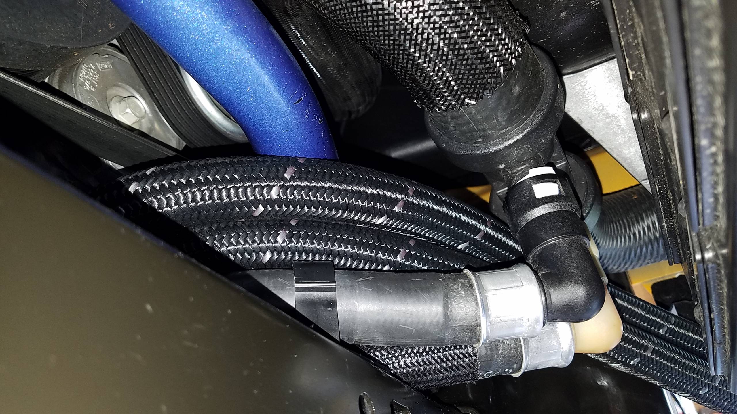

Here are those fat hoses. Now can you see why I would go -10AN and Setrab elbows next time?
Don’t your sway bar make contact with the oil lines when going through the suspension travel ?
It’s already tight on mine without the water hoses and their plastic bracket on the cross member

Yes, true. It's only 5ft total run. The channels in the cooler are pretty small. Setrab applications guy thought even 10AN was plenty.
Exactly. The bends to go under sway bar etc are tricky. Space is very tight right around the sandwich plate.
Plus the new billet plate has the two ports too close for 12AN. And that's another reason to choose Setrab 18mm/10AN 90 elbows bc it's more compact.
-12an on the cast setrab plate is tight but fits. And at least with coilovers my -12 lines fit under the sway bar (sitting on the subframe) without being pinched.
Ford performance recommends -12.

Yeah I know. It's my setup too. I would just step down to -10AN and the new plate if I did it over again. Would make the whole install go easier.
My cht remains steady at 228F.
