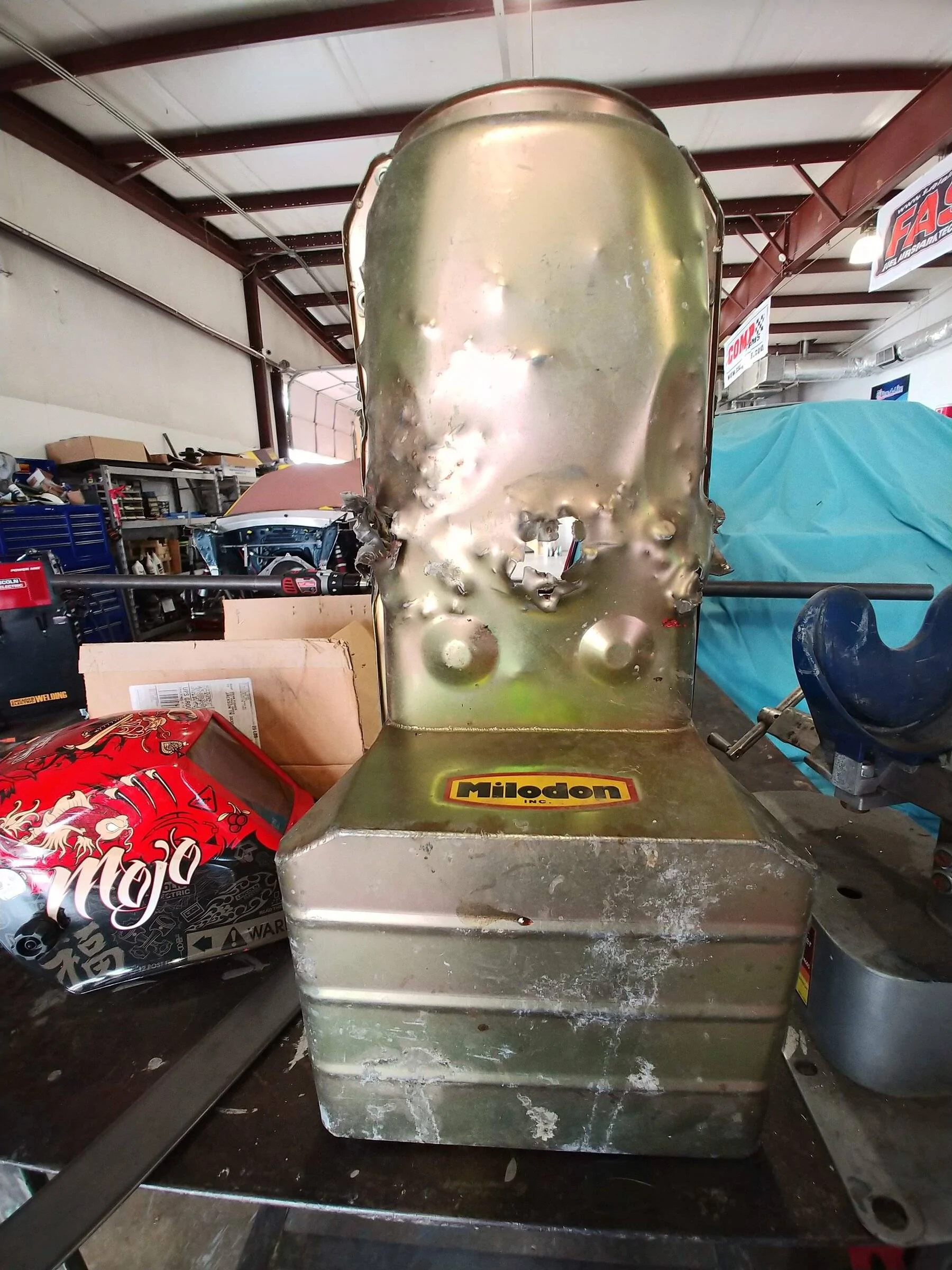

.Here is a pic of some carnage,496 BBC,Eagle Rods went to 9900 RPM and let go (our fault)
The rod took out the block,cam,lifters,a few valves .....what a mess....
I saved the heads and rest of the upper end and made a 565 after this mess.

I cannot state how much I hate eagle and all their cheap products, for budget concerns use SCAT, after that just save and start buying quality components. I like Carillo but it has its place, same as any part. But that pic isn't as bad as some of the ones I've come across, sometimes its component failure, but a lot of times I've found out its the "builders" fault for not doing the proper checks and procedures when assembling and machining the parts.
The rod did not break because of a flaw,we over revved the engine,9900 RPM is too much to ask
of any steel rod w that stroke (transmission was the culprit)
I dont see Scat as much different than Eagle or Manley.. If I have to buy a steel rod I would not hesitate to try them again

Steel rods can handle that rpm, again Pro Stock does it every time, some are aluminum and some are steel rod engines, eagle rods cannot handle that rpm. For that kind of rpm you are looking at a I-beam rod and not a H-beam and it definitely won't be in that price range of eagle.
