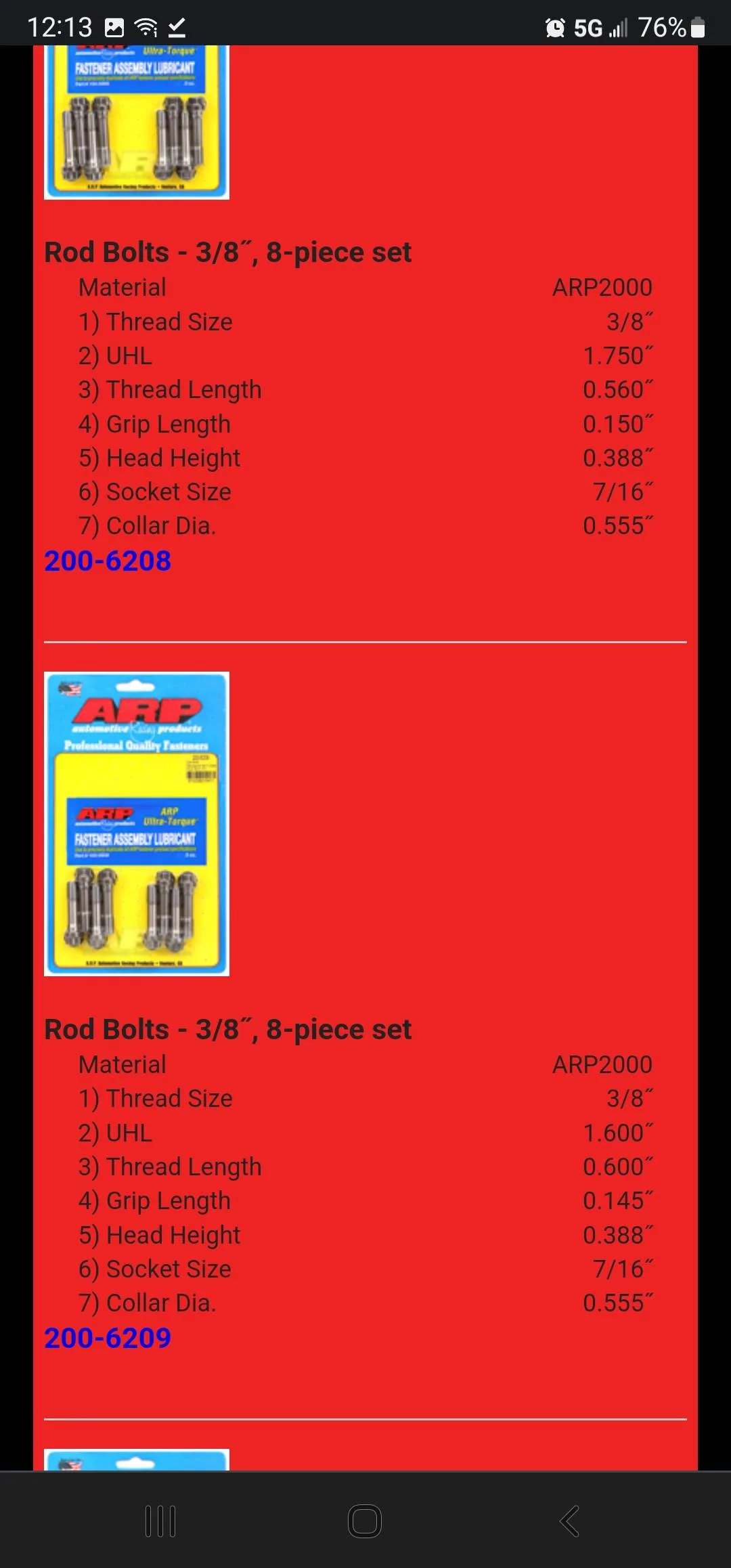

That is a likely situation. The rod bolt itself is for sure 3/8 thread, with a 7/16 bolt head. Very common for arp to do this.

Yep. To make things more confusing, I just dove down a rabbit hole about ARP 2000 3/8" rod bolts and the fact that some of them have been documented as requiring 85-100 lb/ft to achieve .0060 bolt stretch. Bolt stretch is the real measure you want to achieve when putting rods together, not some arbitrary torque wrench value.
