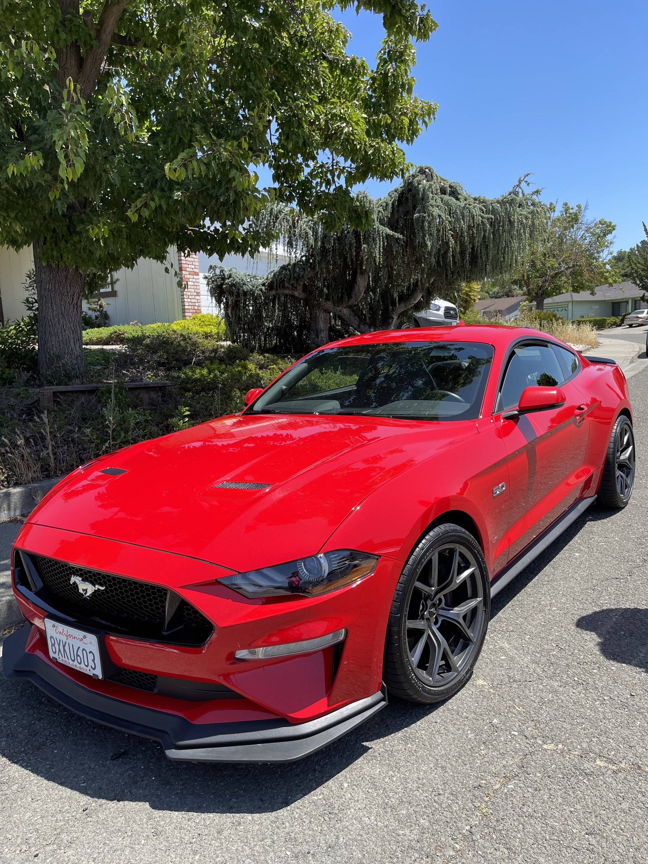

He got the car. She's a beauty. He has 30 days to return it and the clutch will be covered as part of the Carmax warranty since it was pointed out prior to sale.
Now we gotta find him a set of daily driver wheels. The PP2 wheels are kinda extreme with their huge sizing and super soft compound.
For the money, this was an incredible deal.

I’ve always liked those wheels :sunglasses:
What rubber is on them though ?

Bridgestone Potenza RE050A. The tires are brand new. I'm not familiar with this tire or how long they last but we'll find him a set of PP wheels with 255/40-19s or something along those lines.
These would work as daily wheels with 275/40-19s on both front and rear (same size as my Bullitt rear). That'd be more comfortable and you could get touring tires in that size but the fronts stick out too far IMO. Need to remove that imaginary 1" wheel spacer up front. šŸ˜†
Sonny
Don't get performance pack wheels. They are heavy and pain to clean (and IMO not that great looking). I'd recommend looking at lmr.com. You can get a set of lightweight 19x10 replicas of the pp2 that can be rotated for improved tire wear...and they don't poke out like the factory wheels.
Why would you buy a 2nd set of wheels & tires? Your dad would be missing the entire point to driving a PP2 car, and what gives it it's performance.
Just drive it as it is, there's nothing "extreme" about the wheels & tires. They're the OEM/standard PP2 wheels, and the tires are not a "super soft compound". The Bridgestones are actually a harder compound than what came on the car from the factory.
