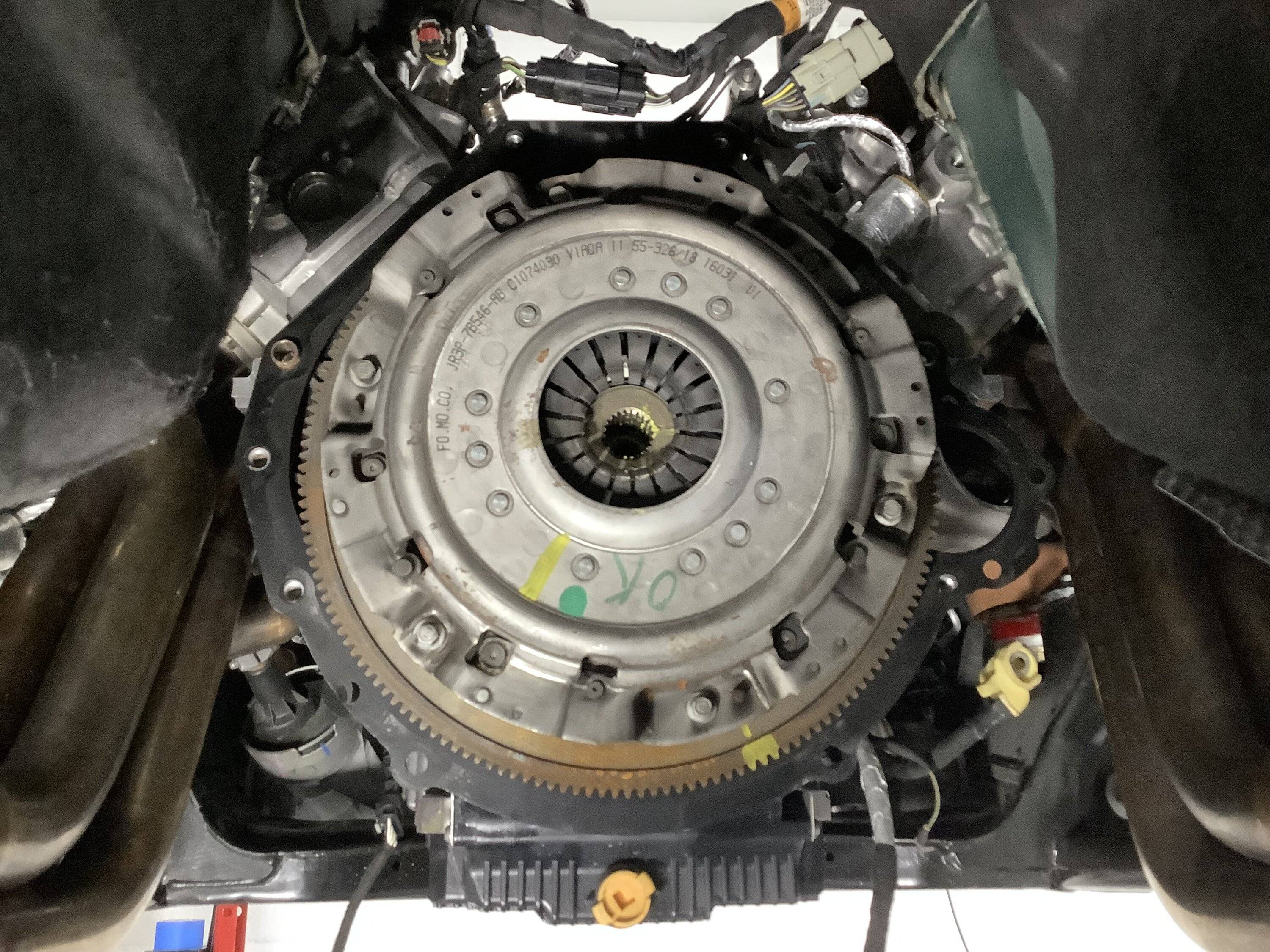

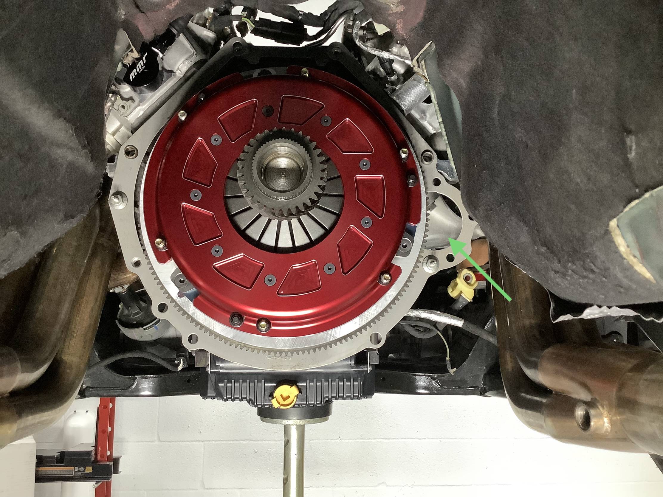

Is there any easy way to tell if it's aftermarket or stock? There's nothing in the Carfax about the clutch being replaced but it could have been done in the previous owner's garage.
Sonny
The easiest way to check for an aftermarket clutch is to pull the starter and use an inspection mirror to look inside the bellhousing (identified by the green arrow). You’ll be able to see if there is a different clutch pressure plate (they usually come in various colors) and flywheel assembly. The factory clutch assembly will look like the second pic.
