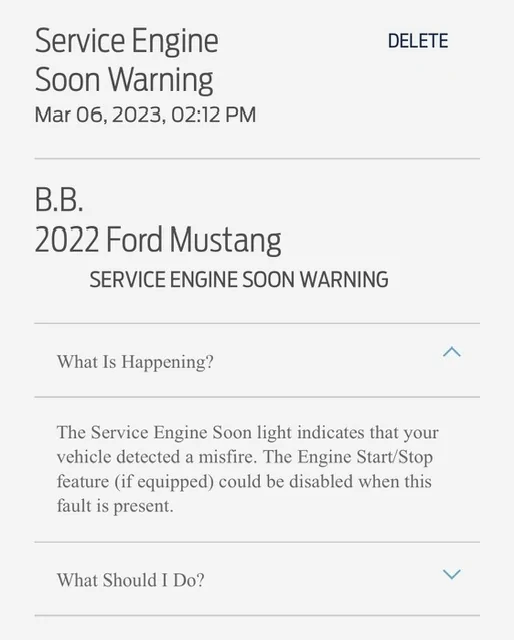

Sooooo.... When I got home and settled I opened Ford Pass on my phone to see if it could shed any light on the problem and lo and behold the answer was right there!
The message was "The Service Soon Light indicates that your vehicle encountered a misfire" and it went on to instruct me to drive carefully with no rapid acceleration or deceleration until I could get it serviced at a dealership or some such wording.

I just had this EXACT same thing happen about 30 minutes ago. Accelerating on the on ramp, felt a weird shudder for a second or two, and noticed the engine light blinking on my dash before it went off about 30 seconds later. I checked Fordpass and it had the same “service engine soon” alert and mentioned the engine misfire.

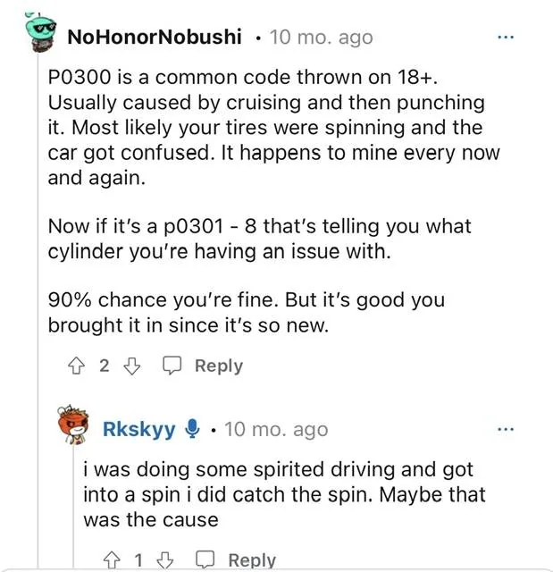

I made an appointment to take her in on the 22nd but also stopped by my local auto store to see if they’d be able to pull any codes for me to research. Nothing came up on their OBD reader and she’s not had any issues since, so I honestly think she was just being temperamental lol 🤷‍♀️ I also read this and believe this may be exactly what happened with me, as my wheels spun out before I felt the shudder and had the CEL flash:
