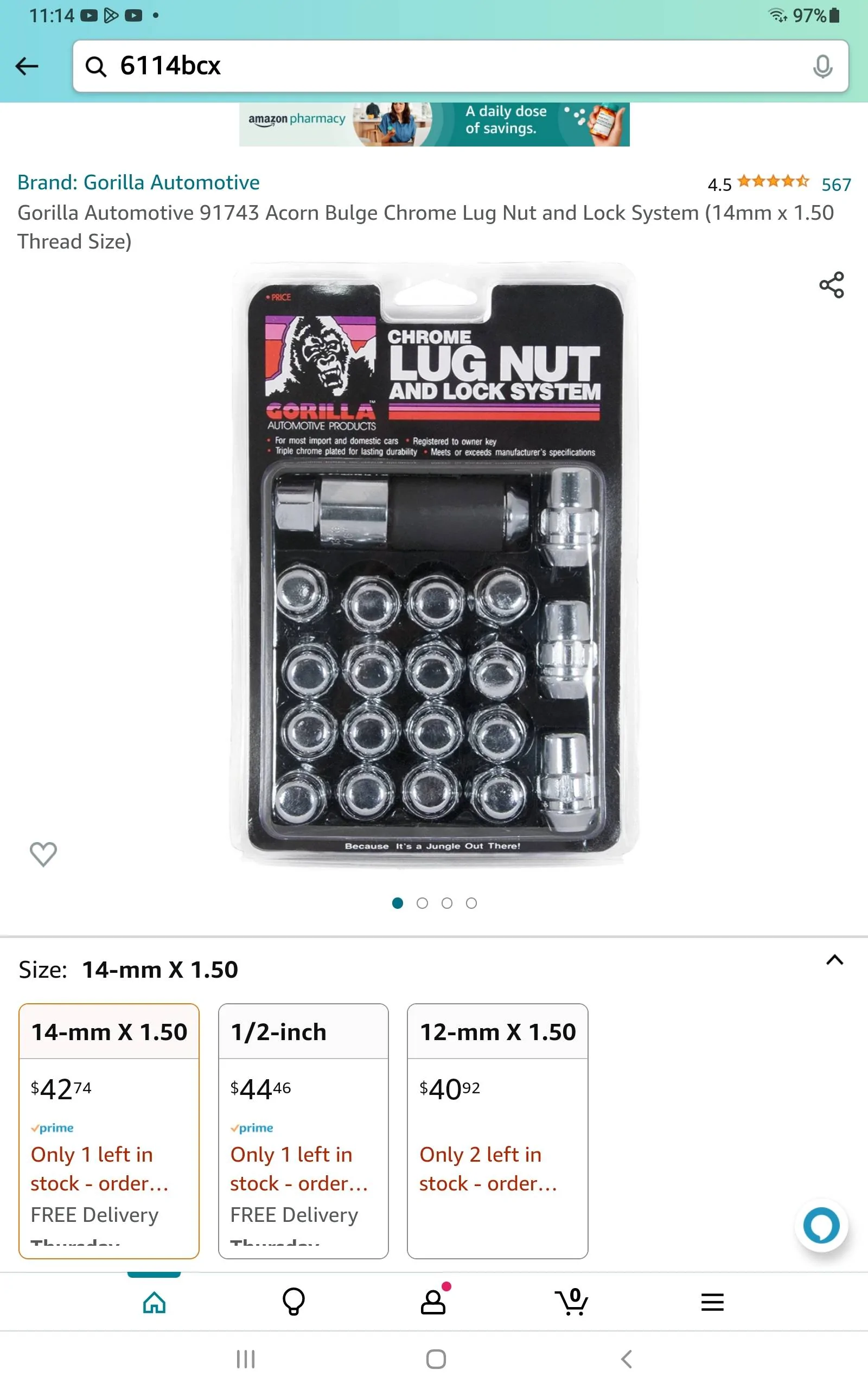

Wasn't really all that hard to find, at least the lock style. I've got a similar set in black on my car for at least 2 years and they still look new.
