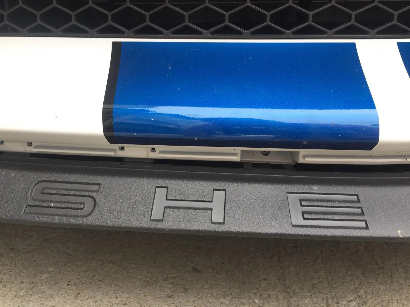

I had a good friend at Ford fix this for me while fixing another guy's mess from a recent oil change. Finally no gap and it feels good to look down there again.

Took delivery of my 2017 GT350 today. Did not know about or notice the splitter today when taking delivery. Got home and noticed mine was exactly like the one pictured above. Of course the dealership is 2 hours away. I called them and they insisted it was installed properly but I can take it to my local dealership to be fixed under warranty. WTF???

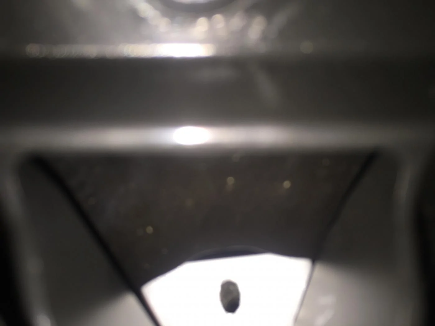

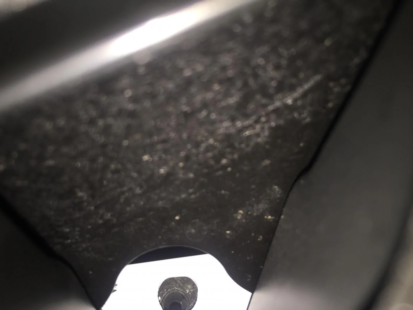

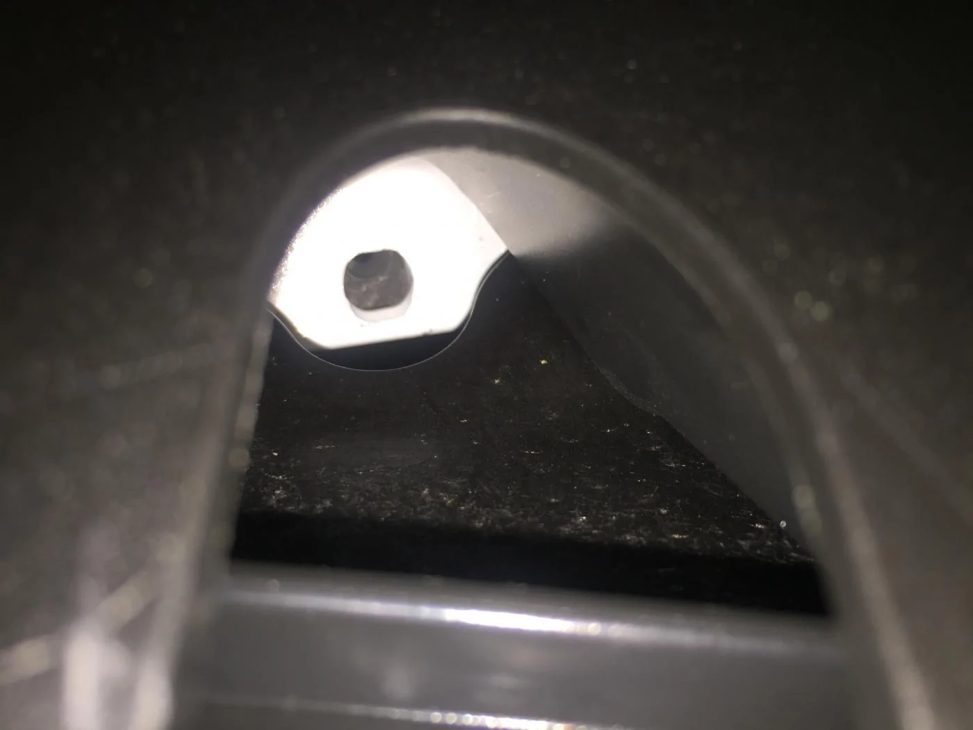

I had time to get under there today and took a few pics. None of the 4 screws that go in at the 45 degree angle are there nor are that any tool marks from them ever being installed. I did the rubber mallet and shop towel trick and knocked it into submission. Headed to dealership now to seek a proper install.

Good on ya for taking a look. Yours isn't the first (by a long shot) that we've seen where they left out fasteners, including the "45 degree" screws (probably won't be the last.) If there's any damage to the splitter due to their carelessness you should insist on getting a brand new one. And since they botched the install the first time you might insist on being present for the install the second go around. If they won't allow you in the service bay then definitely insist on inspecting it before leaving the stealership.
