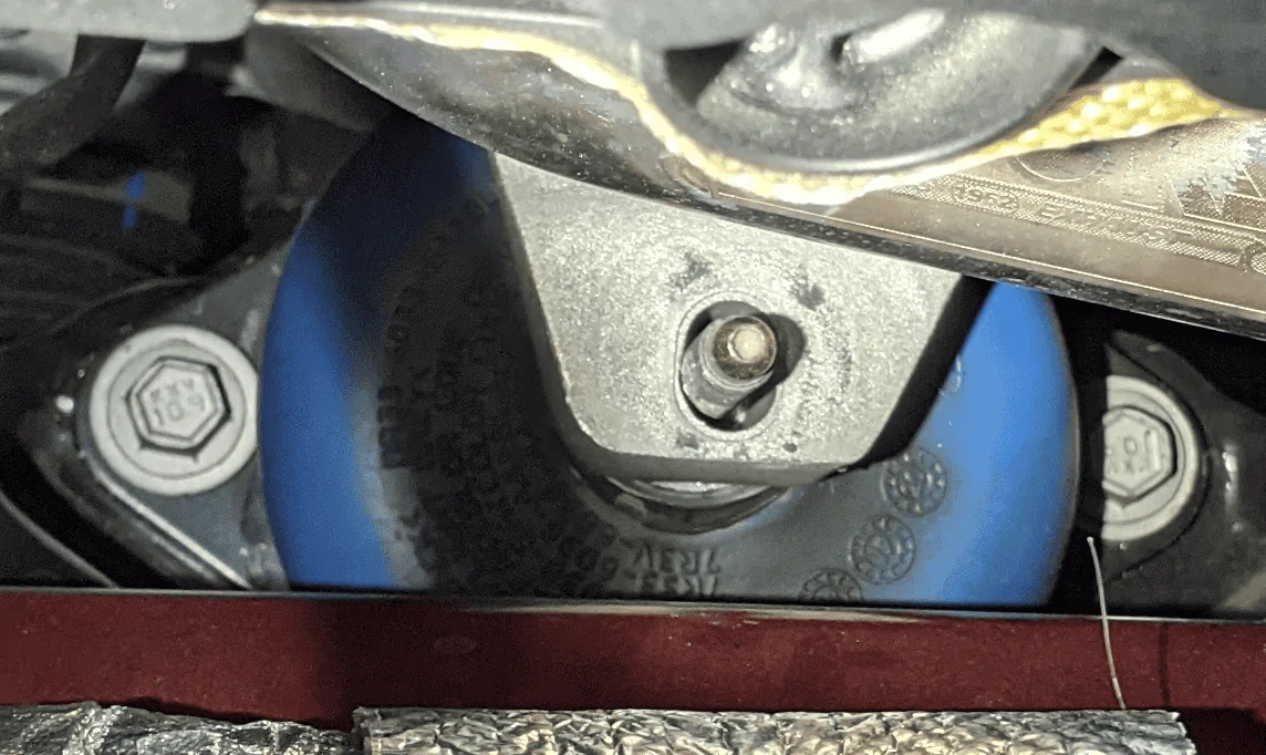

I have a 19 GT350 with 6,000 miles and 9 track days. Today I noticed that my driver's side engine mount had no nut or washer on it!
I replaced it from my supply, using a 2nd lock nut, and checked the passenger side - it was about hand tight!
It is possible that they were removed during the install of my headers and not torqued back down but I thought that I should mention it anyway. The good news is that nothing bad seems to have happened as a result.
Looking closer I see it has been loose or gone for a while as the stud has filed its way into the left (front) of the hole.
