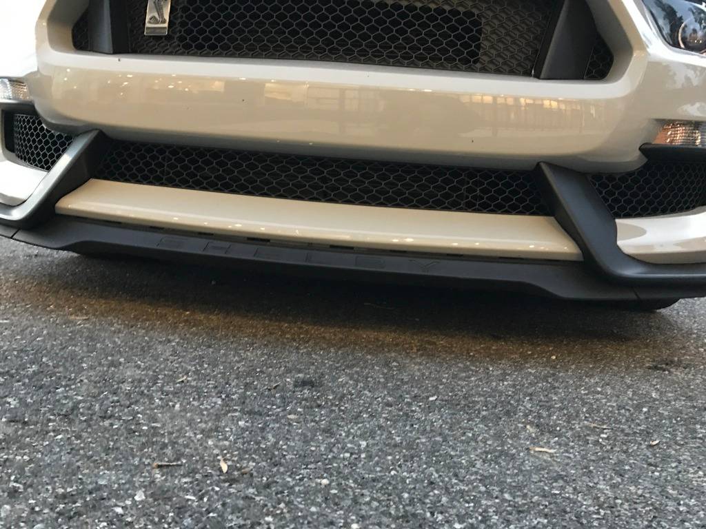

Does it look like it was installed incorrectly?
Nopers. Even if the center tab is in the slot (it doesn't look like it is to me), you shouldn't be able to see the fascia tab holes. In other words, it should be more flush to the fascia lip.
