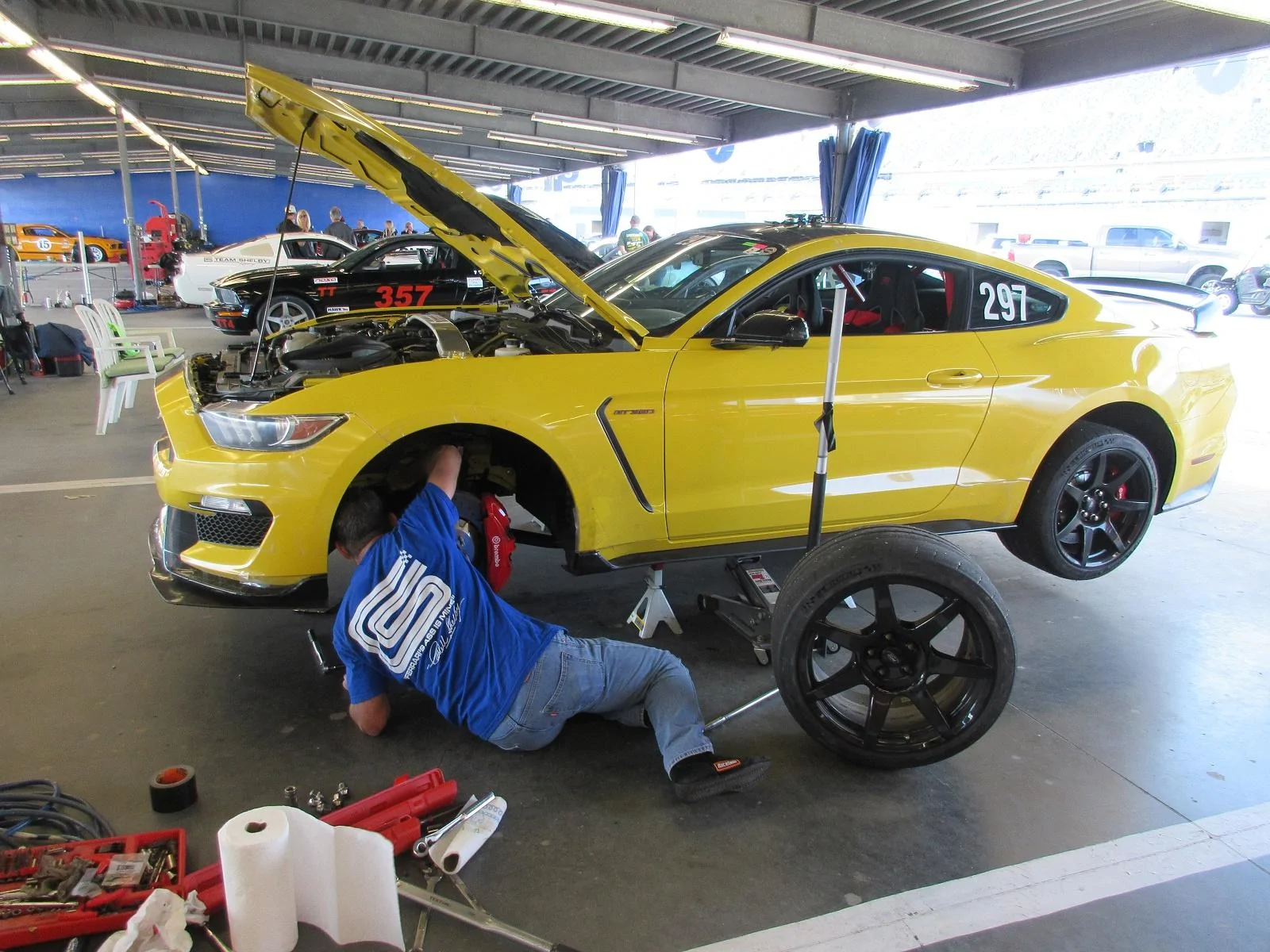

Well...... SOB.... after my third session at Daytona, I noticed oil under my car again. Yes again. This happened last year. One of my pre track inspections was this sensor, to be sure it was tight. It was.
I will be fine. I'm at the dealership letting them fix this problem AGAIN. Anybody who tracks these cars really needs to pay attention to this common problem.
Smh
Ask the service manager if they use a degreaser prior to sensor reinstall on both the sensor and the threads in the block.
Smh
Thanks again Tom for inviting us to your event at Daytona, Very hospitable!
My wife was getting excited about you offering her a ride around Daytona... Damn oil Leak
For those who don't know, Tom is also an Instructor.
Here is the 'Tomster' diagnosing his oil leak at Daytona Fri.

John, it was all buttoned up yesterday and she's running great. The track was a bit slippery today. A Camaro hit the wall and it was totaled. Yesterday an R brethren lost control at the bus stop and took the wall. He is a friend and it hurt me to hear of the news. He loved that car, I did too.
If somehow you can make it back tomorrow, I can make good on that offer for a ride along on one of my sessions tomorrow.

After building dozens of race cars I’m a firm believer in Telflon tape for anything NPT.
I’ve used all sorts of sealants and have had issues in the longterm.
Do what you wish but I’ll never say something on here that I wouldn’t bet my life on.
About to tackle this issue. Ordered the recommended sealent, however, the teflon tape seems like a better option. That ish always works on household plumbing issues :)
I do have experience on the plumbing side being a licensed master plumber. I put Teflon tape and liquid Teflon on top of that for every threaded joint I do. I probably have 10000 plus joints out there just doing dandy at 100+ psi and as high as 180F.
Also 4 trackdays after my leak and fix with Teflon it’s holding solid.
Just as a PSA - here is my favorite teflon tape:
https://www.mcmaster.com/1726n12
Pretty great stuff; has nickel in it to prevent galling. I use it all the time to make up high-pressure (> 1000 psi) connections and it works every time! Also lets you get more torque on the connection to better seal (as said, the nickel helps prevent galling). Of course, you can't go crazy with soft metals (aluminum, brass, etc.).
Only downside is it is a bit thicker, so you have to work harder to get it to lay down on the male threads before making up a connection.
