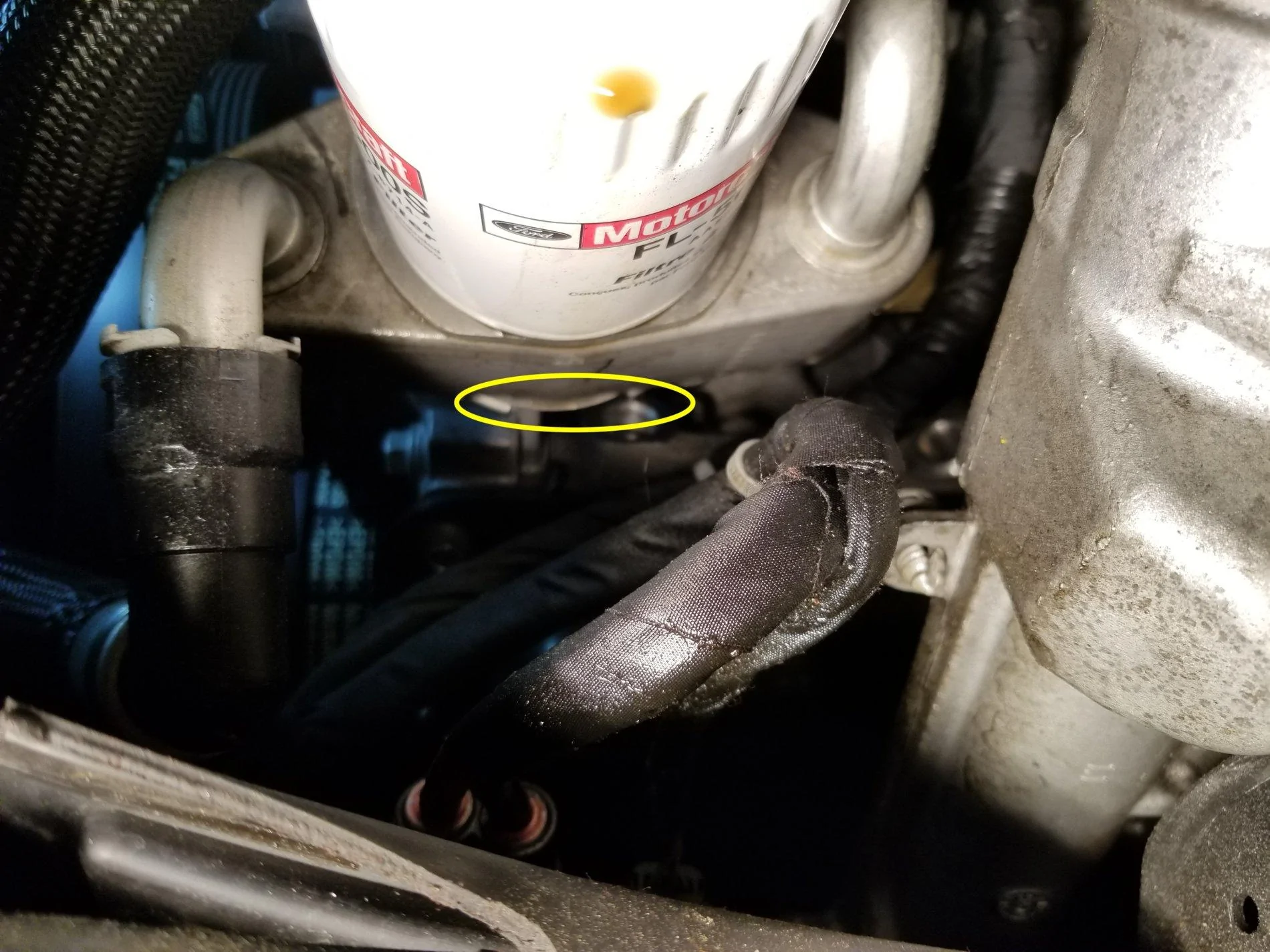

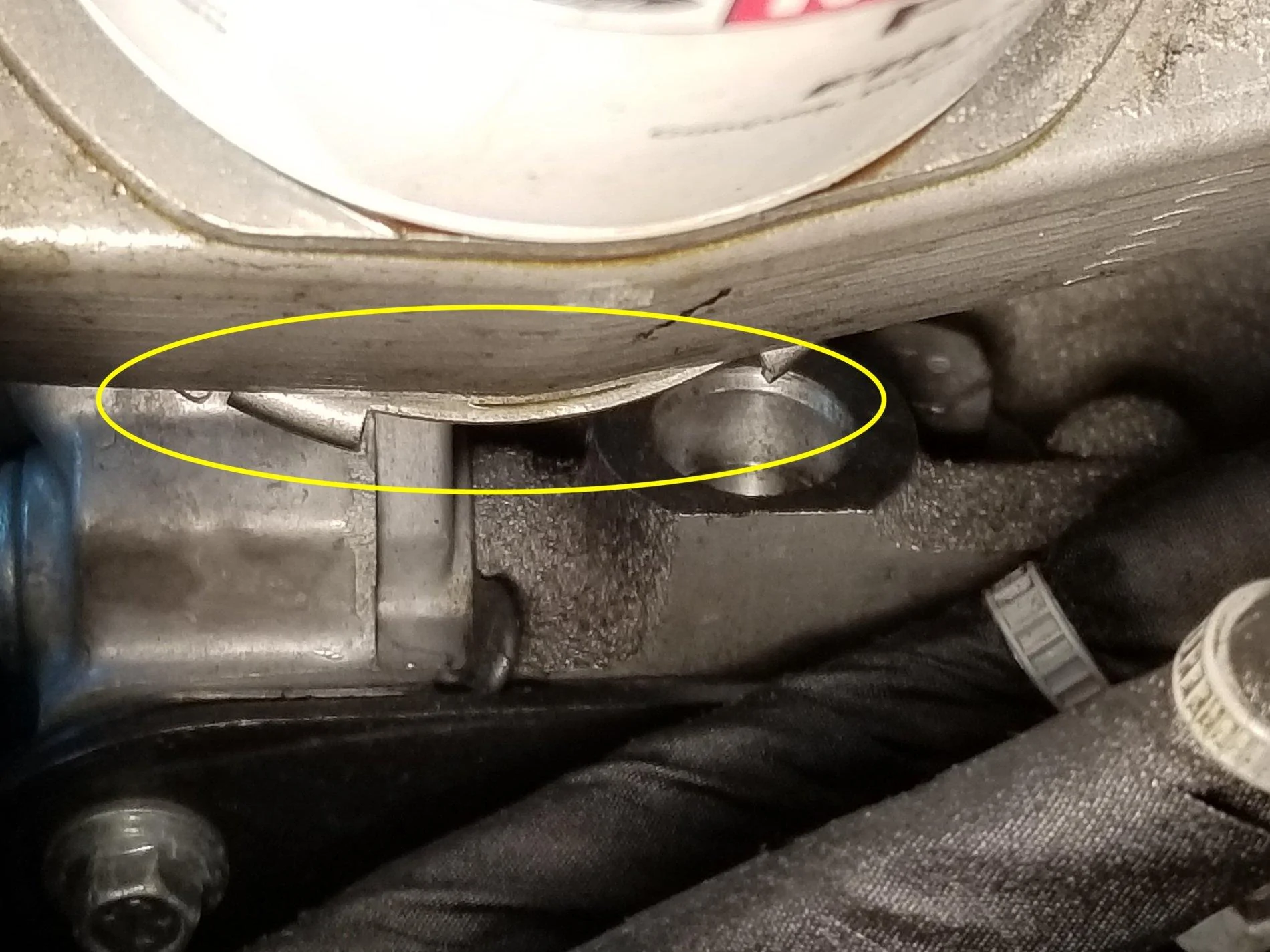

Revising an old thread (car is a 15 PP) - does this look familiar? Seems like oil coming from area where oil filter adapter connects to the cooler
Tank
9/11 - Never Forget
Feb 19, 2016
36
3,065
1,795
Above the Notches
G0853
Kind of difficult to tell by that angle...
Check filter torque.
Check if there’s any c-clips in the area that aren’t fully seated.
Check for any loose sensors that may be in the area.
