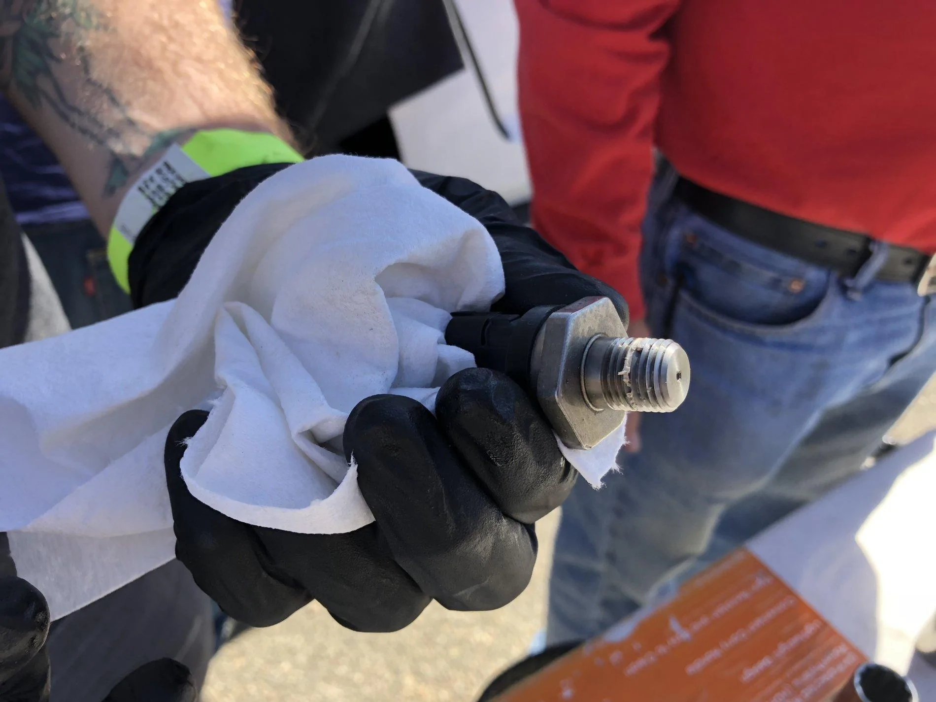

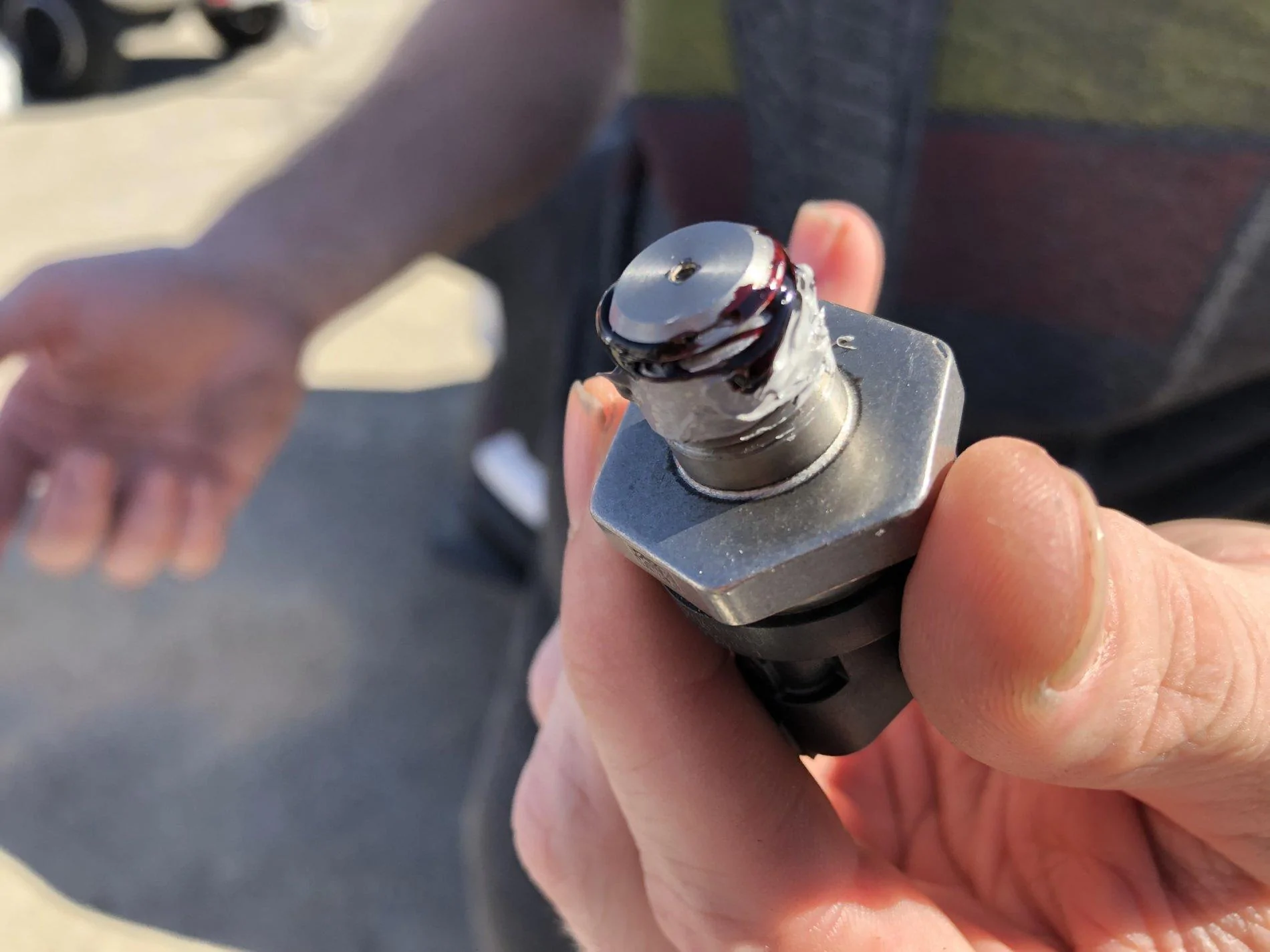

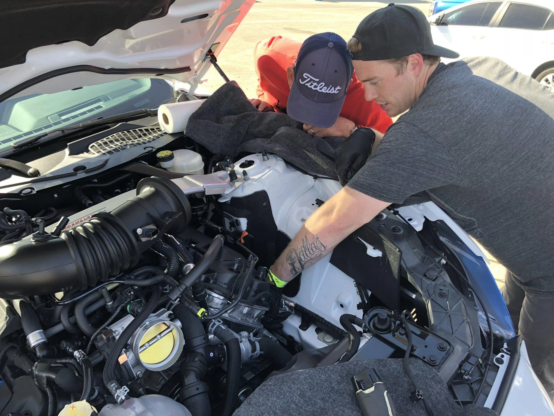

We actually had to replace mine at Willow Springs race track. My car and three others were leaking from the oil sensor unit that weekend. My friends son replaced it in about an hour. He did it from the top by taking the air intake off. Good luck!
