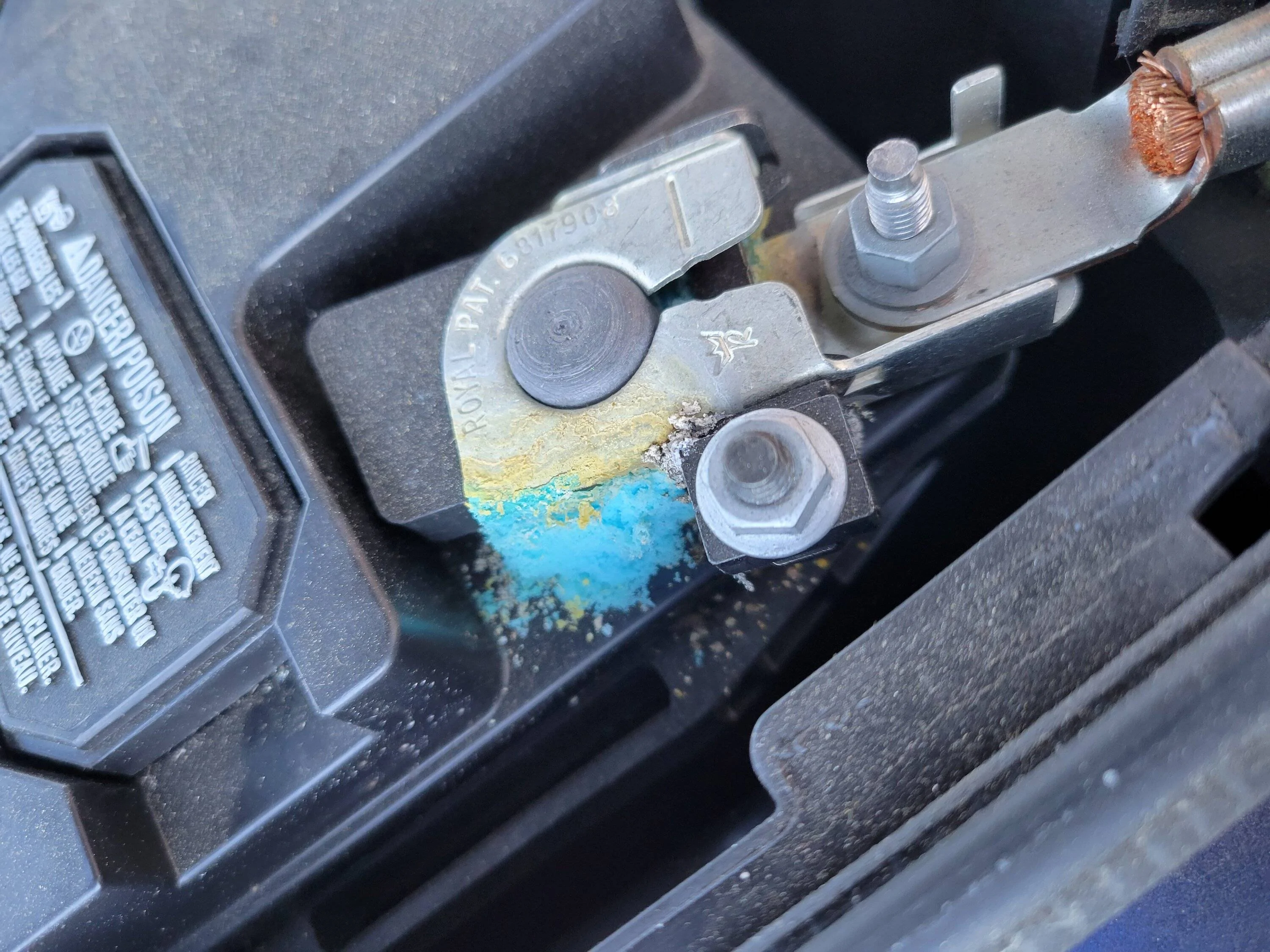

I had to do a bit of cleaning and coating. Probably time for a new battery soon. I used CRC Cleaner With Acid Indicator (and it indicated), and their Terminal Protector. All nice and tidy now. I'd hate for corrosion to get to the cables.
Had the same thing in nearly the same location on mine.
With 3.5yrs on the battery, I replaced it last month. Costco had them for like $110, which these days ain't bad.
Put on new terminals, the only ones that would fit that style were some silly ones from Advance Auto (the ones that are half open), so hopefully they last.
