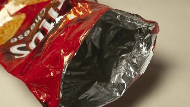

Can’t beat the classics

Agree with Geodudes550, A coffee bag is even better (more durable)
