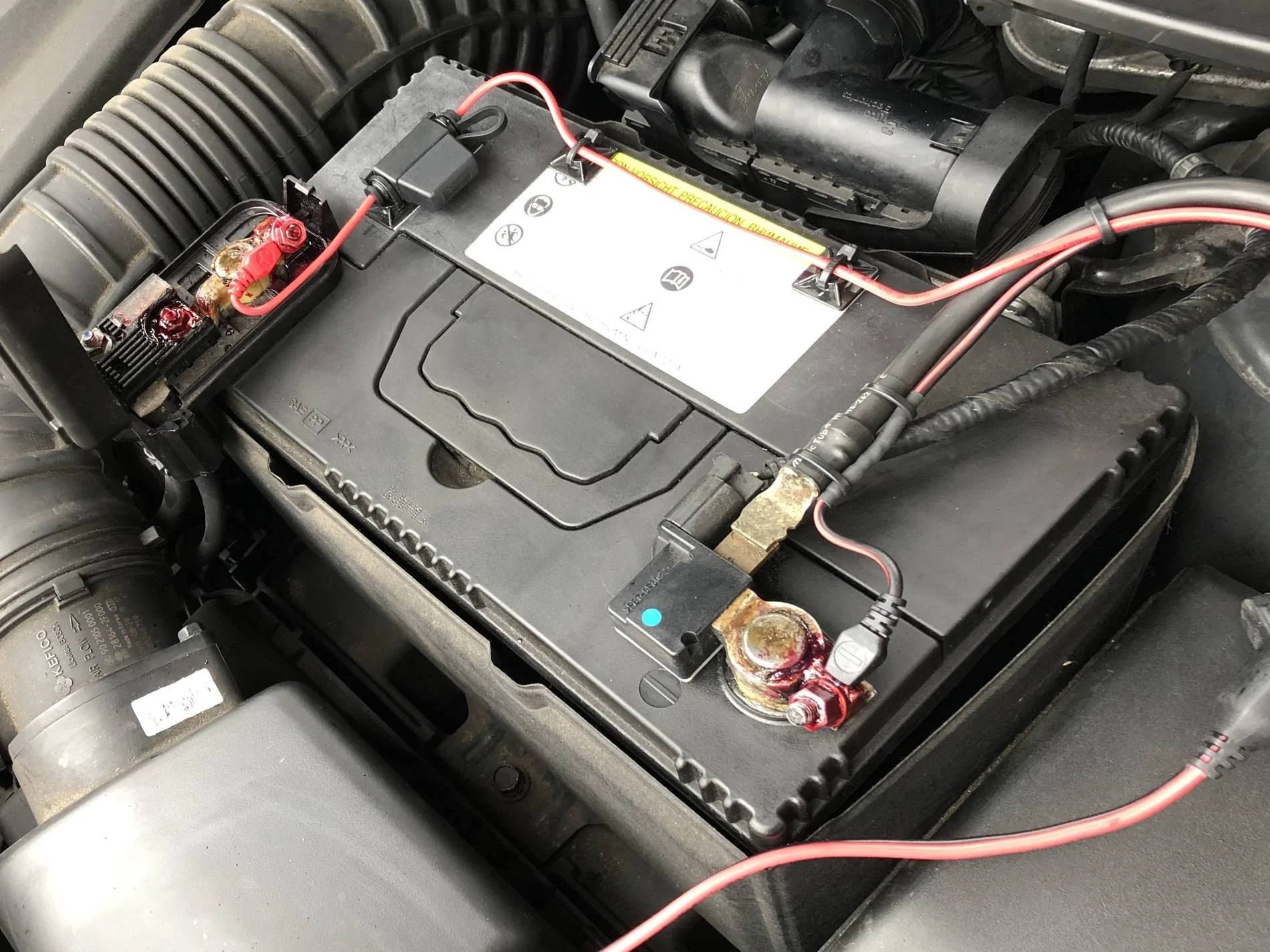

Having said that, so should a well designed, correctly manufactured, correctly operated flooded battery. Here's the one on my Kia that's a month short of its ninth birthday :
WD :like:
