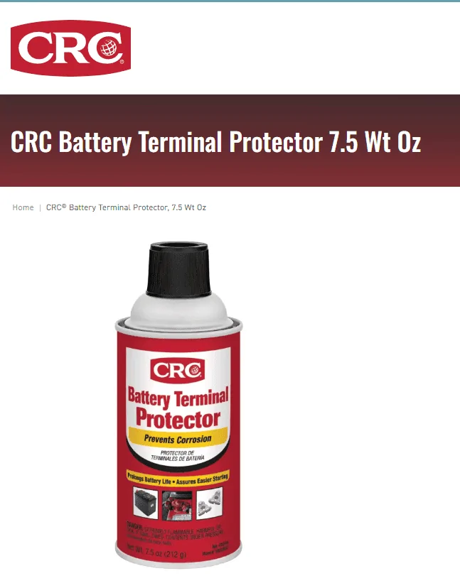

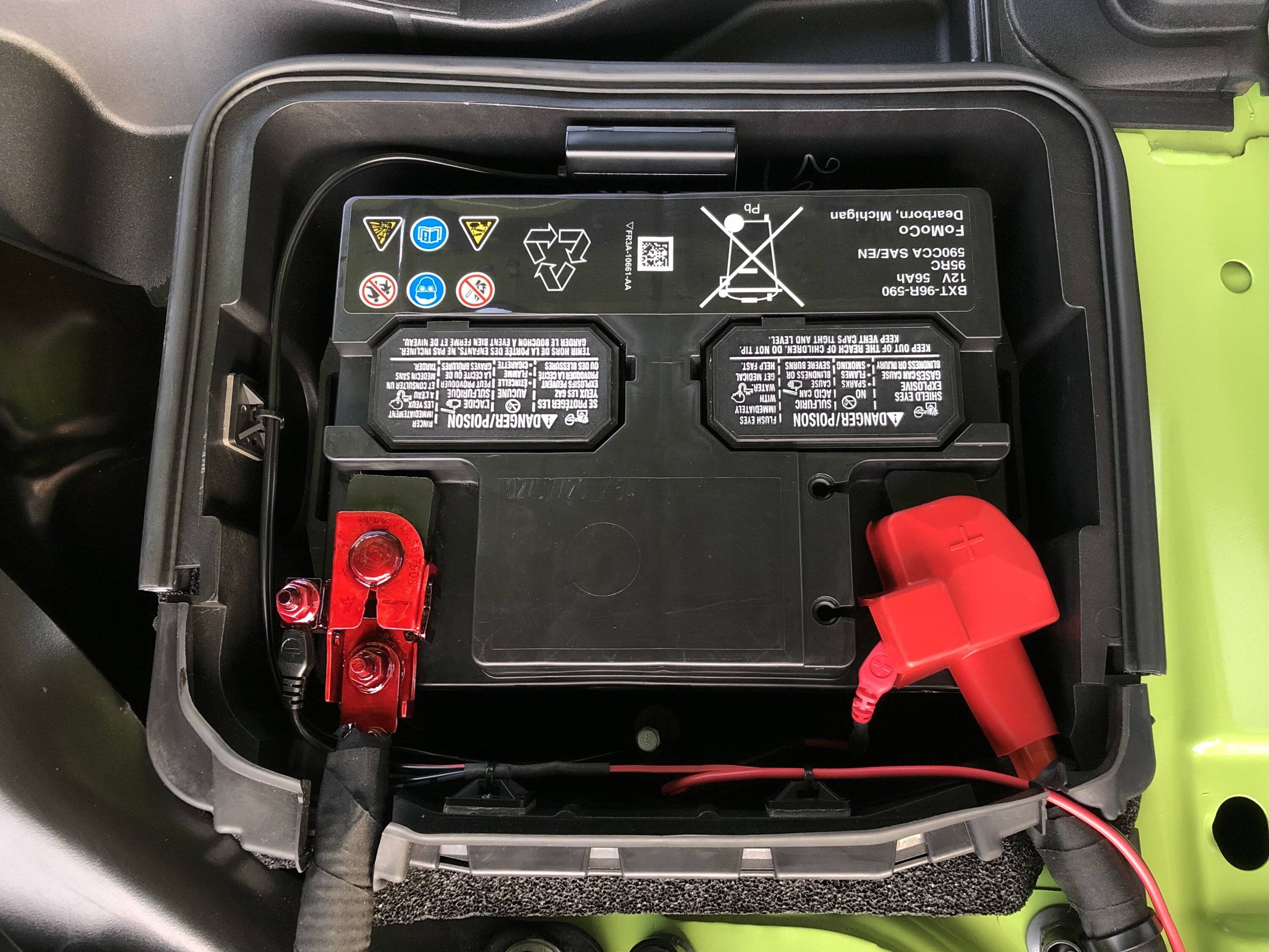

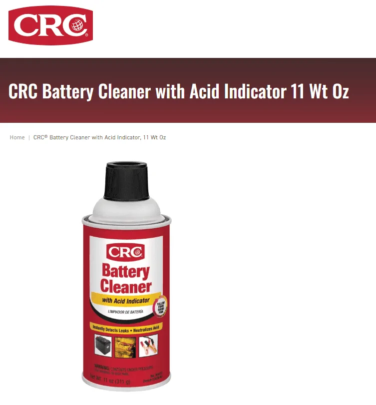

I had to do a bit of cleaning and coating. Probably time for a new battery soon. I used CRC Cleaner With Acid Indicator (and it indicated), and their Terminal Protector. All nice and tidy now. I'd hate for corrosion to get to the cables.

No after pictures?! Unacceptable, lol. I like seeing clean/polished
Seriously though, I’m gonna check mine tonight. Mine is garage kept and stored in the winter so doubtful but doesn’t hurt to peak

Yeah, I should have done that. But I'm not taking that craptacular cover with it's magically disappearing push-pins off again to take an after picture.
Sorry, I should have done that before I buttoned everything up. It's cleaned with a heavy red oily protective coating now.

Good that you caught it early. You shouldn’t have any more problems, especially with the heavy oil
Like you said, good that it didn’t get to the cables. That happened to my daily driven 2001 Escape. Had to replace all that crap.

Products used;
