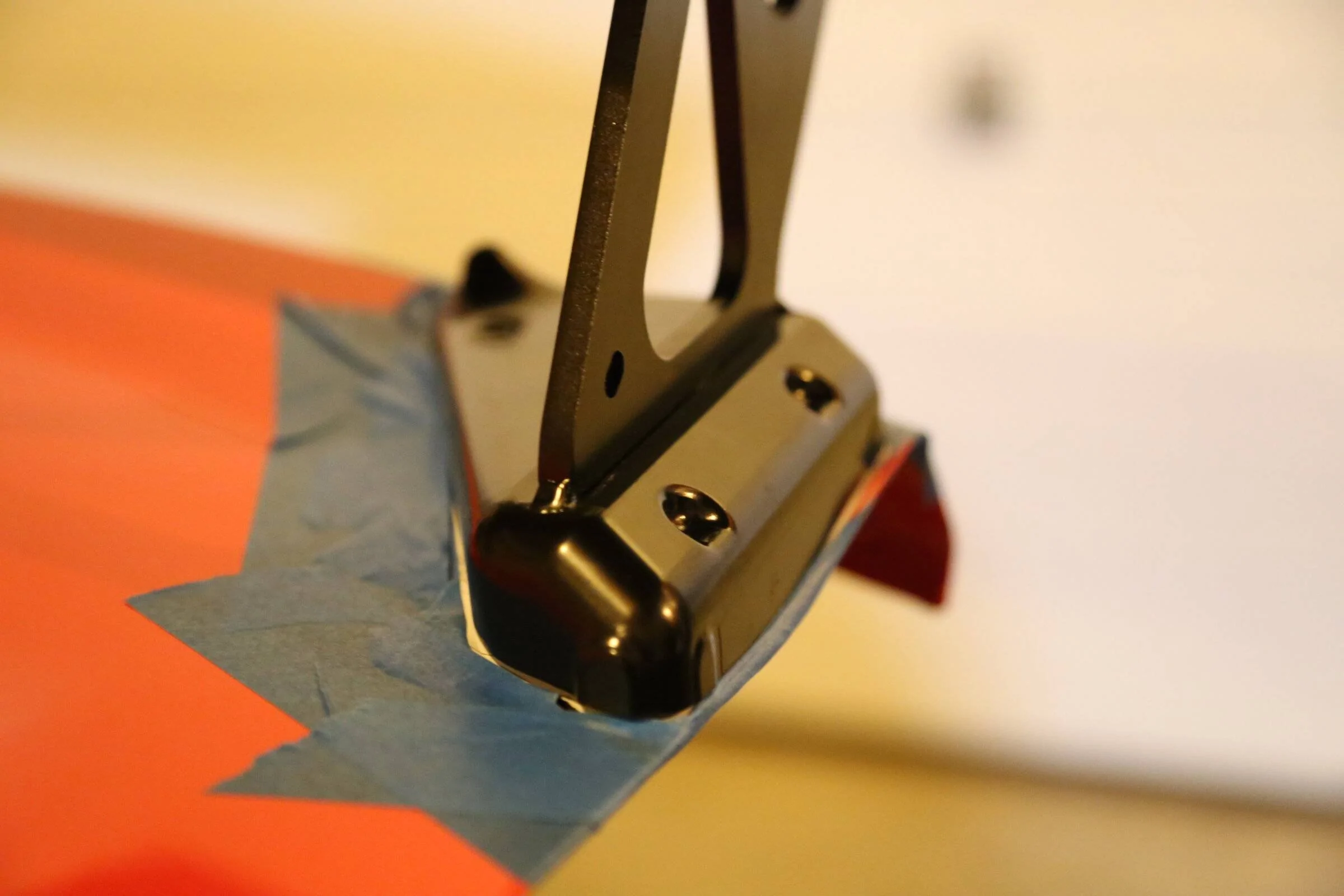

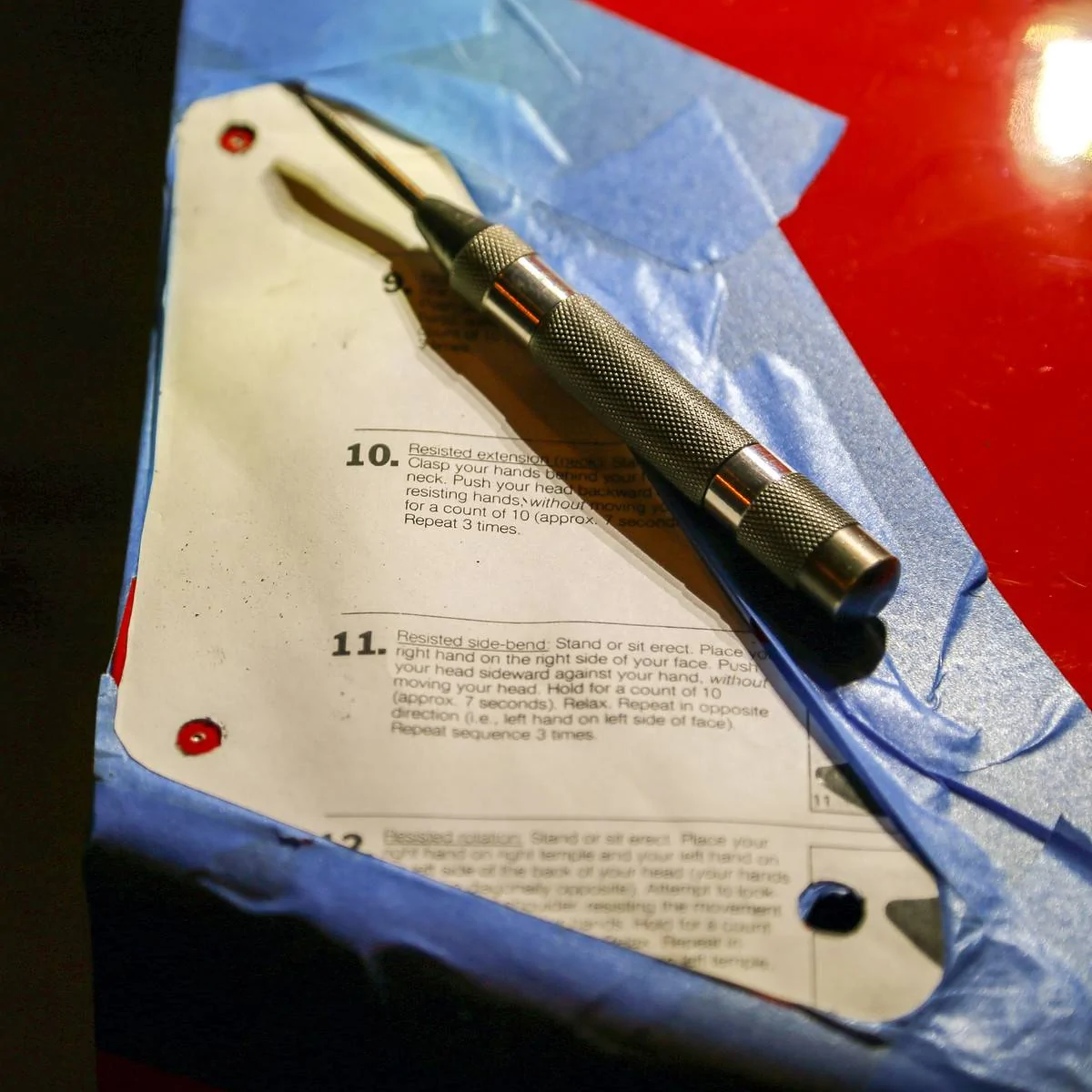

I would not trust a template from anyone.
Trace a template for each side and cut out each one. Bases upside down, place the template on each and carefully trace hole locations.
Install the uprights onto the wing with the bases taped to the templates. Tape some tabs, or extend some tape and fold it over, onto each base. Carefully place the wing assembly into place and when satisfied with location* tape the tabs you made onto the decklid so the templates stay when you lift off the wing/uprights. Punch hole locations, drill, etc.

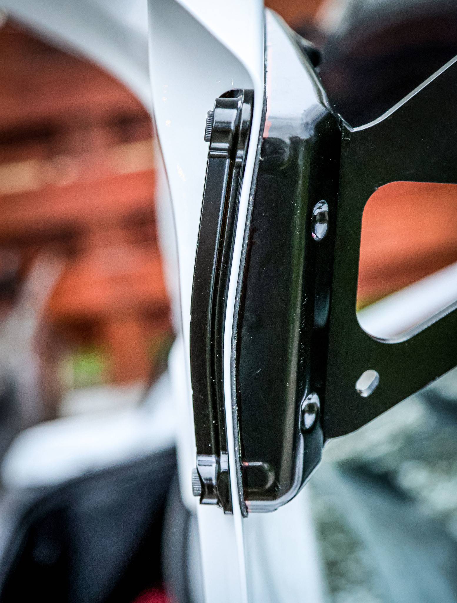

*note - the upright bases are contoured to mate with the decklid best in one spot on each side. To find that sweet spot you have to move the bases until they fit just right. You can tell by viewing from the side. I marked the base location with a grease pencil. You have to then verify that the dogbones will line up as they fit the decklid stamping underneath pretty much only one way. Since you are through drilling, everything has to be in sync. Time consuming but when done properly the wing fits perfectly.

Tape peeled off that attached the template to the base after the extended tabs were taped down to decklid.
Punched centers...
In place on my filled and painted extra decklid.
