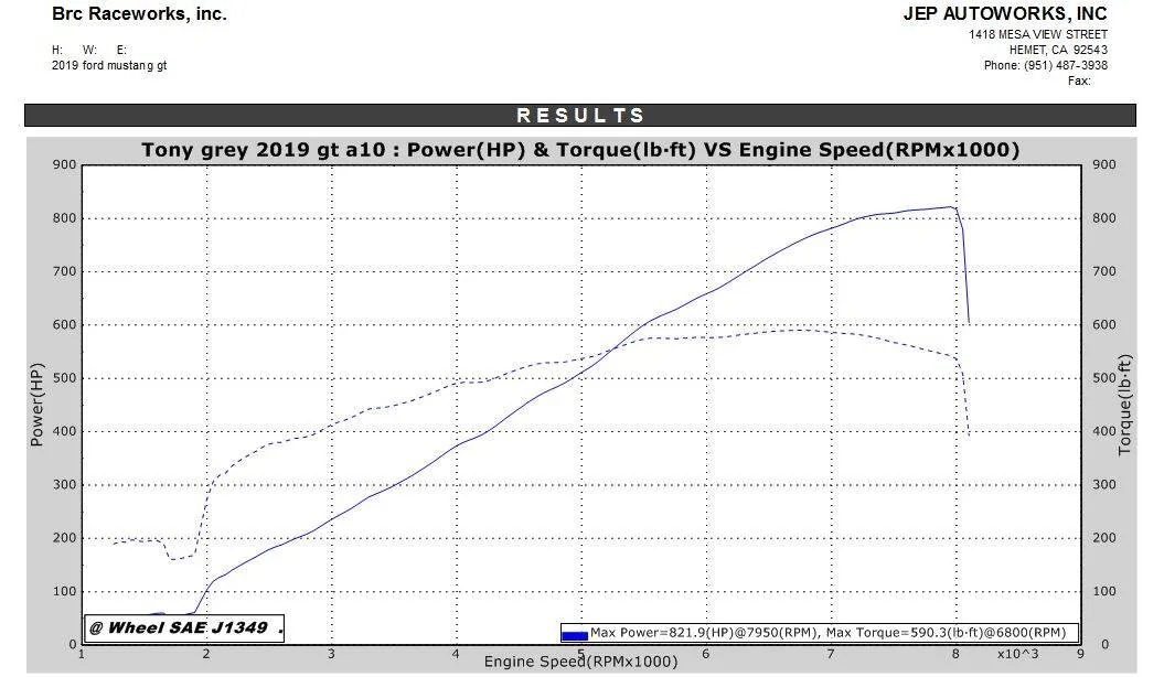

Stg2 d1x . 820/590 it’s enough to annihilate the tires at 60mph. Not once have I thought that I’m down on torque.
Out of interest, at what rpm are you hitting the torque peak?
