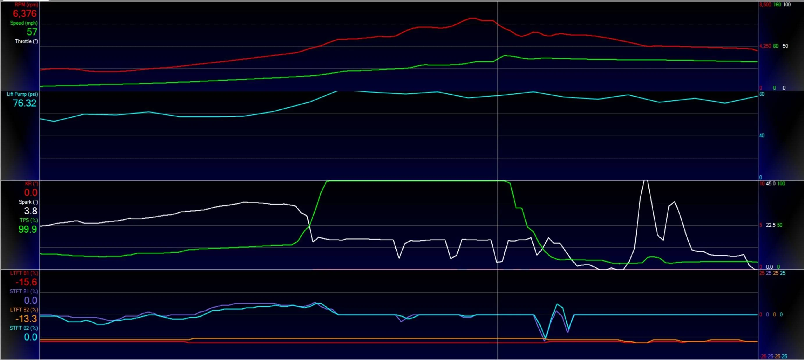

@2022 Mach 1 ya, in the logs it looks like it’s cutting spark down to almost nothing.
This is a second gear pull and you can see where it pulls way back on spark. I also noticed in those areas, Torque Source switches from Traction Control to TQ Based Decel, then back to driver demand and then the proses repeats.
I’ve definitely sent a few logs over to the tuner and am waiting to hear back on what he can do. Glad to hear it may be something that can tuned out a bit more because as of right now, I am really hating driving the car compared to how it was.

Try going into track mode and toggling TCS off. Should still have advancetrac but should not cut power unless too sidways. Atleast this works for me.

Try going into track mode and toggling TCS off. Should still have advancetrac but should not cut power. Atleast this works for me.
Ya that definitely keeps it from cutting out like this. It will still cut out from time to time, probably as it starts going too sideways, but not anywhere near as bad.
