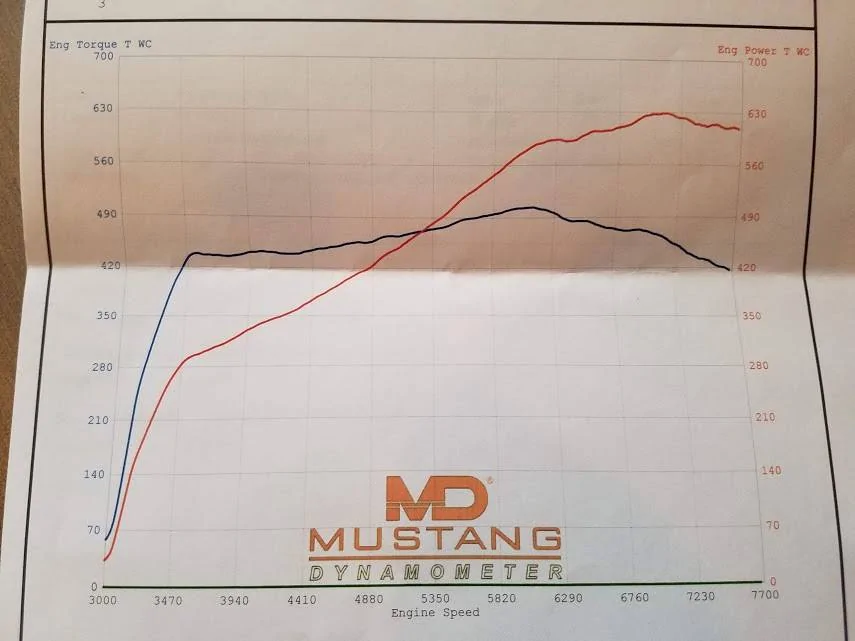

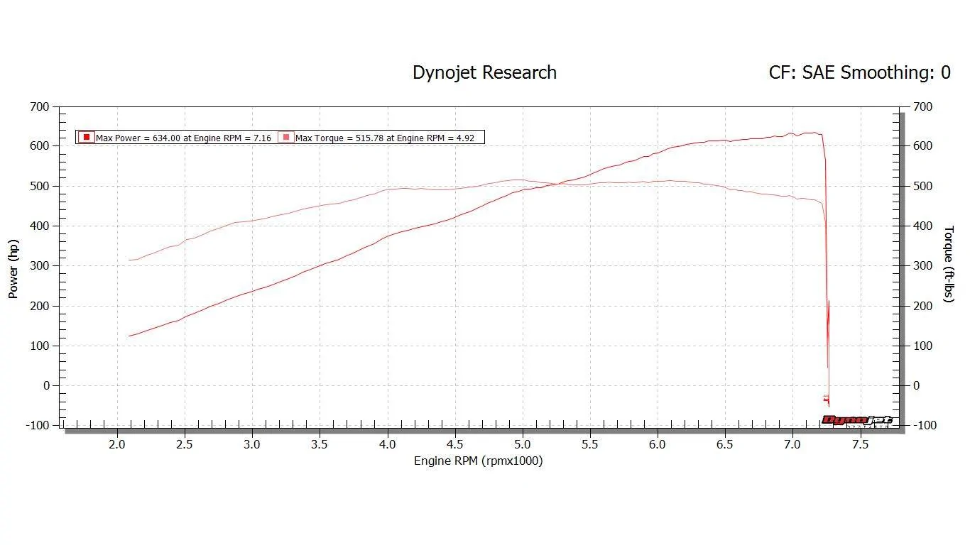

I am familiar with the "torque boosters" that are available for the Paxton/Vortech set ups and I understand how they work and see the benefits, albeit with an increase in inlet temp.
Would like to know if in fact anyone has a dyno graph before and after on Paxton/Vortech/Procharger on the low end of the RPM scale, with our without a torque booster.
