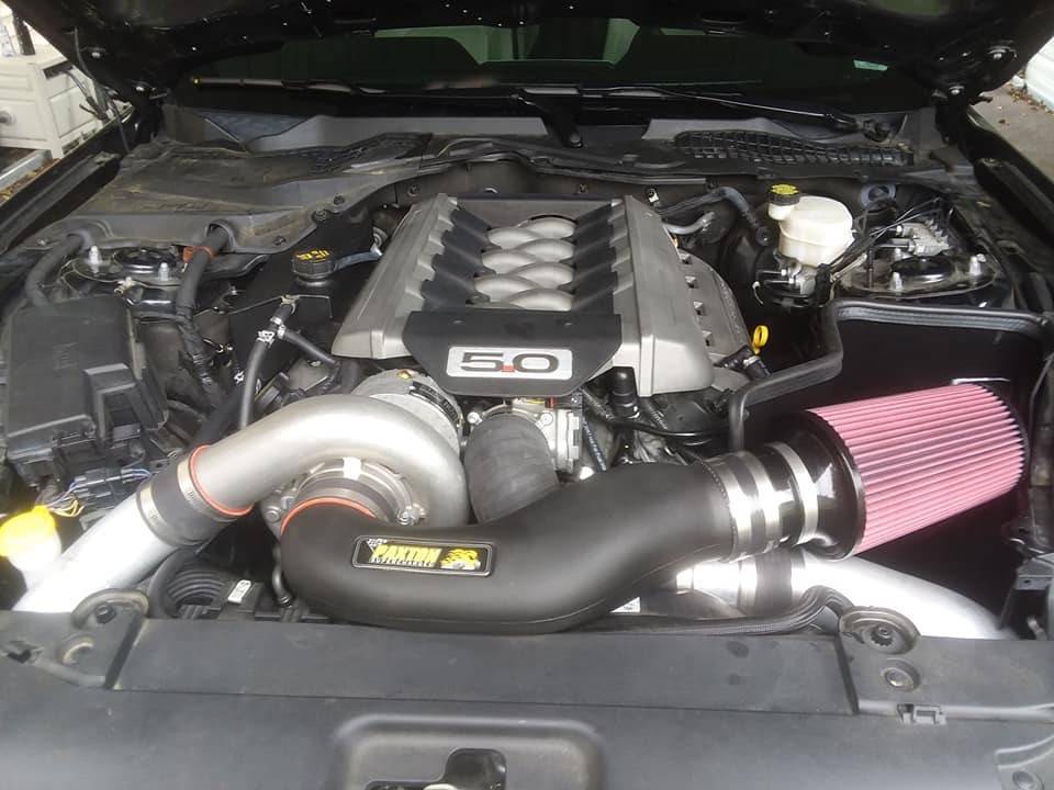

I have a Paxton On my car. It put a full weight loaded premium with a 270 pd. driver in the 9s. (I think it’s got a little more left in it.) A Paxton would be plenty for your goal of 700-750. You should see close to 700 with a good intake & full exhaust. Add e85 and your in the 750-775 range.The one thing I second guess about the Paxton is where the overflow is mounted. It’s right on top of the spark plugs on the passenger side. Making them a PITA to change out vs the pro charger mounting set up.

You should be good then. Paxton/Vortech head units cannot operate under 25 degrees without an engine block heater. They quote this right in their warranty terms.

The kit design is not as good. You need to cut and move a few things, plus the procharger has its own bracket for the pulley (I believe) making swaps simpler. Procharger also has the option for a quieter head into nowadays and the procharger upgraded intercooler is way more efficient than what comes on the Paxton and Vortech setups.

I'm willing to give it a try. Weld in a WG flange and have a block off flange made just in case. Mount the BOV from the Pro-Charger kit but leave the vac line off for an initial dyno run/tune. If the WG is a flop, blocking it off would only take a few minutes, then hook up the vac line and tune with the BOV.
Only out the WG and welding if it flops. Nothing ventured nothing gained. Folks running the WG on the Paxton/Vortech set ups seem to recommend it, as long as it is set up properly from the get go.
That's because paxton/vortech need it.
