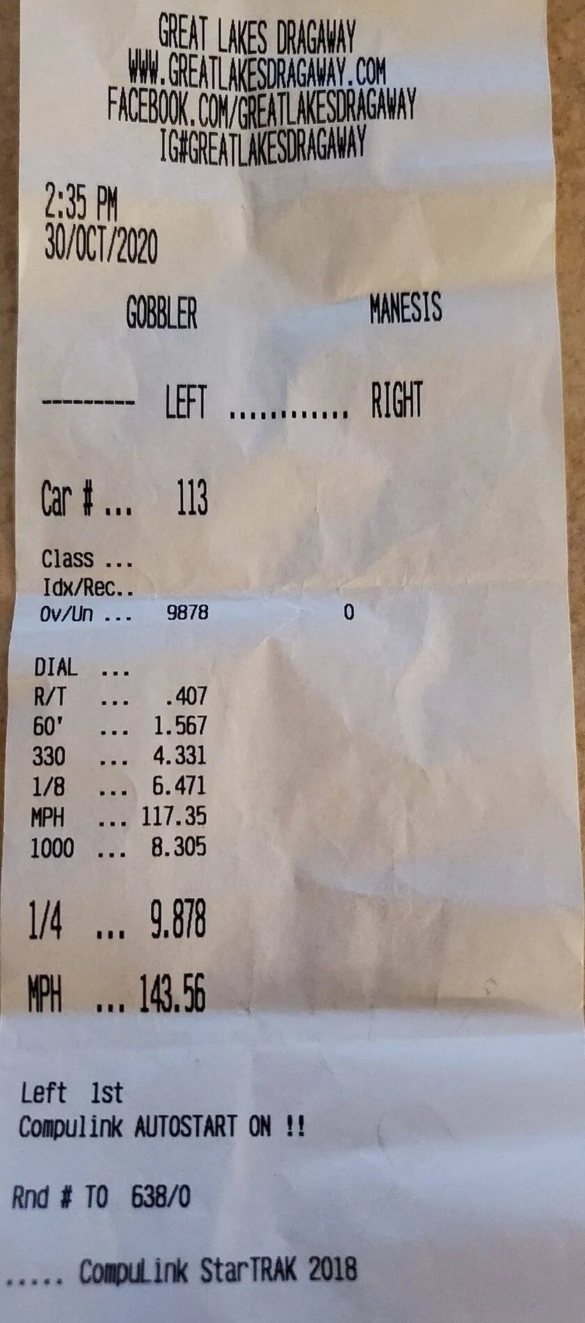

I did my own version of the "Torque Booster" and saw gains in the midrange similar to what Beef saw. I have it setup with a 2 port solenoid and switch for a "Low" setting that nets around 8lbs and a "High" setting that nets ~12.5lbs of boost. It's a street/show/strip car so, it's nice to run 93 with low boost on the street and at the track, switch to the e85 tune with high boost and full send.
V3-JT, 3.33 pulley, LTH, E85, Drag Pack, A10, Stock Verter and drivetrain, 3.55, Full Weight 401a
I'm happy with the results
