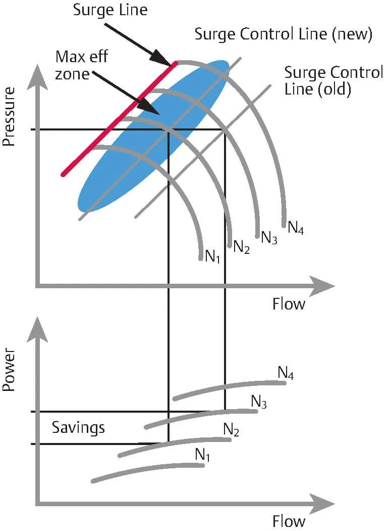

You do realize that the air vented through a “wastegate” is actually compressed first right? You’re paying the horsepower tax for the wasted air when it passes through the compressor and is pressurized. It’s over 200 deg due to being compressed to the 10 psi. It will maintain the same 200 deg when it exits the “wastegate”.
But just for arguments sake let’s say you’re right since a pro chargers parasitic lost at 10 pounds of boost is 7-8% let’s add 30% and now we are at a whopping 2% more loss But a gain of 10% more power. What is the problem?
It takes 100-150 hp to drive a compressor making 10 psi boost at 80 lb/min. Increasing flow 30% to account for a “wastegate” will require at least an extra 30-40 hp to drive, more if it falls to a lower efficiency (likely). You can see it in the graph you posted because when making the same boost, the non-wastegated combo makes more power from the same boost.
The attached curves (credit: Emerson Automation) demonstrate exactly what’s going on. [It’s almost eery how well the example graph fits our situation.]
Curves N2 represent a conventional setup without a wastegate. N3 is spinning faster but the control point is at the same pressure. The bottom graph shows that N3 takes more power to turn even at the same pressure. Also note that as you reduce discharge pressure the compressor drive power actually goes up not down as you might expect. This is due to rising mass flow and rapidly dropping efficiency.

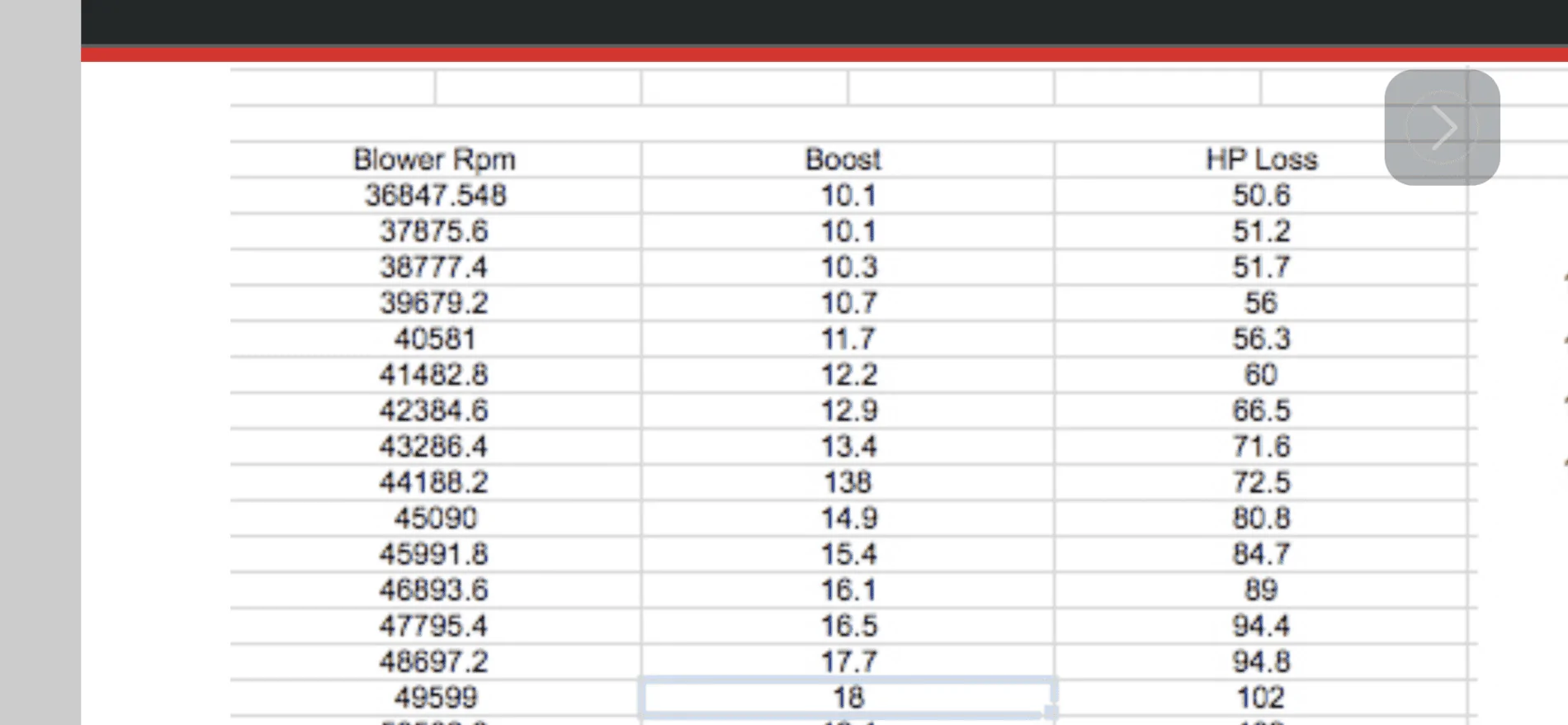

this is a test done by dragzine on procharger. To find out what amount of hp is lost at a given boost. It is way less than the 100-150 you Suggested
https://www.dragzine.com/news/lose-power-to-make-power-procharger-parasitic-loss-testing/
It’s rather convenient that they left the mass flow out of that test. You can’t compare the compressor drive power if you don’t know the flow rate, as I’ve stated many times before! I can assure you that procharger isn’t breaking any laws of thermodynamics.
